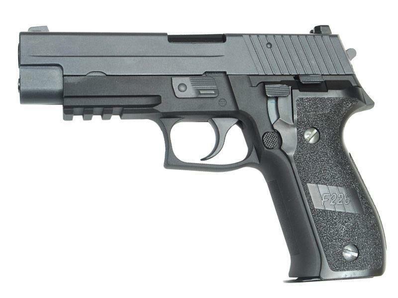

Currently play only with an AEG but fancy giving a pistol a go, mostly play woodland skirmish and the occasional indoor CQB.  Realise a pistol won't have the range or accuracy of a 350fps AEG (or the BB capacity) but it looks it might be fun to use a pistol as a secondary toy, maybe more of a challenge than a point and shoot AEG?
My main AEG is a MP5K with a MP5 as a back up so I have had 80's/90's special forces load out in my head while looking at pistols and I have come across the WE version of the Sig F226 MK25 which I am quite taken by.  I like the white dots on the sights for easy aiming in the gloom of indoor CQB.  I thought the sights on similar Glocks / Hi Cappas were a bit small and would be hard to use indoors and with fairly big hands I found the really flared magwells of some pistols ment they were more challenging to hold.  The WE Sig it feels like a solid pistol in the hand, nothing showey about it, it just works, rail for a torch or laser, very special forces.
I have watched the YouTube vids and read the reviews but are they any good?
Any general comments on WE pistols before I take the plunge? Understand they are one of the better brands?
I will be buying from my local shop (who don't have a website) but its the same as the one below.
https://www.bespokeairsoft.co.uk/we-mk25-gas-blowback-pistol-black

A minor point is there were 2 rail variants (afaik based on rs but thats citation needed) one with a curved rail and one with the more standard square rail (as you have pictured). I had the latter and some holsters moulded for the former are a tight fit until they get bedded in but at least it fits standard accessories more readily.

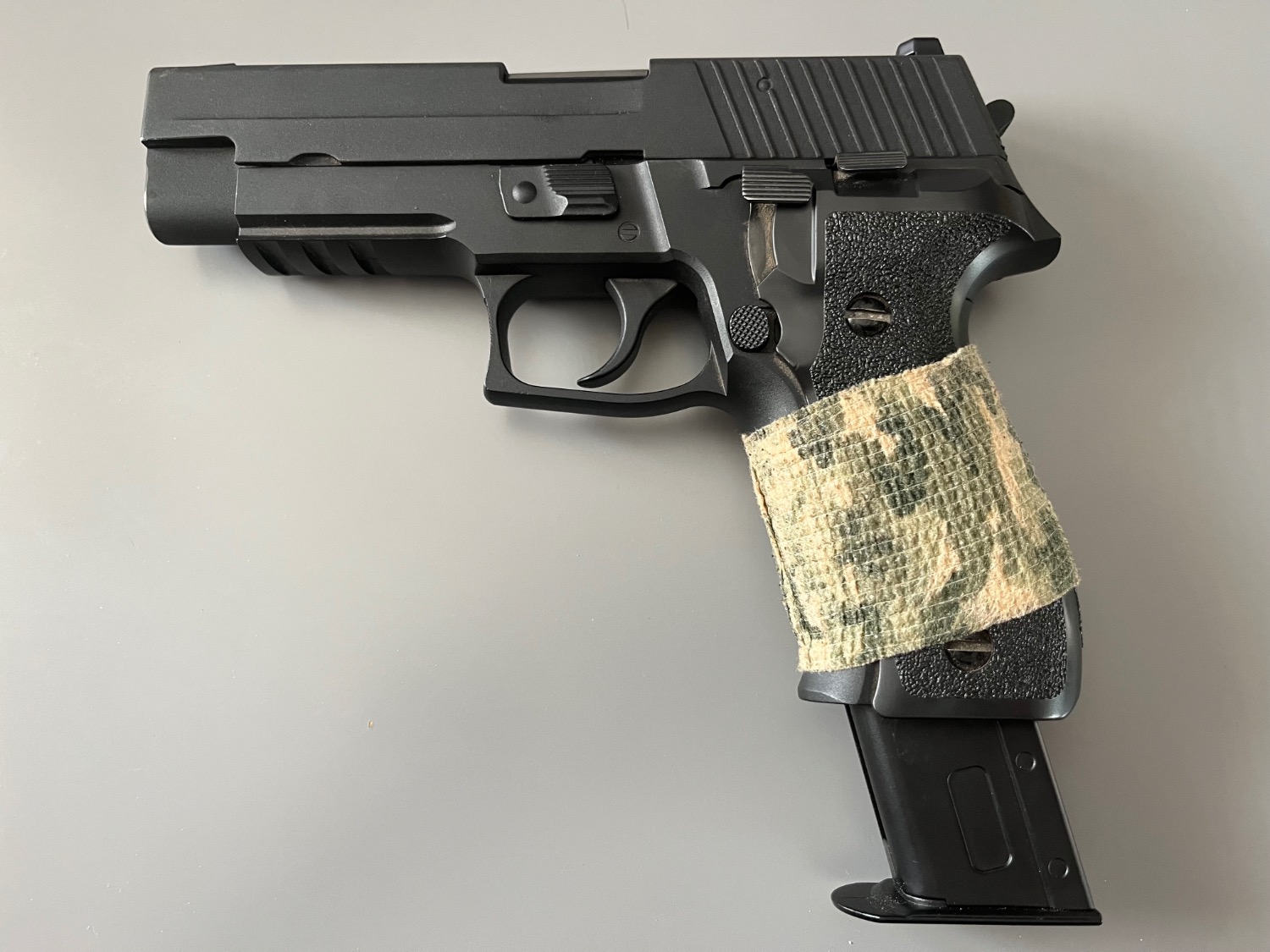

I know the advice was to buy the TM gun but I ended up going with the WE, the weight and balance of the gun was just right and the supplying shop is only 10 mins away if it goes wrong, sorry and genuine thanks to everyone for their time in giving me guidance.
Also picked up a couple of 30 round (extended) mags, to my eye the 40 round (extended) mags were just a bit much and standard 24 round were a bit normal.  Managed to get a full mag and a full reload before running out of gas on both the standard and extended mags which I was quite happy with as I just took a small speed loader out in my pocket to double my ammo capacity.
Tape is just there to help me recognise /recover it if it gets lost on a game day.
Gun shot well on Sunday, 255fps on .28's which it shot straight and true.  Me on the other hand needs more practice with a pistol before any level of accuracy can be determined.
