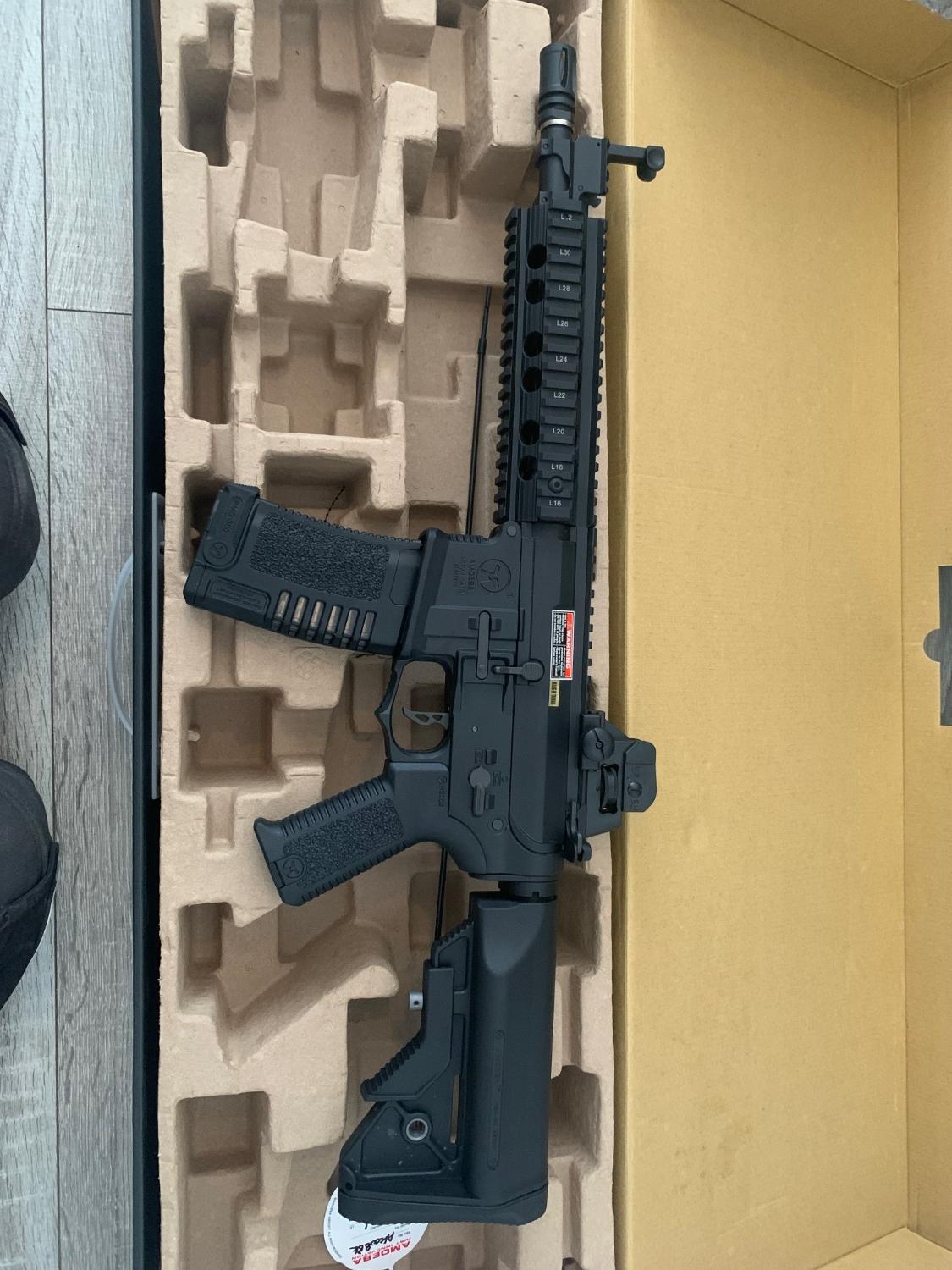

Krusty Posted May 14 Share Posted May 14 (edited) Hi guys, I am new to airsoft and have bought myself my first gun. I have purchased an ARES Amoeba AM-008 and I am looking for some advice on what I need to get before I take it out for the first time. The gun didn’t turn up with a battery and looking online I think that a Nuprol 2600mAh 11.1v LIPO Twin Stick - Mini Tamiya may be my best option. i will also need to obtain a charger for this. I would like to know what I can use on this gun and will make a list below of stuff I would like to get but do not know what is compatible. optic - red dot/holographic foregrip tracer silencer sling & hook spare mags battery & charger flashlight sorry if this was a long winded post I am just lost and looking for advice on what I can do to maximise my new weapon. thankyou in advance Edited May 14 by Krusty Link to comment Share on other sites More sharing options...
