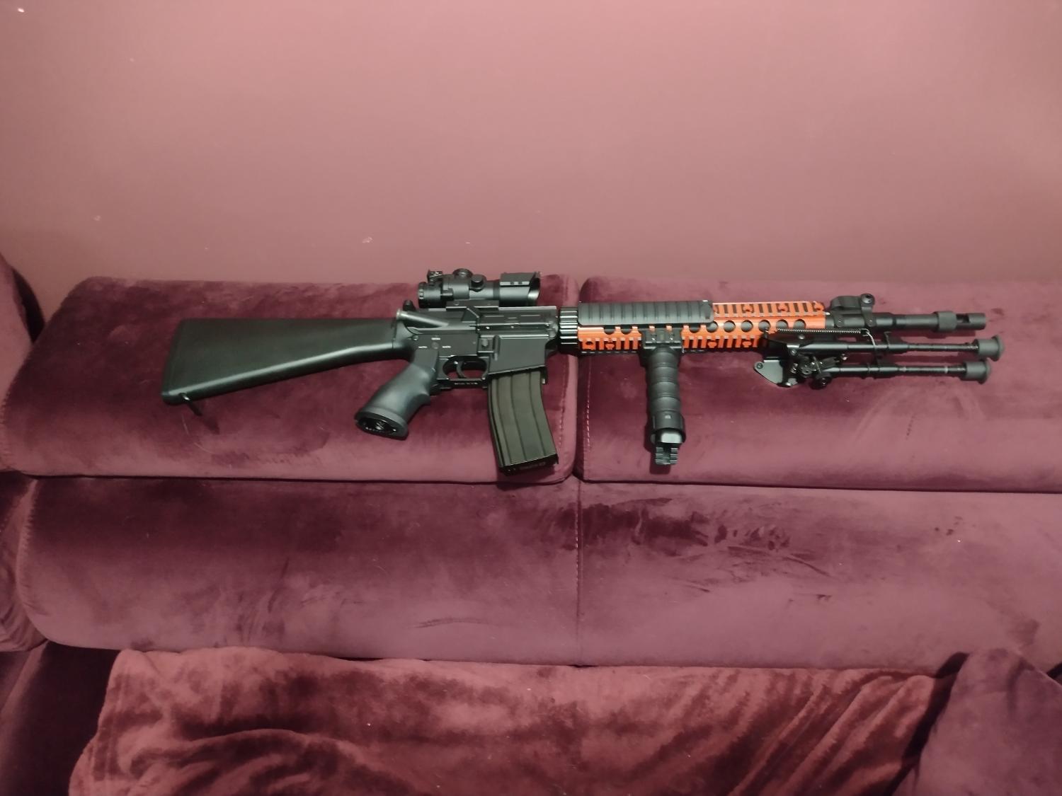

MrPerforations Posted March 1 Share Posted March 1 (edited) Hello's Forum, i have a double bell MK12 SPR mod1 as it was cheap and all metal. i am new to the hobby and have decided to work on it as a fun project as i want to keep the collect down to one gun. its to be used as a longer barrel assault rifle as i get aroused by m16's. so far i managed to get 13:1 gears and a 39k brushless motor as mechanical upgrades, but i have been lead to believe that this combination would be to fast, would that be correct please? yesterday i discovered that they also do a newer set of gears with the sector gear delayer in a different place. as i have a longer barrel 470mm in my gun, do you think getting a new set of gears is a good idea please? the next question is what gear ratio should i go for with the 39k brushless motor please? i can exchange for a slower 33k speed, should i keep the motor and change gears to suit it or change the motor to suit gears please? i have also brought new bearing as the one it look mashed up and a Prometheus 50-60 bucking and nub. also , if i become a member of a airsoft sites UKARA, can i then paint my gun in funky camo please? i have already brought paint, stencils and masking film for this project. best regards, MrPerforations. Edited March 1 by MrPerforations add writting Link to comment Share on other sites More sharing options...
