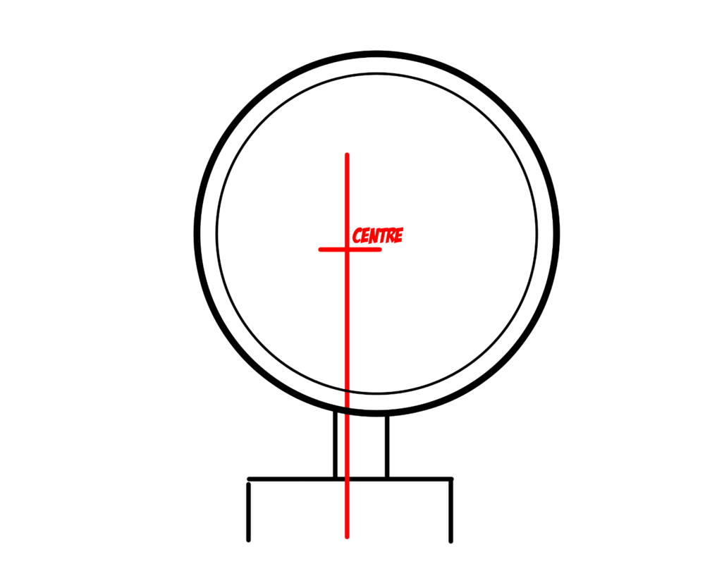

RedWolfDoctor Posted yesterday at 11:39 Share Posted yesterday at 11:39 Howdy, shooters So, I have a conundrum: my red dot sights. I have some cheap Eotechs, a Theta Optics Monolith red dot sight and a Valken V tactical red dot. The running theme between all of them is that they are all off-centre because of structural flaws that are built into the scopes themselves. When mounted the scopes are either shifted too much to the left or too the right, no matter which way they are mounted. This is getting annoying since it makes zeroing the gun and aiming a chore more than it should be. I guess it serves me right for buying cheap red dots. Anyone know of any brands that are actually properly made so the scope sits on the centre instead of being shifted right or left? Link to comment Share on other sites More sharing options...

Tommikka Posted yesterday at 13:33 Share Posted yesterday at 13:33 In addition to the common physical factor being your rail, have you also considered the effect of parralex error from your head/eye position? A little ‘adjustment’ can be made to your rail - permanently by filing down an edge or less permanently by slipping in some paper or card on one side to shift the sights relative position when mounting. There isn’t too much that can be done about parralex error, but extra layers of rails or an offset rail can move the sight to what may be a ‘better’ position Link to comment Share on other sites More sharing options...

RedWolfDoctor Posted 23 hours ago Author Share Posted 23 hours ago 9 hours ago, JimFromHorsham said: Is it the scopes or the chinesium Picatinny rails on the guns themselves ? Definitely the scopes, the rails line up with the original gun-sights themselves. 8 hours ago, Tommikka said: In addition to the common physical factor being your rail, have you also considered the effect of parralex error from your head/eye position? A little ‘adjustment’ can be made to your rail - permanently by filing down an edge or less permanently by slipping in some paper or card on one side to shift the sights relative position when mounting. There isn’t too much that can be done about parralex error, but extra layers of rails or an offset rail can move the sight to what may be a ‘better’ position I guess parallax problems do occur because when I shoulder it, the reticule changes from "zeroed" to "not-zeroed" depending on the mounting. Sometimes I mount it, discover it works fine, then stare down the sight again to discover it's "off". Already tried an extra rail set, I use a larger mount for the sight to see over a PEQ box. Even with accounting for both, the sight is still off-centre. Link to comment Share on other sites More sharing options...
Supporters Lozart Posted 12 hours ago Supporters Share Posted 12 hours ago 11 hours ago, RedWolfDoctor said: I guess parallax problems do occur because when I shoulder it, the reticule changes from "zeroed" to "not-zeroed" depending on the mounting. Sometimes I mount it, discover it works fine, then stare down the sight again to discover it's "off". Already tried an extra rail set, I use a larger mount for the sight to see over a PEQ box. Even with accounting for both, the sight is still off-centre. Hang on - are you zeroing the scope off the gun then mounting it and it's no longer central? Link to comment Share on other sites More sharing options...
Cannonfodder Posted 10 hours ago Share Posted 10 hours ago If you're removing the sight then changing the mounts then you're going to need to rezero the sight. Lozart 1 Link to comment Share on other sites More sharing options...
