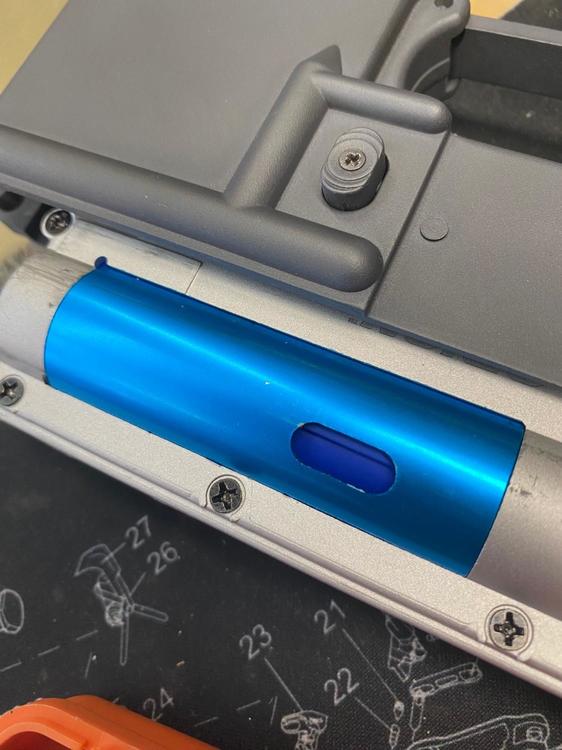

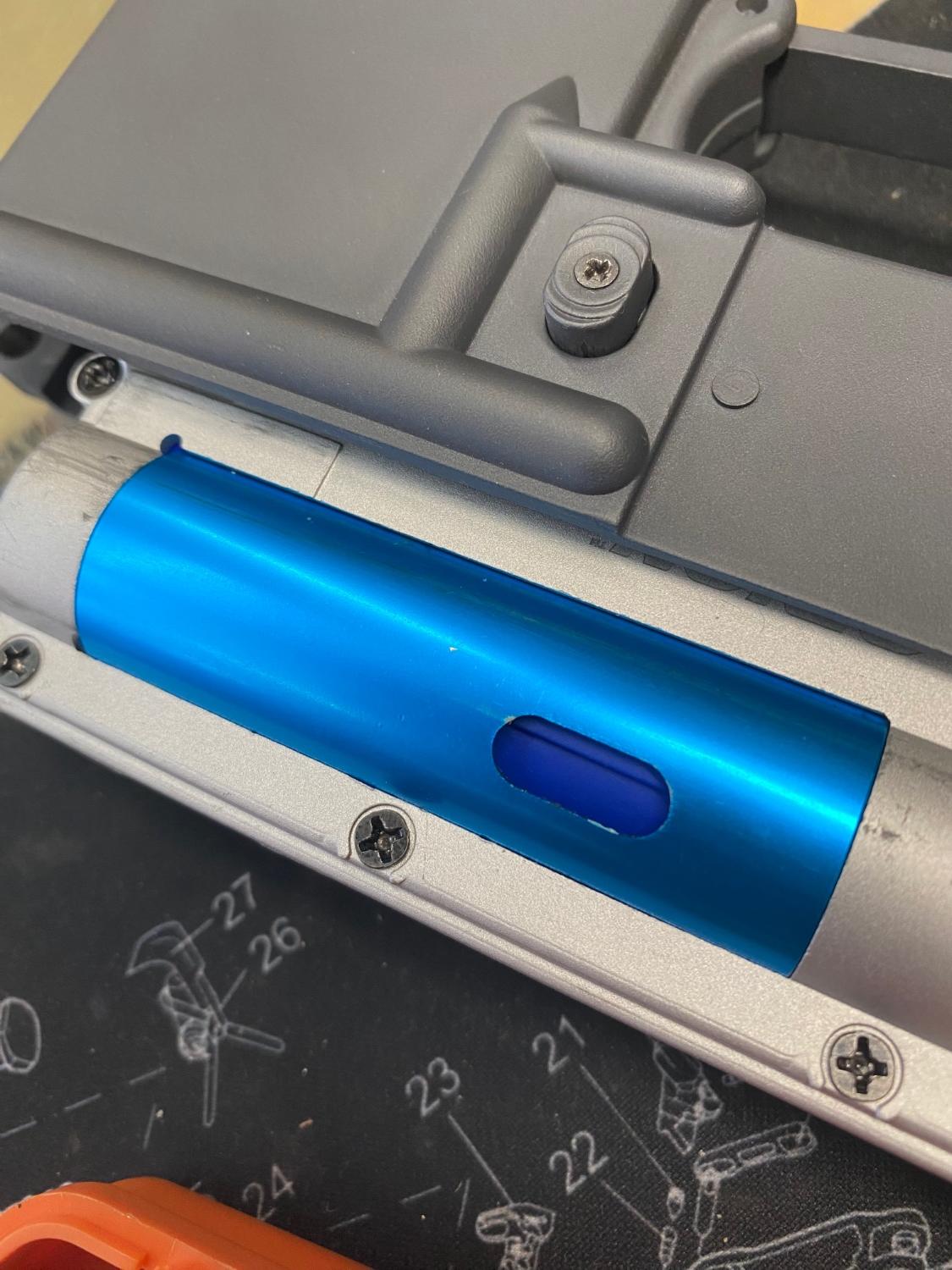

I also didn’t realise but the cylinder has a hole in it at the back, so I’m going to replace it with a brass sealed one and see if it improves the performance.

After changing the cylinder the fps has stayed the same, so that leaves the dodgy hop unit and the nozzle. That’ll be the next changes to see if it helps.
0.54j on a .25g bb isn’t ideal though, that’s for sure!
The hole is a port, you get ones at different positions to adjust the volume of air being sent to the barrel.
Typically different port positions dont have much impact on fps (unless it's significantly under-volumed for the barrel length), counter intuitive as that may be. I suspect arcane pressure curve type shenanigans are to blame.
For a 590mm barrel, you'll be wanting a full cylinder for the volume anyway so it's not a wasted change.

To be fair, it's a nasty old brass one so I'll be ordering a nice new shiny one along with the nozzle etc. I also realized when I was talking about nozzles needing different lengths for inner barrels I was actually thinking of the cylinder which I'd read on AK2M4's site.
Luckily I did open it, as my piston was chewed to pieces and didn't look like it would survive much more. Lovely specna quality. Great, until it's not great. ?

It seems that you have an AoE problem in addition to your low FPS.  While you have it open, have you checked the internal air seals?  When it was all in one piece, did you do the paper test for any nozzle/hop rubber air leak?

So as I removed the case, the tappet plate had somehow bent itself up, right around where the damage to the piston is. Air seal is all good, replaced the piston and tappet and still all good. FPS is also consistent, just low.
I’m aiming for at least 0.91J on .25g
