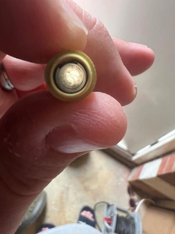

Pollynator_bravo2 Posted July 31 Author Share Posted July 31 useless picture I know but the only one I have currently. I think it’s about half way down to two thirds of the way ak2m4 1 Link to comment Share on other sites More sharing options...
Colin Allen Posted July 31 Share Posted July 31 17 minutes ago, Pollynator_bravo2 said: useless picture I know but the only one I have currently. I think it’s about half way down to two thirds of the way That looks like the standard G&G cylinder; what is the inner barrel length? Link to comment Share on other sites More sharing options...

Pollynator_bravo2 Posted August 1 Author Share Posted August 1 This is the cylinder. I managed to find the invoice from when I brought it. I’m taking the gun apart this avo so I’ll measure the inner barrel Lozart 1 Link to comment Share on other sites More sharing options...

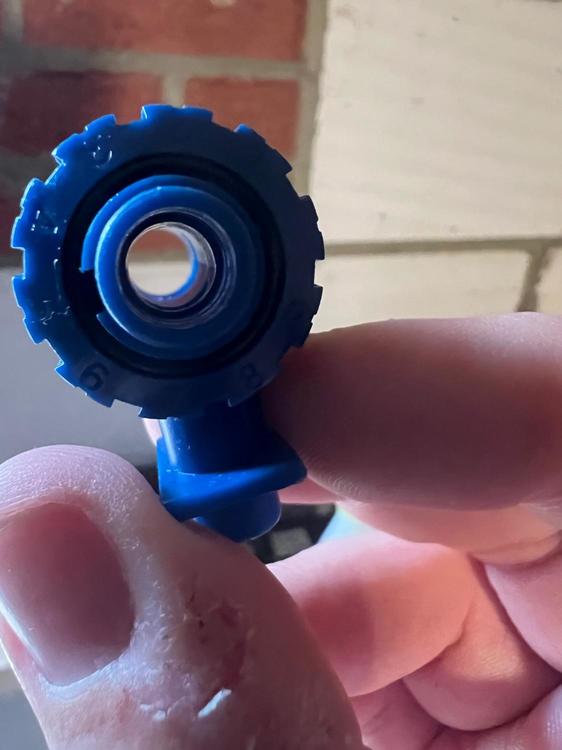

Pollynator_bravo2 Posted August 1 Author Share Posted August 1 So it’s a V2 gear box, Maple leaf 60 degree bucking, no delay chip, 13:1 gears, 18000 ASG motor, Rocket v2 tappet plate, SHS nozzle 21.4mm, Gate EON protector cylinder head, EON Power hybrid cylinder head. Hop unit looks like a basic rotary unit but it was what come with the shell/receiver when I brought it second hand. The hop unit I used to run when fitted to the inner barrel, wouldn’t let the upper receiver fit all the way into the lower Reciever (this one has happened to me twice now so I’m wondering if some how I’ve made a school boy error when putting the upper back together) I’ll get the measurements on the inner barrel and some more pictures later Rogerborg 1 Link to comment Share on other sites More sharing options...
Colin Allen Posted August 1 Share Posted August 1 3 hours ago, Pollynator_bravo2 said: This is the cylinder. I managed to find the invoice from when I brought it. I’m taking the gun apart this avo so I’ll measure the inner barrel That should be ok for most M4 type barrel lengths. I use a similar one with a 360mm barrel. Link to comment Share on other sites More sharing options...

Pollynator_bravo2 Posted August 2 Author Share Posted August 2 19 minutes ago, Lozart said: Timing does indeed mean the cycle of retracting the nozzle to allow the bb into the hop unit, then allowing it forward to seat the BB into the hop before the piston comes forward. If you're not getting a feeding issue that should be OK but if the nozzle isn't actually seating on the feed lips of the hop rubber properly you may be getting an air leak. The chamfered tip of the nozzle should seal into the end of the hop rubber (the feed lip if you will). An easy test is to reassemble the gun, turn it upside down and place a small piece of paper over the feed tube. When you fire the gun the paper should move only minimally, if it blows off then there is air escaping down the feed tube. Also - it may be the camera angle but your barrel doen't look straight in your hop unit - it may need twisting slightly to line it up. Awesome thanks I’ll try this. if there is a leak does that mean I should fit a delay chip or slightly longer nozzle? Link to comment Share on other sites More sharing options...
Supporters Lozart Posted August 2 Supporters Share Posted August 2 26 minutes ago, Pollynator_bravo2 said: Awesome thanks I’ll try this. if there is a leak does that mean I should fit a delay chip or slightly longer nozzle? If there's a leak it's going to be most likely the nozzle length. Rogerborg 1 Link to comment Share on other sites More sharing options...
