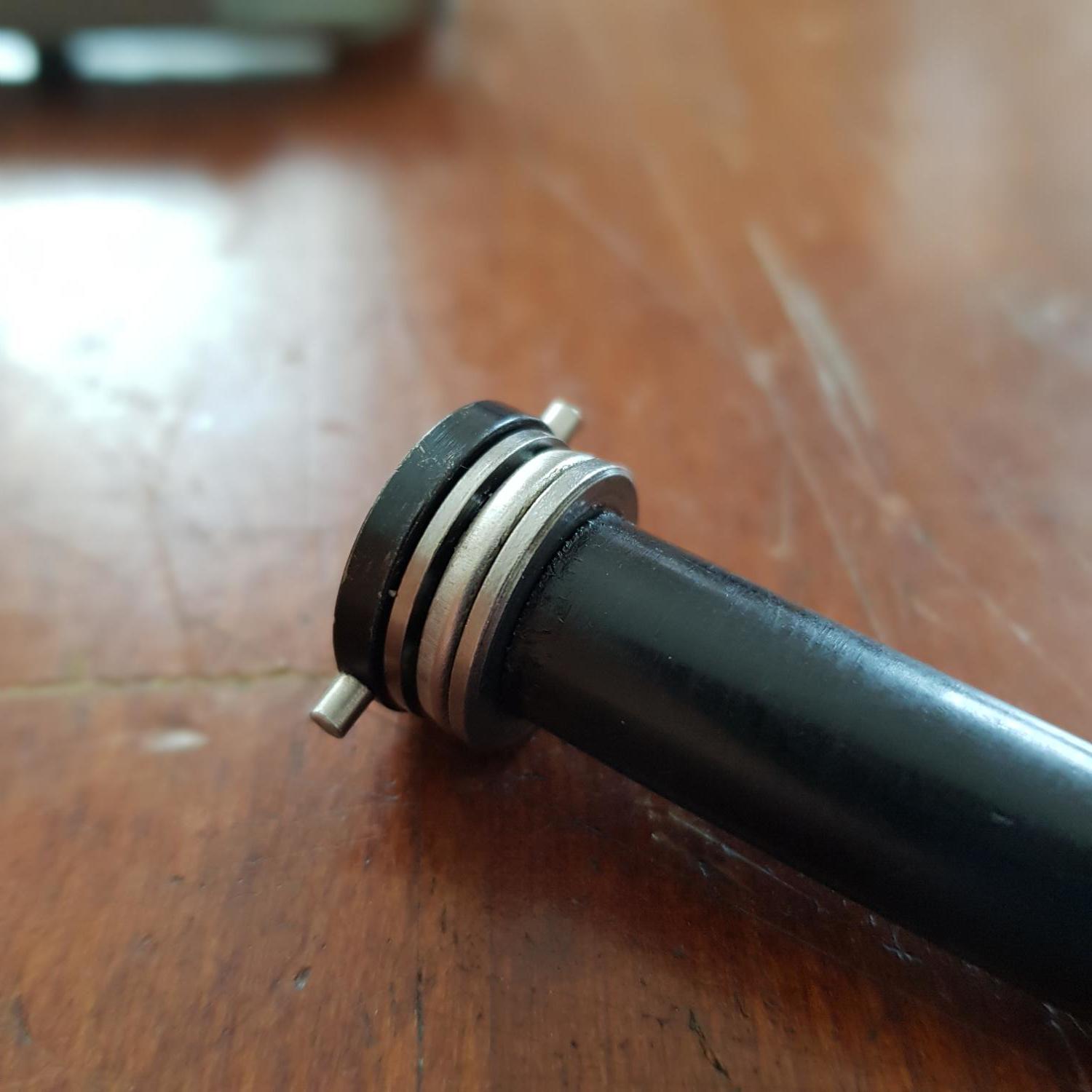

G&G rebuild - protruding bearing!

That was on the MP5 and I lost just under 20FPS going to one bearing from 2 so they would be a bit higher with the 2 bearings.
Progressive springs are designed to have the coils close up and (they would not be progressive if they did not) you will end up with a spring that wants to bend in the middle if you heat up the middle of it to remove the springiness.
If you really want to shorten a spring don't cut any off, pop it in a cup of water leaving the 15mm( or whatever you want to shorten the spring by) poking out and heat up the end with a propane o butane torch  nice and quickly to a cherry red colour. Let it cool in the air. Then compress it on a long bolt to shorten it. You can repeat the process if you need to. I've  never really understood why people cut the spring at all.

I guess the 20 FPS loss from removing the bearing is actually because the rotational friction on the non-bearing side is slowing its decompression
Try playing with a spring by hand, but twist it or keep it from spinning, the twisting itself is going to affect it wants to expand/compress, in fact you can try to compress/decompress the spring by the twisting alone

You need 800+Celcius to anneal springs, stainless is higher.
The 20FPS loss is because the spring is less pre compressed, there's no extra friction in having 1 bearing instead of 2. I'm going to explain why because it's come up before.
If you compress a spring one end will rotate with respect to the other and if you have a bearing at one end, that end will rotate freely because bearings have less friction than the spring rubbing against another flat surface and once the bearing is rotating there is not enough force to rotate at the other end. The whole spring is not rotating, the wire is repositioning itself as it is put in torsion, so if it is fixed at one end the other rotates.
In Airsoft we have bearings not for friction issues, but so that the spring maintains its shape and does not bend to one side or the other when it gets compressed. You could fix the spring at both ends and have no frictional losses but you would still have the spring deforming as it compresses.
If you put a bearing at both ends and lets say, one bearing is a bit stiffer than the other, then the bearing with the least friction will rotate first, but the other bearing will not rotate because the force to rotate it never gets high enough since it is relieved by the first bearing to rotate. This is essentially what happens if you have just one bearing.
 Remember that if the spring is fixed at one end there are no frictional losses, as it doesn't move.
Friction also doesn't care about area, only the force and coefficient of friction. So if you have a bearing at both ends the friction is double that of one bearing, since the force at both ends of the spring is the same. If only one bearing rotates, the friction is halved. Because the angle the spring rotates is double with 1 bearing the same amount of losses occur. Both bearings need to rotate of course for this to be true.

Would removing a mm or 2 make that much difference? I'm looking at shortening my spring by about 17mm? I need to drop about about 20fps.
Really grateful for all of your input too. 😁
If you shorten the spring by 17mm, the power will drop immensely.  Take off a coil or two.
Ok, I heated the end of the spring and compressed about 15 mm ish. Put it all back together and it was totally dead!! Stripped it apart, and slipped, it all went flying all over the floor! Bollocks!!!!! So reshimmed, rebuilt, reassembled and it shoots lovely but stitting at a reasonably consistent 305fps on .28s so 1.2j. Still a little spicy. It was around 320fps on .28s - 1.3j.
I've had a look but can't find a spring thats 160mm so I'll probably just heat/compress a little more. Not today though.
Stop worrying about the length of the spring and focus on the power rating; that is what matters.

You are overthinking it.  The power rating is what it will produce in a typical (probably V2), well set up basic gearbox.  Other variables are far more significant than the length of the spring, such as the barrel length and diameter, the cylinder type, the presence or absence of piston head or spring guide bearings, and the quality of the airseals.
Once you have a starting point of a known output from a manufacturer's particular spring, it is easy to adjust upwards or downwards.

When in doubt, Retro Arms low profile bushings are the way to go. I've run them from 60 RPS to over 2J.
Ok, final update then I'll stop. For now!
I set the pre-cock, on the Perun ETU++, to level 4 and left it for about 24 hours. Just checked it and it's shooting .28s at a very respectable 284fps/1.09j
