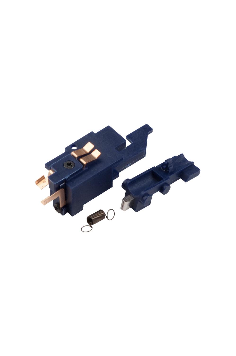

The Caa m4 with the king's arms gearbox...I think need to go back in and have another look at the trigger. When pulled, there was no spin from motor but with half a pull and carefully holding I can get it to fire but lacks consistency. So another one I need to crack open again....
Any tips on what to look for as to trigger contacts and placement?
Trigger contacts oxidise over time, arc and then fail to make contact. But they also get hot and the plastic holding them in place melts and the contacts move.
The exterior contacts if you have them are unnecessary.
Replacing the contacts is advised and also the fire selector plate if the copper part is used.
My mp5 had the copper contacts on the trigger contact block and this should be avoided.
Get one without contacts if you have this version.
You will see the state of the exterior contacts after you take selector plate of or to the safety position.
From what you say it sounds like the selector plate contacts, but the trigger contact can also behave this way also.
