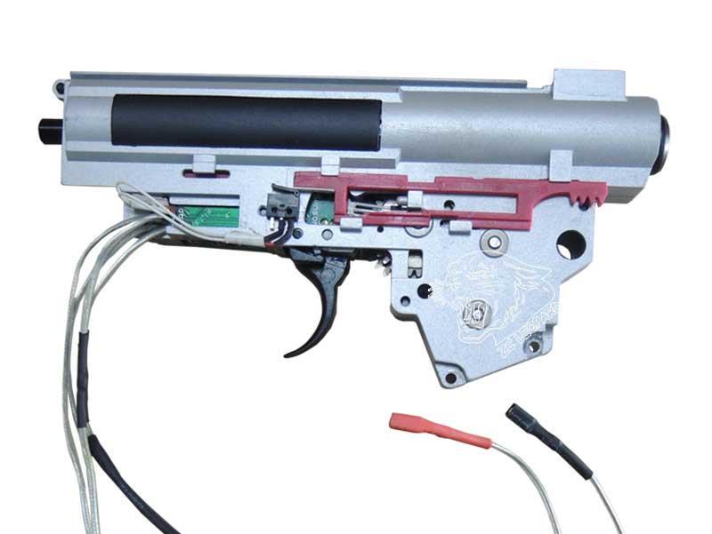

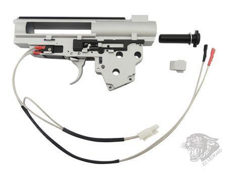

I don't think I've ever seen an ARES v3 gearbox, however their V2's were originally ZCI's micro-switch design.  Does it look like this?

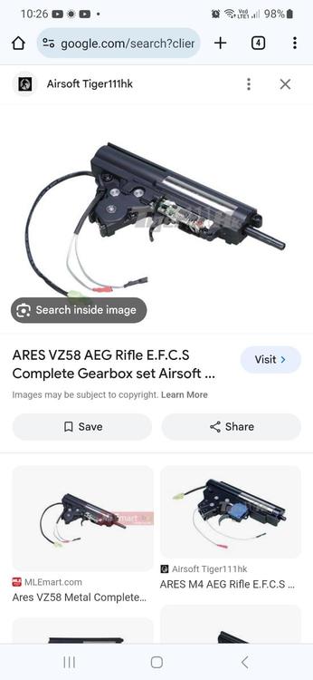

Hi, so I had a look at what the gearbox looked like and it sadly doesn't look like that. But I do have an image of that gearbox. Would you be able to make any special orders if I find the specific part i am after? If you're only able to get the gearbox that is equally fine as it will be working.

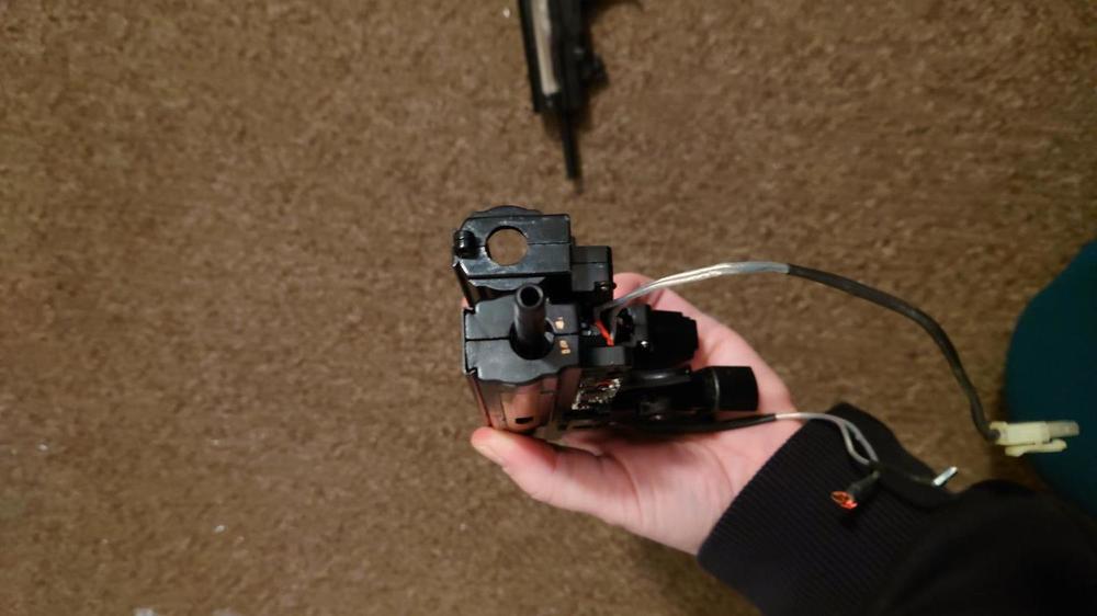

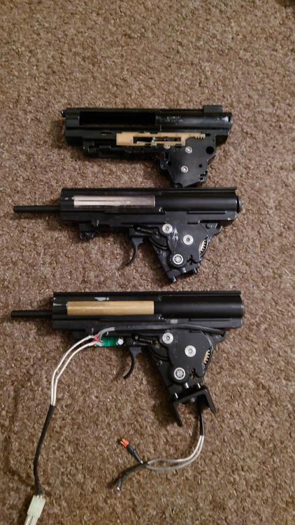

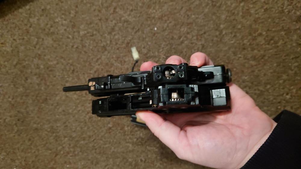

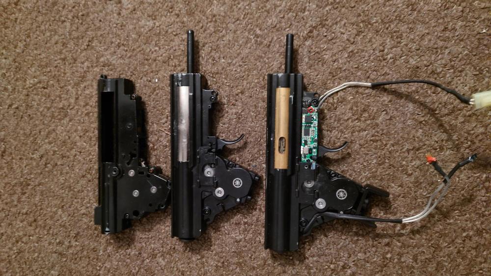

I think it would be beyond that unfortunately.
IIRC, the cylinder head and nozzle sit much lower than they do on normal gearboxes, and the motor attachment is more akin to a V2, where you screw the grip directly into the gearbox shell, rather than having a motor cage.
I'll try to dig out one of my spare gearboxes and get some photos.
Photos of a V3 and two VZ58 boxes, with and without the trigger board & motor guide.

1 hour ago, Hudson said:
Not wanting to jinx myself, I've been lucky enough with my VZ58s to get away with just a bucking and barrel change for most of the 7+ years I've had them.
The ETU is where I've had issues unfortunately!
