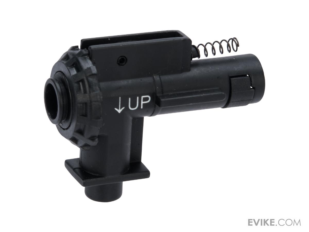

How do I dial it back, sorry im sounding so stupid. Im still very new. Do I just go up or down with it, and how will i know if the hop up is dialled off? any videos?
Take this as example, from this view (and the receiver opening) if you turn the dial down, it means up, the hop rubber will come down, and the BB will go up
(seriously just turn counter-clockwise to reduce hop, which is what you are trying to do in your situation)
