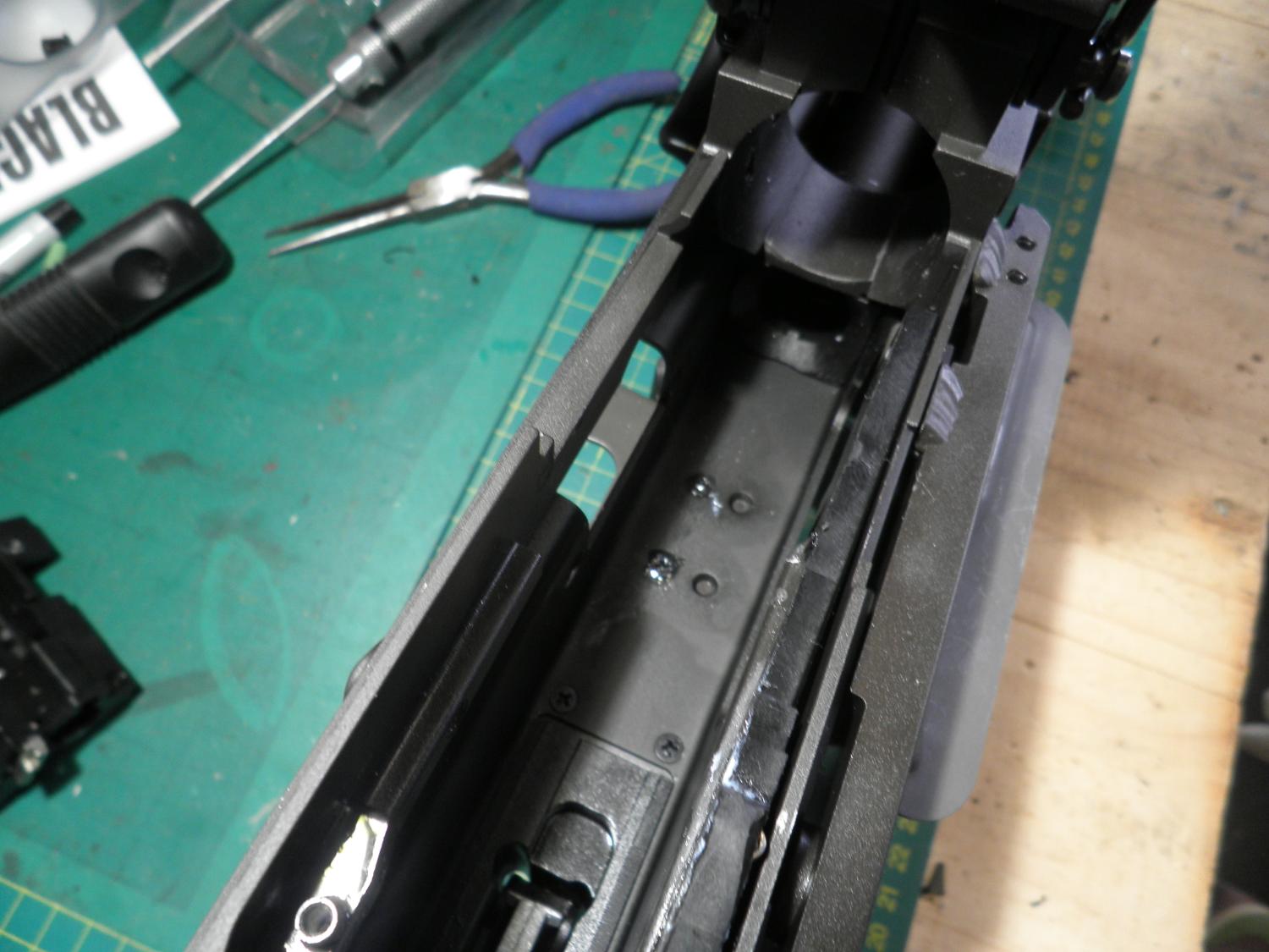

Nick G Posted August 13, 2023 Author Posted August 13, 2023 I plan to strip mine down today . Want to give the internals a clean and lube as well as checking tighness of bolts . The mount for the box mag has a little movement , looks to be held by 2 bolts which I suspect need a tighten and some locktight. Also the gas 'block' for the box mag has popped out of location in the mag well a couple of times, which might be down to me not inserting it completely but will look at that.
Nick G Posted August 13, 2023 Author Posted August 13, 2023 Well I've had it apart this morning. Not a bad job, one or two fiddly bits but no worse than any of my other GBBRs. The box mag clip is held on by two small bolts which seem to be the only ones on mine where lock tight wasn't used. There are 2 further holes in the lower reciever, so if the clip works loose again I'll drill and tap it and use 4 bolts. The 2 offending bolts can just be seen in this pic, now with lots of thread lock on them. The gas block for the box mag issue is odd. It's not down to me not pusing it fully home . It doesn't feel as snug a fit as the stanag though so I think it's moving just enough under recoil to allow the mag catch to release. I'll try adding a shim to the bottom of the block and see if that sorts it. Might be an issue to watch for or it might just be mine. Will be interesting to see. I had to trim the gas pipe in the box mag shorter to get everything to fit properly, but mag bow fite sthe reciever clip nicely and I can get the fake bullet belt into position on the mag. The face rounds look very plastic so I'll make up a deac round belt for it. Impressed with it

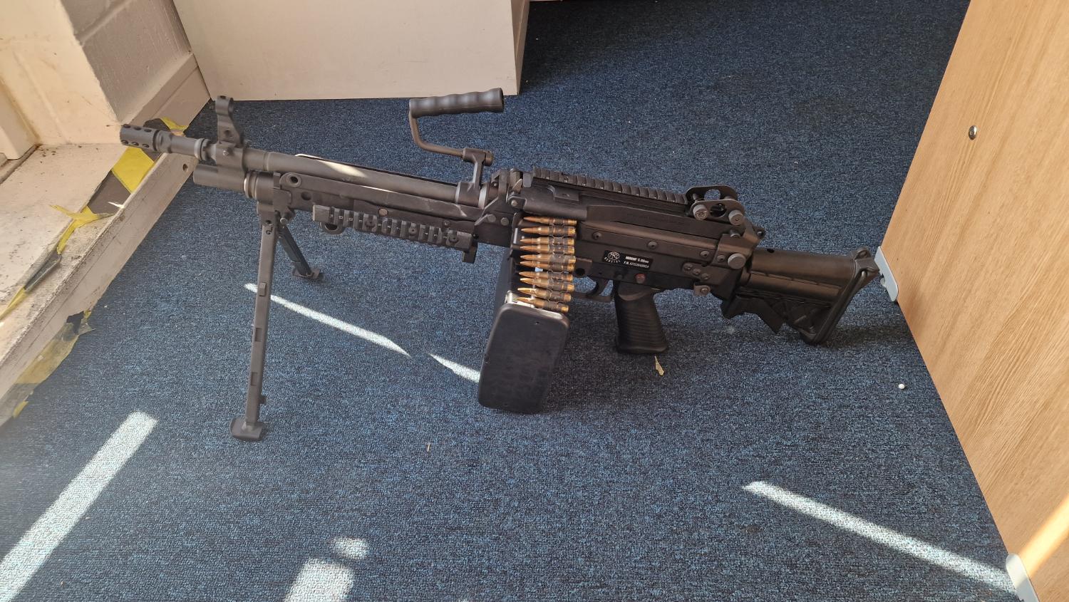

Nick G Posted August 13, 2023 Author Posted August 13, 2023 Short walk around Vid. Super64 and CrackCommandoUnit1972 2

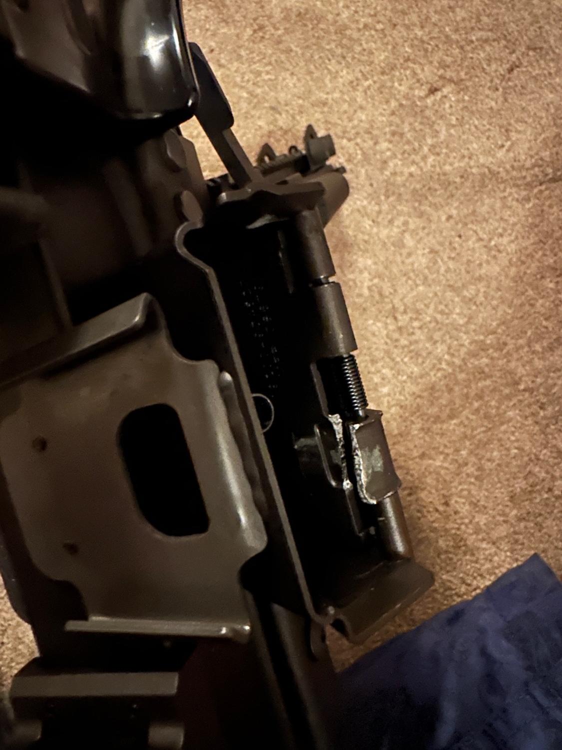

JayS Posted August 23, 2023 Posted August 23, 2023 Hi all, I just opened up my m249 today and the magazine catch is really not working I suppose this is not how this should come right? im really disappointed tbh thought VFC had good reviews on the m249 and it seems like they have really poor quality control. any help would be greatly appreciated to see if this is normal, but I doubt this is correct. thanks Nick G 1
1st commando Posted August 23, 2023 Posted August 23, 2023 1 hour ago, JayS said: Hi all, I just opened up my m249 today and the magazine catch is really not working I suppose this is not how this should come right? im really disappointed tbh thought VFC had good reviews on the m249 and it seems like they have really poor quality control. any help would be greatly appreciated to see if this is normal, but I doubt this is correct. thanks That's been broken ! There have been a few got broken in transit etc and if you email [email protected] they will send you a new one directly. Where did you buy from?
JayS Posted August 24, 2023 Posted August 24, 2023 Hi I bought from Airsoft world.net I thought it was broken but had to be sure. I’m not sure there are any replacement parts for the magazine well. reached out to them already but no response. thanks for feedback

1st commando Posted August 25, 2023 Posted August 25, 2023 14 hours ago, JayS said: Hi I bought from Airsoft world.net I thought it was broken but had to be sure. I’m not sure there are any replacement parts for the magazine well. reached out to them already but no response. thanks for feedback Contact Airsoft world , it's up to them to help you. Worth emailing VFC too at [email protected] but ultimately Airsoft world should swap it right away as they are a UK retailer bound by UK trade laws.
