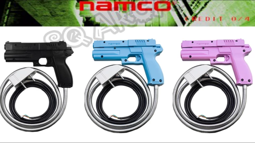

Forgive me as I know this is not strictly airsoft, but it is relating to the laws and I have not been able to really get a solid answer anywhere, I'm sure it will be of interest for anyone reading.
I am an arcade enthusiast and seek to purchase and import a replacement Lightgun which is a clone of the Namco amusement Time Crisis cabinet gun controller from China, it can also be used for pc gaming. I'd like to get this for Christmas so I can play House of the Dead and other classics with family.
From all that I have read, I would purchase a blue one as opposed to a black one to avoid it being considered a RIF, as an arcade part could it be considered a RIF if black? I would further imagine it would be an offence to paint it black afterwards, would that be correct? It seems that would be the case.
I wonder what your opinion is on whether there would be any issues even if it was blue? These cannot be purchased in the UK at all.
Further to that I did want to buy a replacement shell (blue) in case the light gun were ever damaged, do you think there would be any issues? These are both arcade machine replacement parts and are fully bright blue, I'd really appreciate your professional opinion, I was thinking to ask the seller to clearly label the items as arcade replacement parts, do you think there are any other ideas that might help? Grateful for your time and I suppose this is in the realm of toys essentially and how they relate to the laws.

15 hours ago, hitmanNo2 said:
It's not a RIF so you'll be fine.
Although we've seen people being required to complete firearms declarations even for parts.
But you'll still be fine, it might just take a bit more time.
