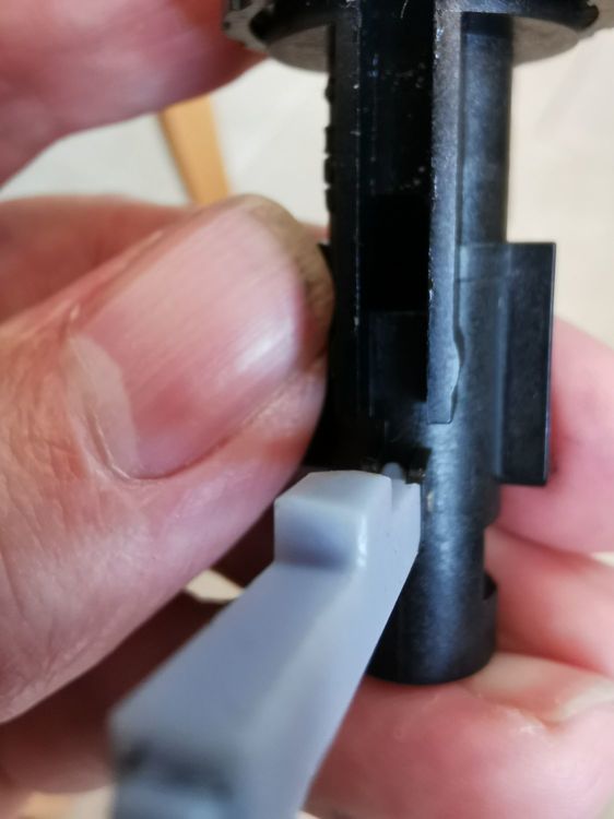

Cheers, have to check it out, that's a picture of the r hop arm, now I'm no expert but is that not ment to be flat, I've no o rings on the barrel but I thought the larger of the 2 springs in the krytac done this but I'll definitely try the o rings, the barrel I got came from their Austria branch so I hope they put the appropriate materials in it, I'm waiting on their response so see what happens.
Yeh, that should be flat, unless they’ve compensated for a very poorly done R patch
That's what I thought, the patch itself looks fine but as you can see the arm is everywhere, thanks for the help.
What is the arm made of?
Does it directly press onto the R patch?
Oh wow, unless theres some weird perception going on with that camera angle that is a wonky arm.
That'd definately cause some weird behaviour. The arm/nub/thing that presses down on an rhop patch should be a curve, a classic example would be the maple leaf omega nub (with the macaron bucking being essentially an r-hop moulded into a triangular shape and integral to the bucking rather than a seperate patch)
Edit- as above is there another peice between the arm and the bucking? Although even if there were it still wouldnt be getting even pressure.
It's made of plastic of some sort and the pin holding it in isn't a tight fit either and as far as I'm aware it does press directly down on the r patch, except I don't think it's a drop in patch it looks like it's been filled with a resin of some sort.
I have the omega nub and maple leaf macron in my sons crb, it's firing sweet not massive range but accurate. But there's nothing between the arm and the bucking in my own.
That sounds weird, like it’s more an S hop than R hop.
Is the patch soft to touch / does it move easily if you carefully probe with a bb in-jamming rod?
in that case going back to my response (with davegolf's caveat of maybe it's been done intentionally to compensate for the patch, but that's still poor workmanship) then that block being wonky is gonna give you uneven pressure and spinning rounds off at a weird angle.
you could try swapping it out for a stock arm with omega nub, see if that helps.
@2RIR this is definitely worth a try BUT be very careful taking the pin out that holds the end of the arm. The plastic wings on the hop unit that the pin goes through are VERY easy to snap.
Yeah I seen that the pin itself is loose, there is a bit of movement in it, they still haven't responded to my emails so see what happens as they do state if there's any problems they'll sort it, just wanted to get a bit of knowledge from people who know like yourself and the others which is greatly appreciated, before their customer service says its not their fault which I hope won't happen.
