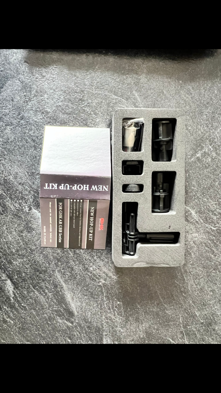

This has just arrived from wgc shop……
duh dum, duuuuh dum, dum dum dum dum dum dum….
Will be teching this weekend and let peeps know how it pans out…

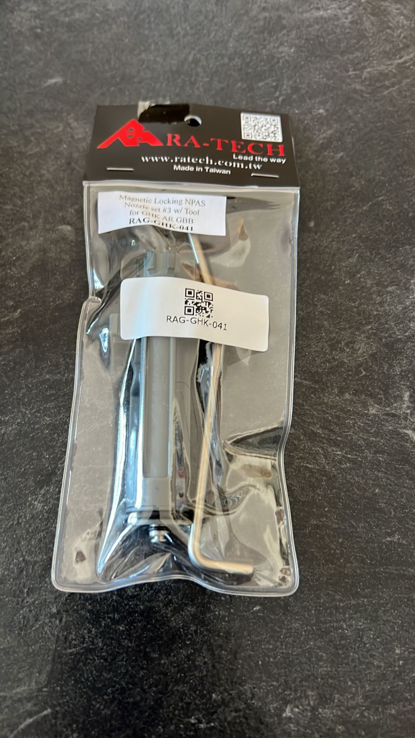

I do want to get one of those Npas pictured above
But interested to hear how that new adjustable hop assemble fairs up, as the ghk set up is a bit of a dick dance?

Yeah the boys got a l119 rail on it which makes it even more of a ball ache. It was choice between maple leaf dual adjustment or the ghk; ghk being a good stock component hence the logic of sticking with oem

I received my RA Tech Npas, and it fitted in the SAI bolt carrier nicely, strangely enough, a better fit than the low power 1J nozzle that is fitted in my slow mo video. The Npas retracts back into the carrier far quicker and smoother than the standard nozzle.
I’ve seen comments that the Npas with the metal lugs can leave shavings on the battery!
Mine does appear to line up nicely, yet to get it out to the range and test it out for fps &  consistency etc
