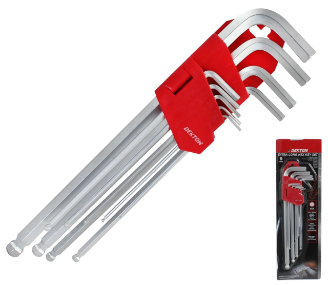

If that doesn't sort it then what you absolutely must never do is to shove a long T-handled Allen key or similar tool up the nozzle and shove the piston back until it releases, because it will make Reddit cry when it doesn't actually wreck your gun.
Making the knuckle draggers on reddit cry is enough reason to do it

Note: when doing this use a flat ended tool.
Balls.
I mean "ball hex Allen key"
