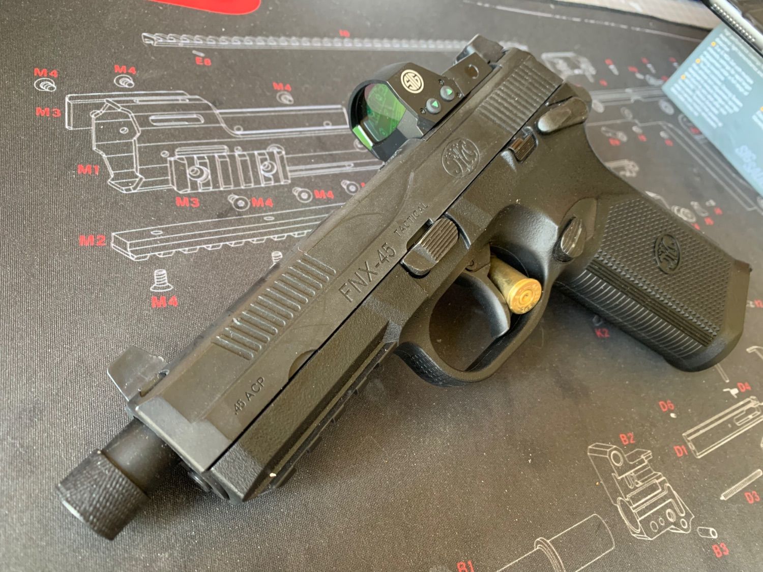

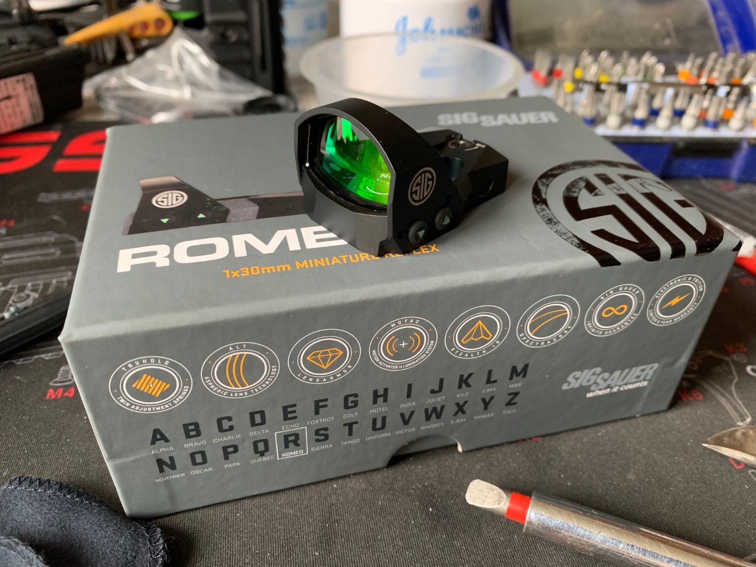

I have a Sig Sauer Romeo1 on mine
74C1068D-B42F-4E4D-80B3-D602CCE978F4.thumb.jpeg.9c211d8d88192ce8af5c16db4d139fb5.jpeg800D8F66-3200-4566-A1FD-0302E47C621E.thumb.jpeg.1bdd8f2c6a09d9e50089ee3fe70c3481.jpeg52264EB5-CFC9-4A20-AB36-DA864F356212.thumb.jpeg.ba0807a8adf219d0658f53718ae7d126.jpeg

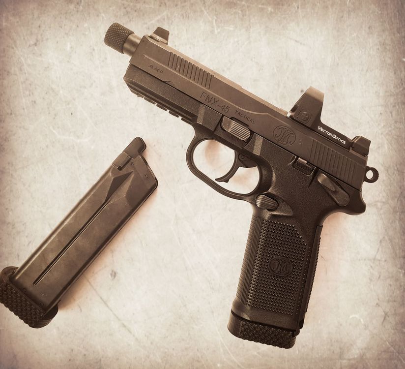

Thanks for the RMR suggestions @MagpieTactical and @rocketdogbert - I wish I had known that the TM had this kind of issue, I suppose I just went along with assuming it had the usual TM quality seal of approval. I do have to ask is that the Vector Optics Frenzy-S on your gun Magpie? I did hear that Vector Optics were an overpriced chinese rip, but I'm happy to be proven wrong on that, because they're the only real steel option that won't completely break the bank. Also did you both have to get the DCI RMR mount plate to fix them on the FNX?

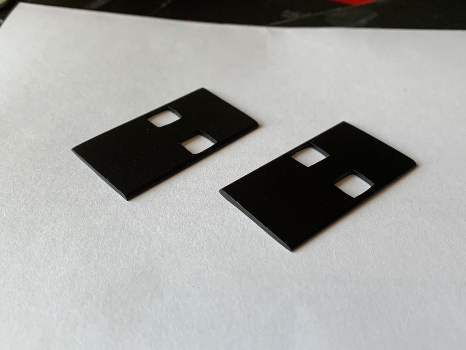

Oh! Haha, I'm assuming you don't sell them and the like. I suppose I may need the DCI mount after all then, if only to provide the spacing.
Do DCI make one for the TM? I’ve never looked.
Drop me a DM if you want me to make you a spacer plate,

Its the Frenzy 1x20x28 6moa model
https://www.opticswarehouse.co.uk/vector-frenzy-1x20x28-rd-vt-red-dot-sight
+1 for the Vector Frenzy.
I have them on my Action Air GBB pistol which runs on black gas and on a RS .22LR LBP. No issues on either although I do have them frame mounted not on the slide. Haven't needed to try the warranty yet but it's supposed to be good.
Are you happy with Sig Sauer? Because I am thinking about purchasing optics and I have heard differnets opinions about it. Someone is completely satisfied with it, someone says that they don’t have that tactile click that one like when adjusting. I think that is not big deal

It is absolutely perfect, with a very positive click when adjusting. I am having some battery issues at present, that I’m hoping isn’t the sight but a bad batch of batteries
