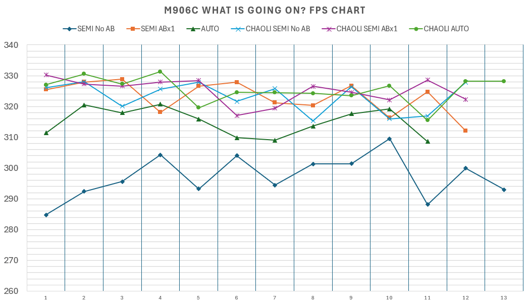

Herrgh Posted June 18 Posted June 18 Hello again! I finally got round to fixing my gun and it seems to be operating okay. Piston head is now thread locked in. I feel that there is a slight springy "twang" to the end of each shot, but not sure what I can do about that without breaking it open again; I want to get at least one game day under my belt with this thing before messing around with it more. Anyhoo, the FPS has now gone up by around 20(!), which I attribute to the new XT POM nozzle with o-ring just giving overall a better air-seal. However, the gun is still exhibiting the odd effect of having a higher FPS on auto compared to semi. Applying one step of active breaking to the semi-mode brings the semi FPS up to that of full auto. Here are the chrono results for my last 24 shots (with 0.25g ammo): SEMI 317.2 320.4 310.7 322.1 316.9 311 319.5 311 311.5 317.4 310.7 302.9 320.7 322.3 FULL AUTO 311.4 320.5 317.9 320.7 315.9 309.8 309 313.6 317.6 319.2 308.6 MIN - 302.9 MAX - 322.3 AVG - 315.1 Attached is a the above expressed in a line chart. Copilot says my hardest shot comes out to 1.21 joules on 0.25g (this is using an M105 spring). I'll look to stepping down to a M100, as I really didn't expect that switching out the nozzle to one with a o-ring would "improve" things that much. The joule-age is a tad too high for me to be comfortable. Anyways, I think there is definitely some weird cycling issue here, but I can't really figure out why, or what is causing it. It's interesting that the gun appears to repeatedly peak at around 320 FPS before dropping back down to ~310FPS. Again, turning OFF all active braking will drop my shots to approx 290fps on semi (unchanged on full auto). Does anyone have any insight? (I have a video showing the pistol cycling which I'll try to link to soon, to help with diagnosing.) ak2m4 1
mightyjebus Posted June 18 Posted June 18 it might be a red herring. Have you tried a different chrono as the chrono you are using might not be the best for accurate FPS readings in full auto. Herrgh 1
Supporters Adolf Hamster Posted June 19 Supporters Posted June 19 Those numbers look pretty similar to me? If anything auto tends to be more often in the sub 310 range than semi. Spring twang can sometimes be resolved with precocking, getting the spring immediately under tension after the previous shot, although that comes with the unfortunate downside of also making the gun feel more responsive..... Herrgh 1
Herrgh Posted June 24 Posted June 24 (edited) More data (as I realised the data set above doesn't show the point I was trying to make, that semi is low FPS until I add 1 step of Active Brake, which brings it in line with the FPS shown on auto). SEMI No AB, SEMI ABx1, and AUTO were recorded using a Solink brushless motor. The "Chaoli" lines are the same, but using the M906Cs stock (crap) motor. Motor is definitely responsible for this behaviour. Must be some sort of overspin or something, but I've definitely lost the magical sparkle that the DE factory put in the gearbox that allowed the stock setup to be quite stable in its FPS (around 290FPS on 0.25g), instead of the wild variances shown here. Precocking level 1 on semi (w/ solink motor) results in a slight drop in power from the levels for SEMI No AB. (Perun advise that AB and PC can't be on at the same time). Precocking level 5 on semi results in a doubleshot. My chronometer is an AceTech AC6000BT. It was a bit expensive so hopefully there are no issues with its accuracy! Edited June 24 by Herrgh pyromancer6 1
