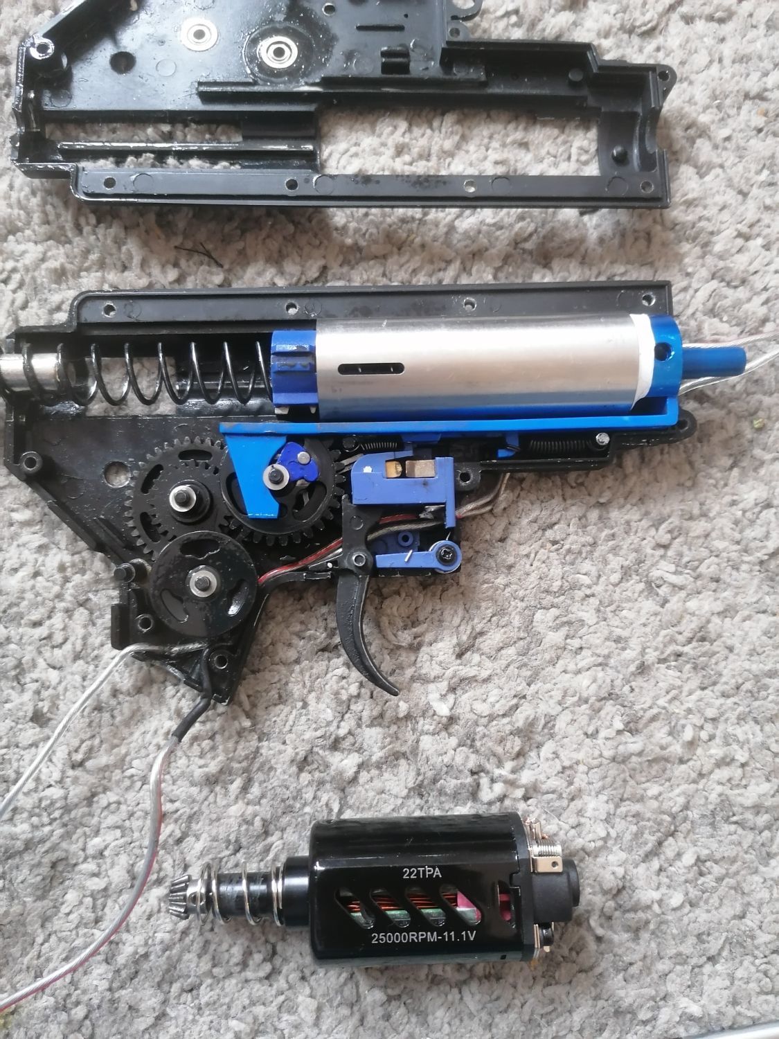

Pewpewpetie Posted September 27, 2021 Author Posted September 27, 2021 1 minute ago, Lozart said: That'll be your problem then. What would you reccomend 2 minutes ago, Lozart said: That'll be your problem then. I have another m4 with same build and have no issues Should I put a standard gear set in .
Skara Posted September 27, 2021 Posted September 27, 2021 Well the energy output suggests it's a hop up issue. As you guessed, it's most likely the hop arm being wobbly/loose, or it could be the tensioner being way too soft. The harder the tensioner (and stiffer the arm), the more repeatable the backspin.
Supporters Lozart Posted September 27, 2021 Supporters Posted September 27, 2021 1 hour ago, Pewpewpetie said: What would you reccomend I have another m4 with same build and have no issues Should I put a standard gear set in . Personally, I'd fit a Gate Titan or Aster but Perun V2 Hybrid would also work. Basically anything that senses the gear rotation to be able to stop it in the same place each time. That being said, it doesn't actually matter all that much unless you're getting feeding issues or you're trying to get accurate pre-cocking. Inconsistent hop is unlikely to be adversely affected by the piston not stopping in the same place. I'd also get rid of all that bloody PTFE tape. There doesn't look to be much in the way of lubrication either (although that may just be the picture).
Pewpewpetie Posted September 27, 2021 Author Posted September 27, 2021 27 minutes ago, Lozart said: Personally, I'd fit a Gate Titan or Aster but Perun V2 Hybrid would also work. Basically anything that senses the gear rotation to be able to stop it in the same place each time. That being said, it doesn't actually matter all that much unless you're getting feeding issues or you're trying to get accurate pre-cocking. Inconsistent hop is unlikely to be adversely affected by the piston not stopping in the same place. I'd also get rid of all that bloody PTFE tape. There doesn't look to be much in the way of lubrication either (although that may just be the picture). Had to use the ptfe tape for now as don't have any other o rings. Gona have to set it aside for a Few days then try again. Stressful is an understatement
Supporters Lozart Posted September 27, 2021 Supporters Posted September 27, 2021 10 minutes ago, Pewpewpetie said: Had to use the ptfe tape for now as don't have any other o rings. Gona have to set it aside for a Few days then try again. Stressful is an understatement Don't over think it.
Pewpewpetie Posted September 27, 2021 Author Posted September 27, 2021 35 minutes ago, Lozart said: Don't over think it. Haha bit late for That
Pewpewpetie Posted September 28, 2021 Author Posted September 28, 2021 Finally I admit defeat, I've tried everything, 4 different rubbers, 3 different hops, 4 different nubs,3 different barrels and 3 different Air nozzles. Gun is very consistent now +-2fps but vertical hop is still all over the place. 2 out of 5 bbs hop too high , 2 will fly perfectly and then 1 will have not as much hop

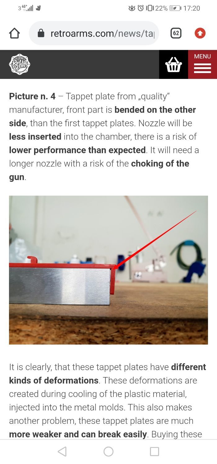

Pewpewpetie Posted September 28, 2021 Author Posted September 28, 2021 Also wondering if it xould be a tappet plate problem maybe angling the nozzle very slightly causing it to not enter the hop completely straight. Ill check when i next open it as i saw an article on it whilst searching every single page on Google hahahha
