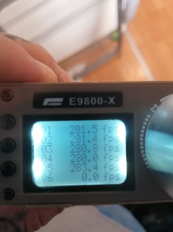

Pewpewpetie Posted September 25, 2021 Author Posted September 25, 2021 Right so , still no joy, I've tried a different barrel (standard and a zci) all are doing the same. I think it's time to give up, I do have a 3 fps deviation but I can't imagine that 3 fps would cause this. These are Chrono readings on 0.28g asg. Going to try playing with the hop arm as this is literally the only thing left, my last guess is that there is some vertical play on the arm causing different pressure to be applied each shot 20 hours ago, Asomodai said: Is there any residue on the inside of the outer barrel or flash hider? This happens on my FN57 pistol as the opening on the aftermarket barrel is too narrow and I occasionally get fliers. No residue anywhere, barrel is clean, tried new r hop patch, g&g green , prommy purple and a selection of nubs and still get it. It has to be the hop arm, some kind of vertical movement 20 hours ago, heroshark said: It bad JuJu, you need to perform a shamanic ritual. Have you got any animals that you could use as a sacrifice? Yeah tried shooting the cat but bb curved hahahahahah( I didn't really)
