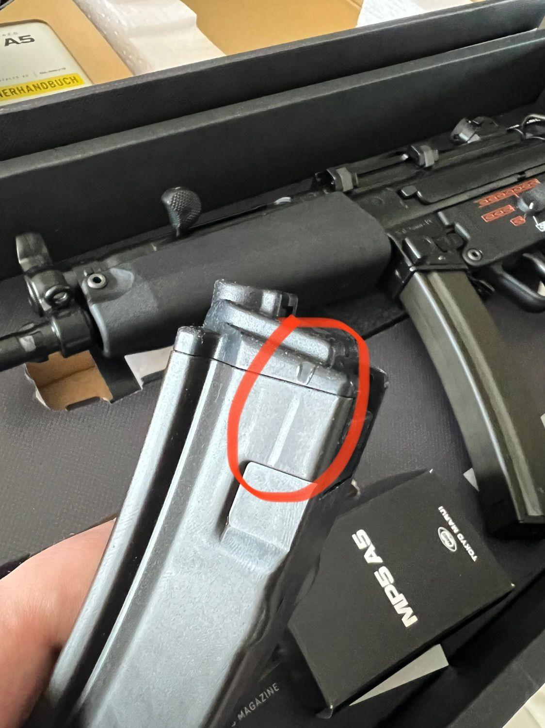

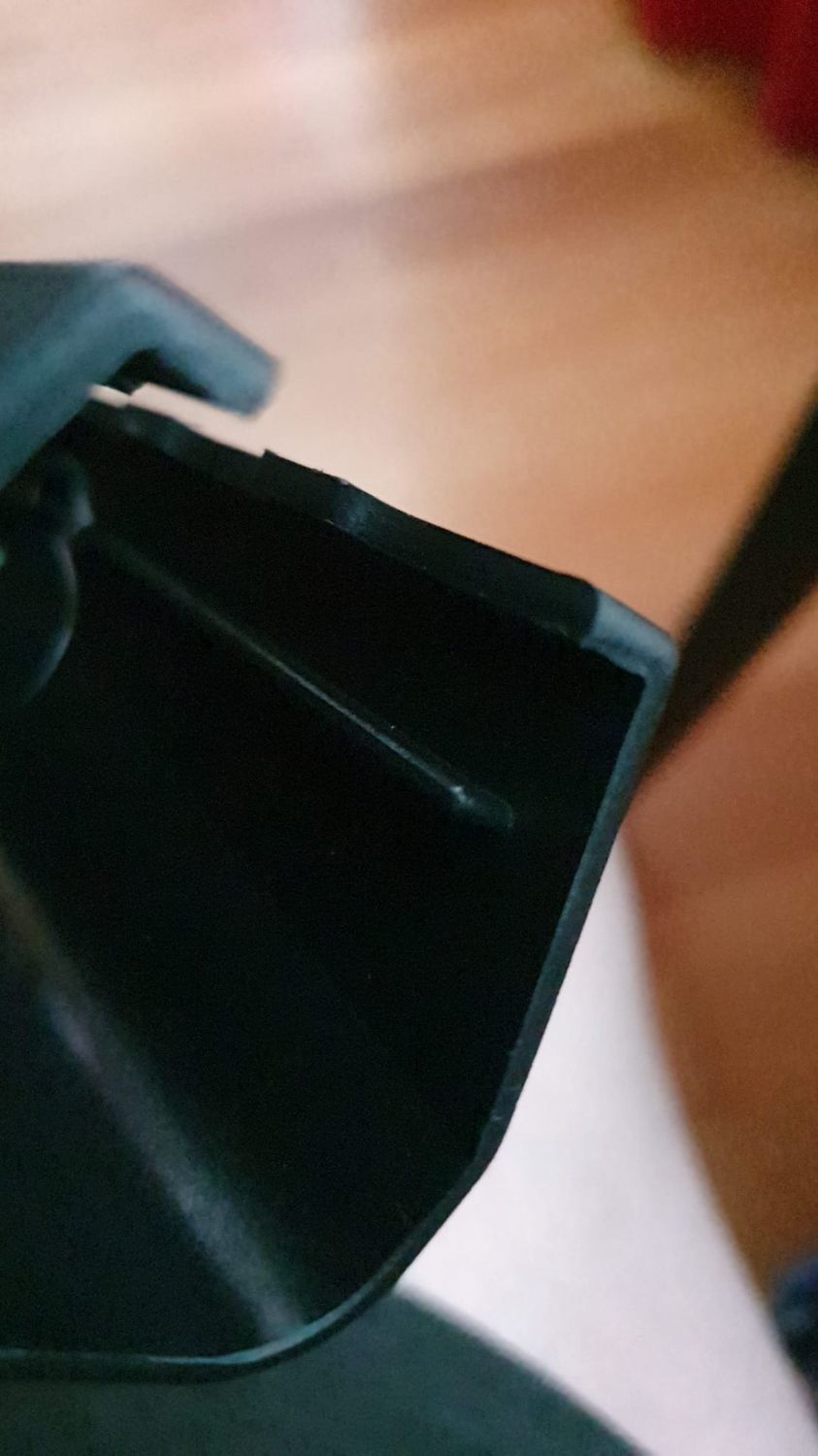

MilesR97 Posted June 6, 2022 Share Posted June 6, 2022 (edited) I’ve just received my tm mp5a5 ngrs and the magazines seem quite difficult to put in and after loading them around 20-30 times they’ve slightly worn away at the side. can anyone confirm this is normal or not? cheers Edited June 6, 2022 by MilesR97 JimFromHorsham 1 Link to comment Share on other sites More sharing options...
Supporters TheFull9 Posted June 6, 2022 Supporters Share Posted June 6, 2022 Had the same, not sure what to do about it though. Link to comment Share on other sites More sharing options...
MilesR97 Posted June 6, 2022 Share Posted June 6, 2022 5 minutes ago, TheFull9 said: Had the same, not sure what to do about it though. same, i feel like sending it back and asking for another one but i dunno how that will go with such limited stock etc.. i really have to force the mags in though, it definitely doesnt seem right 😕 Link to comment Share on other sites More sharing options...
Supporters TheFull9 Posted June 6, 2022 Supporters Share Posted June 6, 2022 Not to be funny but what would another one achieve? It's the design. For now all I can do is press the mag catch lever as the mag is going in, if it's as common as I suspect an update or aftermarket fix will come. Link to comment Share on other sites More sharing options...
MilesR97 Posted June 6, 2022 Share Posted June 6, 2022 34 minutes ago, TheFull9 said: Not to be funny but what would another one achieve? It's the design. For now all I can do is press the mag catch lever as the mag is going in, if it's as common as I suspect an update or aftermarket fix will come. I didnt realise this was a really common problem and thought mine was faulty, but it seems its fairly normal, sorry. Link to comment Share on other sites More sharing options...
Supporters TheFull9 Posted June 6, 2022 Supporters Share Posted June 6, 2022 Nothing to apologise about mate lol, but if there's 2 people in just this small thread it's probably common and a design flaw; someone else will now say they don't have it but I'd bet this issue will show up a lot as the guns get more prevalent and get used over the next year or so. That's airsoft, unfortunately it's a niche tinkerers' hobby, and sure you have the same consumer rights as with anything, but you'd just waste your own time getting repeated returns quite likely. Sometimes you've gotta bite the bullet in this game. Link to comment Share on other sites More sharing options...
Bunkerstevo94 Posted June 7, 2022 Share Posted June 7, 2022 Just a heads up SRC stocks fit only require the hole drilling out to allow the tm pin to pass through about a 1mm too small of a diameter just waiting on my Midwest industries rail Wavey_Gravey, TheFull9, Mels and 1 other 3 1 Link to comment Share on other sites More sharing options...
JimFromHorsham Posted June 7, 2022 Share Posted June 7, 2022 (edited) On 06/06/2022 at 13:56, MilesR97 said: I’ve just received my tm mp5a5 ngrs and the magazines seem quite difficult to put in and after loading them around 20-30 times they’ve slightly worn away at the side. can anyone confirm this is normal or not? cheers mags are snug in mine , they have to be perfectly square or it’s a no go , depressing the mag release a touch also makes life a bit easier . The wear you are seeing would likely be 10times worse with a loose fitting rattletastic edition. Try a wipe over inside the magwell and the tops of the mags with some easyglide silicone spray , the key here is wipe .. dont spray it directly into or onto , just a little on a cloth . Edited June 7, 2022 by JimFromHorsham Link to comment Share on other sites More sharing options...

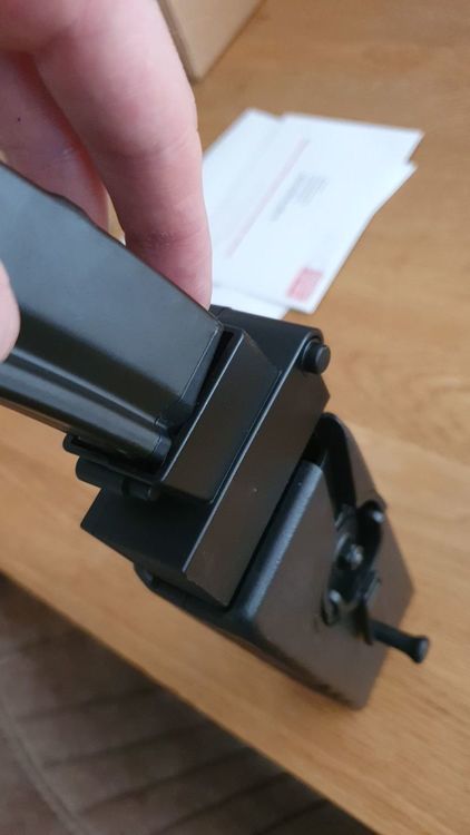

Xepo Posted June 18, 2022 Share Posted June 18, 2022 Hey folks, any of you have a recommendation for a speed loader like the odin sidewinder? I bought one from big dragon with an adapter but it seems the NGRS are a bit fatter Link to comment Share on other sites More sharing options...
Mels Posted June 19, 2022 Share Posted June 19, 2022 (edited) 6 hours ago, Xepo said: Hey folks, any of you have a recommendation for a speed loader like the odin sidewinder? I bought one from big dragon with an adapter but it seems the NGRS are a bit fatter I think this is the sloset you will get at the moment. https://www.airtac.me/shop/p/tm-mp5-ngrs Edited June 19, 2022 by Mels JamesWills 1 Link to comment Share on other sites More sharing options...
Xepo Posted June 19, 2022 Share Posted June 19, 2022 10 hours ago, Mels said: I think this is the sloset you will get at the moment. https://www.airtac.me/shop/p/tm-mp5-ngrs Alright haha, thanks for the link! Link to comment Share on other sites More sharing options...

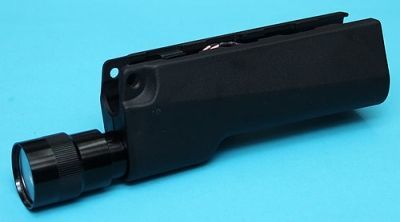

Xepo Posted June 23, 2022 Share Posted June 23, 2022 On 20/05/2022 at 20:57, Mels said: Thanks Stew, that's what I was hoping. Has anyone here tried the G&P flashlight handguard? Hey, I tried this today. It won't fit without taking a bit from the insides. Personally not a fan of the quality, in my case the button for the light has shady contacts which makes it more of a strobe than anything else. Returning it. Link to comment Share on other sites More sharing options...
JamesWills Posted June 24, 2022 Author Share Posted June 24, 2022 12 hours ago, Xepo said: Hey, I tried this today. It won't fit without taking a bit from the insides. Personally not a fan of the quality, in my case the button for the light has shady contacts which makes it more of a strobe than anything else. Returning it. Unfortunately all torch grips on the market require some modification to be "useable" I wasnt massively impressed with the quality of the VFC torchgrip I've got but its 10% of the price of a RS surefire grip Link to comment Share on other sites More sharing options...

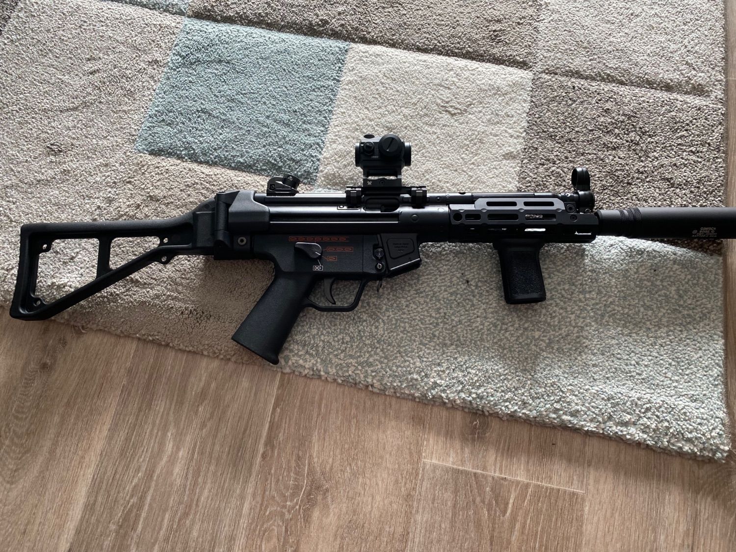

JimFromHorsham Posted July 15, 2022 Share Posted July 15, 2022 On 04/07/2022 at 09:45, JamesWills said: https://www.sixmm.com/products/army-force-airsoft-top-scope-rail-mountfor-tokyo-marui-mp5-aeg-umarex-mp5-gbb-series that was a good link , thank you On 24/06/2022 at 19:11, mightyjebus said: a 3D printed sleave between the receiver and the stock would probably work just wanted to say a big public thankyou to the very talented @mightyjebus for making dreams come true using his technical ability and my supreme postal prowess he sorted my MP5 stock adaptor good and proper ! It’s now solid as rock , thank you Paul JamesWills 1 Link to comment Share on other sites More sharing options...
