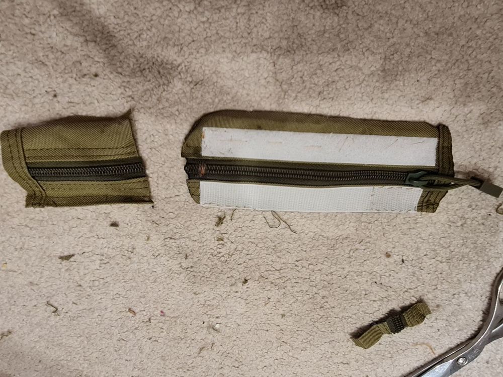

So I took apart an old pouch laying around, just wanted the zip.
(I only removed the front pocket, so the pouch itself is still actually intact) carefully removing the front pocket with a stanley knife gently blading the threads;
Until I got the zip.
Now I measured the velcro to be 155mm on the JPC, with the whole pouch width to be 190mm, so I cut the zip down and stitched a few million cross-stitched across the zip tightly (To prevent the zipper leaving the track) and then put some super glue over the threads to harden them up.

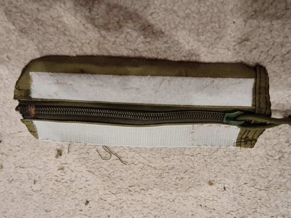

Then I used double-sided velcro to apply to the material, just to hold it in place whilst stitching it;
Stitching looks bad here but I took more time on it after the photo, frankly though it doesn't have to be perfect, it won't be under load or stress, and you can always touch it up with super glue.
Worth noting, after stitching across the zip and cutting the excess off with scissors I burnt it with a lighter to melt the end, and then went around the edge of the whole cloth with a lighter to stop it fraying.

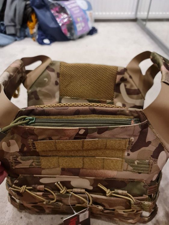

This is before;

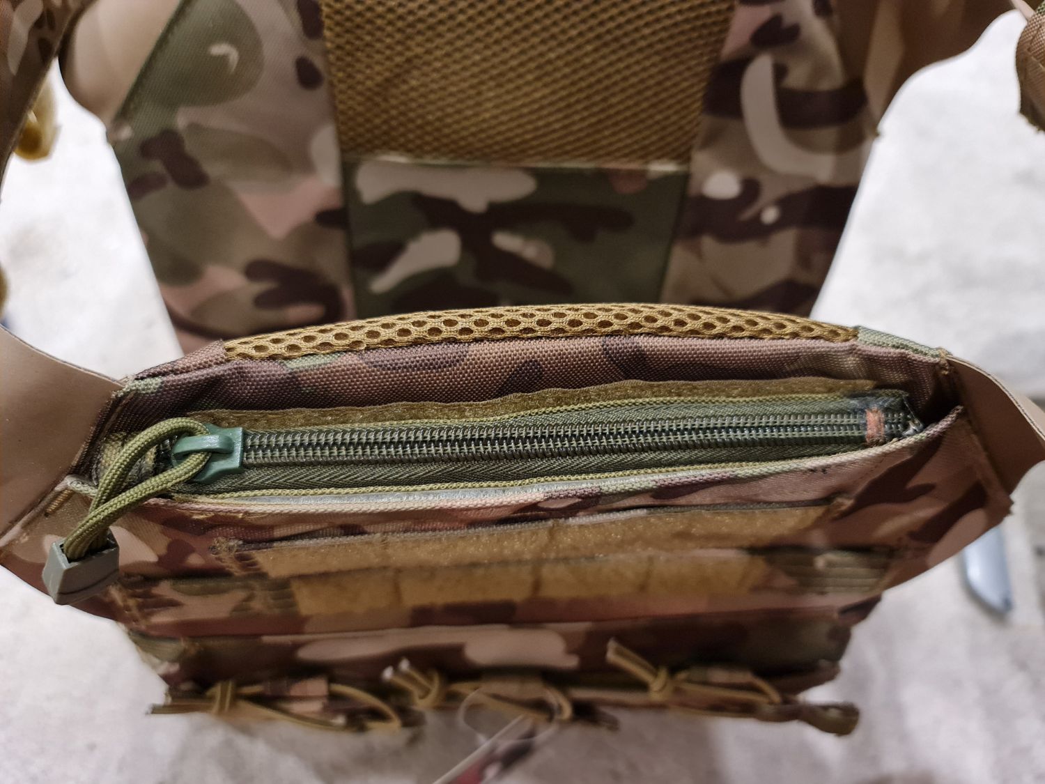

And this is after;
Hopefully this helps somebody!
I would probably have used dark velcro if I had some but honestly you can't see it, I've shown in the picture you need to peer down my chin(s) to see it, but you can just stick the zipper mod down lower in the JPC's pouch to make it non-visable.
