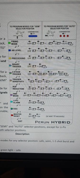

Speedbird_666 Posted March 15, 2021 Posted March 15, 2021 Looks like it's got quite a bit of new functionality. If the price is right - a Gate Titan killer perhaps? and without the paid-for Firmware 'Upgrades' that Gate like to charge you for. Very interesting. Lucky bugger....?
Misery Posted March 15, 2021 Author Posted March 15, 2021 Deffi knowing perun reckon will be same price as the v2 optical maybe slightly more but deffo under price of a basic titan That it is.gd old cyma to thank there trigger fecked my original

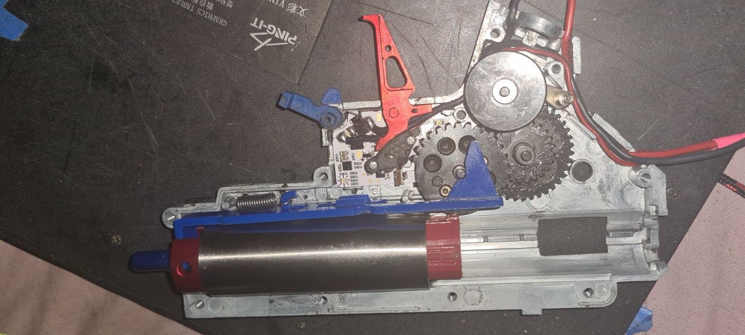

Misery Posted March 15, 2021 Author Posted March 15, 2021 and shes in boy this ones a bit diffrent for fitting u have to try it with just trigger and spur put it in receiver check it senses the sector trigger and selector then build it up fully
Misery Posted March 16, 2021 Author Posted March 16, 2021 @Sitting Duck she's alive she's alive Deffo a speed wanker gun on 11.1 without rof adjustment lol 7.4 is still pretty decent aswell 20210316_030101.mp4 VID_24490331_142017_183.mp4 VID_25000807_014440_062.mp4
Supporters Sitting Duck Posted March 16, 2021 Supporters Posted March 16, 2021 18 hours ago, miserydrift said: and shes in boy this ones a bit diffrent for fitting u have to try it with just trigger and spur put it in receiver check it senses the sector trigger and selector then build it up fully jeeez my neck hurts looking at Australian builds... (rotate pic next time - pretty please) niiiiiiiccceeeeee btw
Misery Posted March 16, 2021 Author Posted March 16, 2021 sorry bout that bro they were right way round when i uploaded it god knows wat happend thanks man wouldnt of been possible without you and @Adolf Hamster's guidence!!

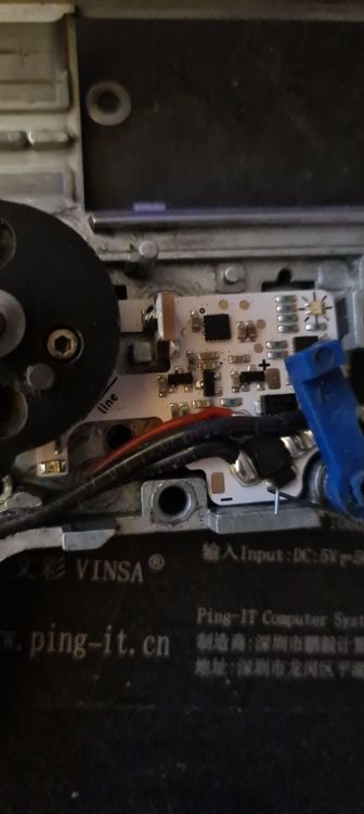

Speedbird_666 Posted March 16, 2021 Posted March 16, 2021 Very nice @miserydrift Is this bit clamped to the trigger? I don't see any screw holes around the board. Waaait a minute - are they using a hall effect sensor now? Is that a magnet on the trigger?
Supporters Adolf Hamster Posted March 16, 2021 Supporters Posted March 16, 2021 that doesn't sound half bad, are you gonna have a crack at setting up the precocking?
Misery Posted March 16, 2021 Author Posted March 16, 2021 soz miussread your comment hamster,yeah i will be messing bout witht hat in a bit when get to wifes so can do bit of target practice havent fired a bb through it yet lol @Speedbird_666 its a magnet bud screws into the hole thats under the sector gear for the old latch that was there cant mind the name of it lol
Supporters Adolf Hamster Posted March 16, 2021 Supporters Posted March 16, 2021 yeah, with the precocking setup on 7.4 that's gonna be pretty sweet. so how long before the lad's gun is getting the same treatment

DerDer Posted March 16, 2021 Posted March 16, 2021 That's interesting as regards the magnets. There was a company a while back (Grizzly I think?) that were using some magnet based solutions on their mosfets. From what I remember the build quality left a bit to be desired. Fair play to Perun, certainly a manufacturer to watch.
Speedbird_666 Posted March 16, 2021 Posted March 16, 2021 57 minutes ago, DerDer said: That's interesting as regards the magnets. There was a company a while back (Grizzly I think?) that were using some magnet based solutions on their mosfets. From what I remember the build quality left a bit to be desired. Fair play to Perun, certainly a manufacturer to watch. Hall effect sensors are not really new to shooting sports - There was a paintball gun that used them on their triggers back in 2001 - the Airgun Designs E-Mag. God, I wanted one so bad back in the day - if you think Airsoft is an expensive sport.... I really like what I've seen and heard about Perun so far: excellent customer service, reasonable prices and constantly innovating with interesting products. I just picked up a Combat Machine with ETU, I'll be ordering a Perun ETU++ before the gun is fielded for the first time.
