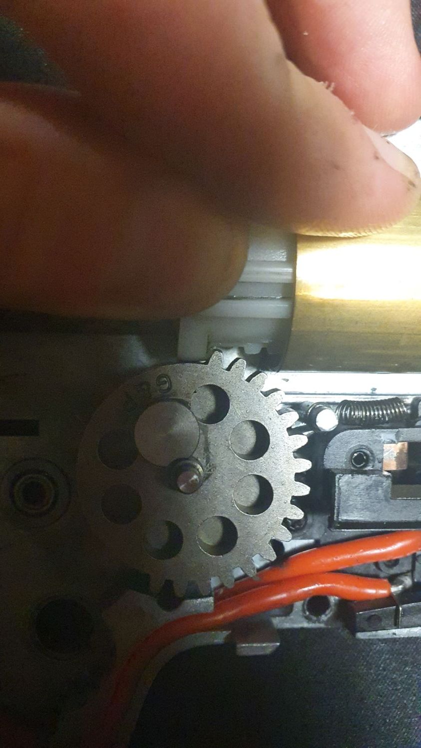

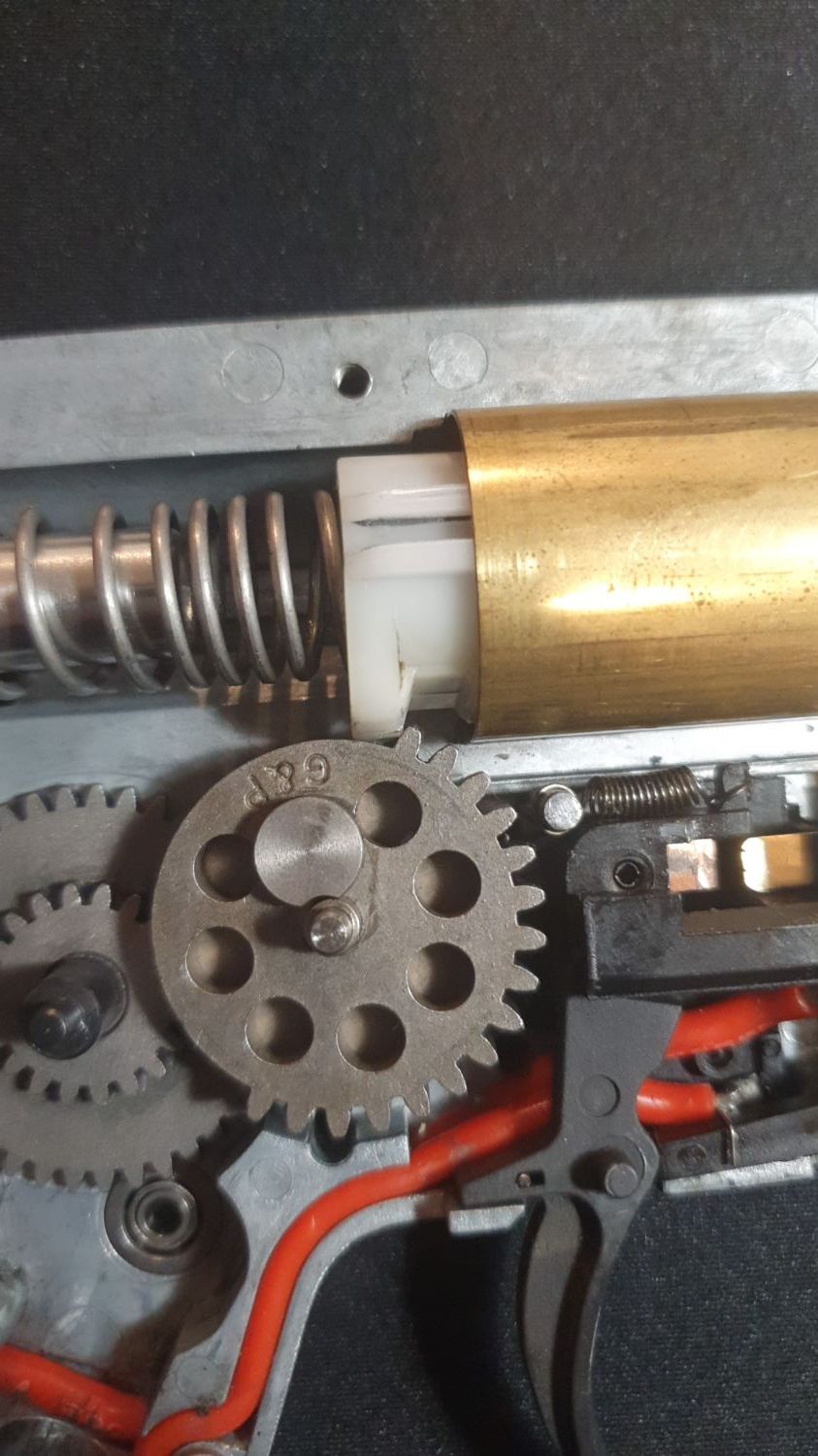

Just Joe Posted December 15, 2020 Author Posted December 15, 2020 So I just got in, I tried putting every shim i had that came out the AEG onto the bevel gear to negate any play. I had no idea what the size of these shims are though. Hopefully you will see what I mean from this video. It still moves but is better then before. 20201215_174917.mp4 Couple of images of present AOE. And a video. Piston and the sector gear seem to have a very small gap between them. The none pick up side of the gear doesn't look all that round. 20201215_175327.mp4 Video of one of the bearings, this is how I would presume they would all fit If any further videos would help let me know 20201215_175902.mp4 If this aster gate is good I will continue with that. I'm sure with enough patience I'll be able to get it in. First thing for me would be to rebuild this gear box with appropriate shimming
Supporters Sitting Duck Posted December 15, 2020 Supporters Posted December 15, 2020 I assume 2 things... I hope you fixed the sorbo pad FIRST, then the more robust rubber pad on top (else the sorbo will shred to bits very quickly) If you are going to short stroke - you might need a metal rack or part metal rack piston (still plastic, but teeth should be say half metal at least for SS-ing) also that white piston appears to be plastic teeth... I hope you have it part metal with the last few teeth or a 50/50 mix coz you will need the final tooth that releases to be of metal than plastic it will work - but the last tooth or two should be metal to ensure durability long term
