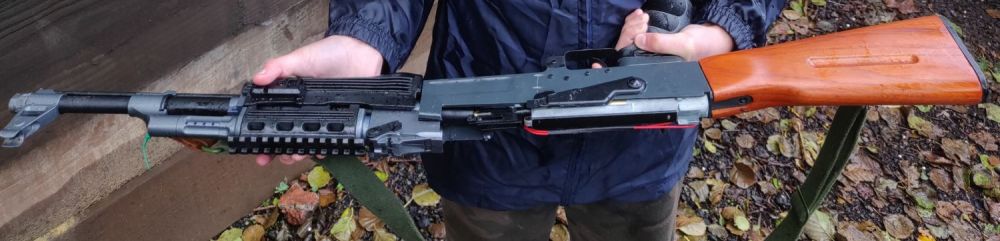

Hi,
Unfortunately I fell on top of my Cyma CM028 during an airsoft skirmish at the weekend and it broke the body and enclosure that goes around the hop up.The barrel is also bent.
I have a replacement body but not sure if the hop up body or barrel are replaceable or where to source them from.
Can I just bend the barrel back or just shorten it to cut out the bent section?
Is it a write off or can it be repaired?

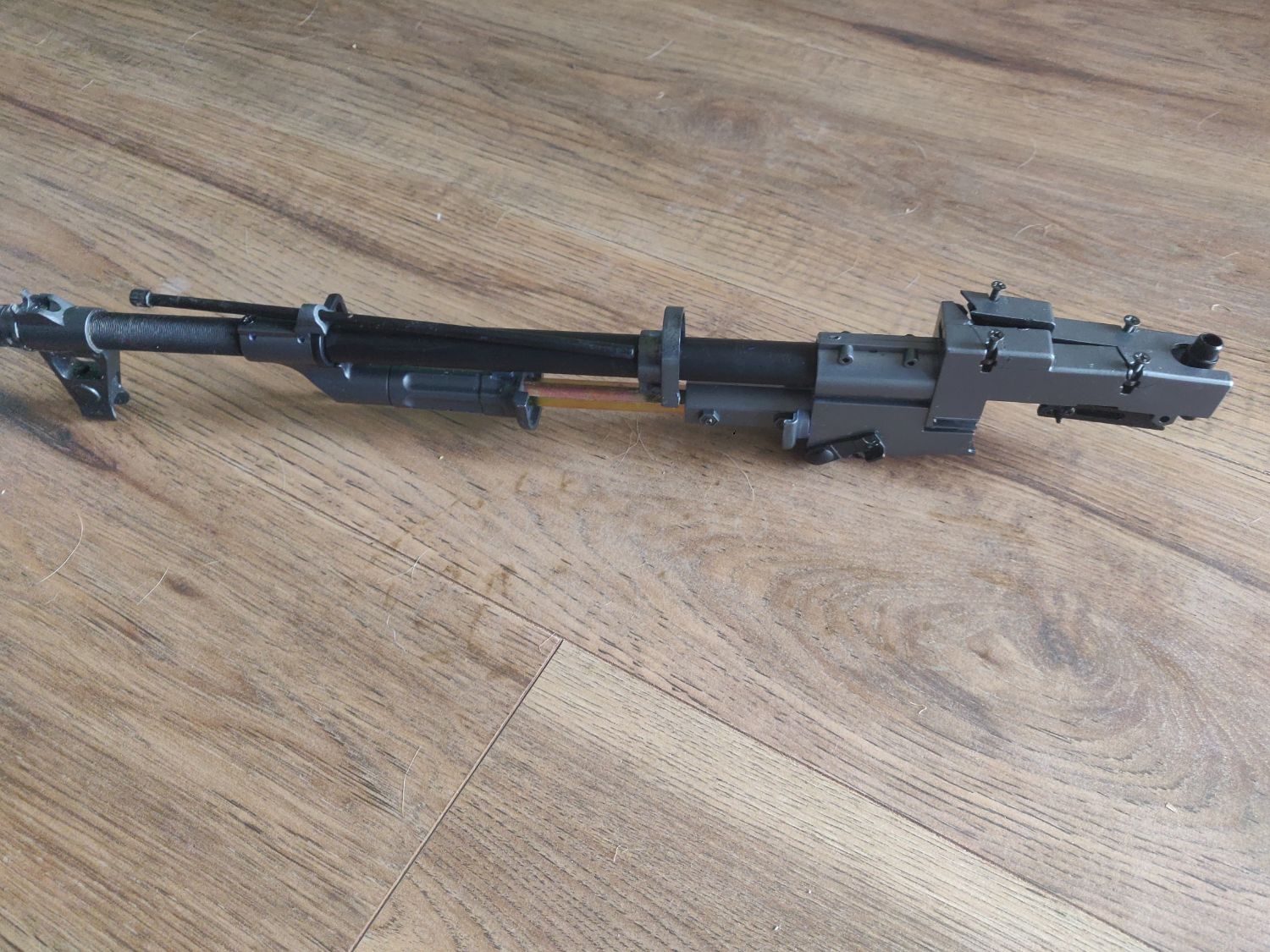

Inner barrels are easily replaceable, so that'd be a simple job and not massively expensive (dependant on what barrel you'd go for obviously), hell someone might part with their old stock brass barrel for pennies after they've done an upgrade. You could attempt to bend it back but it won't end up being as straight as it was when it was manufactured (say goodbye to accuracy) - better off with new or second hand there rather than repairing.
As for the hop unit enclosure, that looks very much one piece I doubt you'll be able to sort readily available external/body spares for an entry level CYMA in the UK or Europe. That is very much just speculation and a quick google on my part, though I've never seen externals for a TM clone cutting about in my years looking. It looks a bit more repairable (potentially just a bit of bending, though can't really see anything else from the screenies) - might be worth having a go, you'd have nothing to lose really.
Honestly though for the cost/time you'd be putting in, compared to the price of the gun or similar models, I think you're better off looking for something new. The CM.028s are old tech, based on TM spec guns from years ago and have moved on. For not much more than they cost you get a CYMA based on the VFC rifles which are easier to disassemble and built a lot more solidly.
Unlucky mate.  (Not saying it was the cause but falling on your weapon is the reason I don't use a sling in a game)
As Shaydee said, you can't bend the the inner barrel straight but not a problem to replace for £10-20  (look for same length)
Unfortunately the rest isn't so easy.
The main problem I can see from the pics is the broken rear end housing. (Top pic, right side)
If you're going to go for a repair then try and stick it together with some JBWeld or other liquid metal adhesive and see how it goes.
When you get the new barrel and put the hop unit on, make sure it aligns properly with the air nozzle.
That's assuming there aren't any other broken/bent parts.
To be honest it does look like a new gat will be in your future.

@emit deffo have a look at trying to bend the hop structure back in. Bending the barrel back would most probably end up in something not perfectly straight and BBs bouncing off walls - perhaps see if anyone at your local site has got a spare stock barrel going handy, odds are someone'll have one lying about that they don't need you could have for cheap. You can afford to go a bit shorter, you'll just lose out on some FPS and be a bit overvolumed, but nothing that's going to be massively noticeable from the stock gun. Wouldn't be any worse than it is currently at the very least!

Grab a new barrel, try the JB Weld option - worth a go

What you could do is fit a plate 30mm x 45mm to the front pair of screws
so that it binds the crack together - can't fit a plate to the rear scews coz it's where mag goes - duuhhh
But you could bind a plate to the front screws

So you could add one of those scope mounts, that would help bind & reinforce it a bit more

yeah, with a plate of some sort or mount, then JB the cracked stuff
altogether I reckon it can be bodged up to work again as a 455mm AK once more
and work fairly well if done properly with plate/mount as I suggested

So with a plate/scope mount, epoxy/JB Weld the cracks, the repair option is looking a bit more viable
and yes, with a strengthening plate & epoxy the cracks - I reckon the project is worth a go

I mean a plate will work, say 1mm thick, 2 holes drilled and the screws should be long enough as is
it isn't going to make it as good as new & the epoxy can crack or go, especially if it gets wet & whacked on field
but the plate will assist the repair in holding and should squeeze a bit more life out of the repair project
