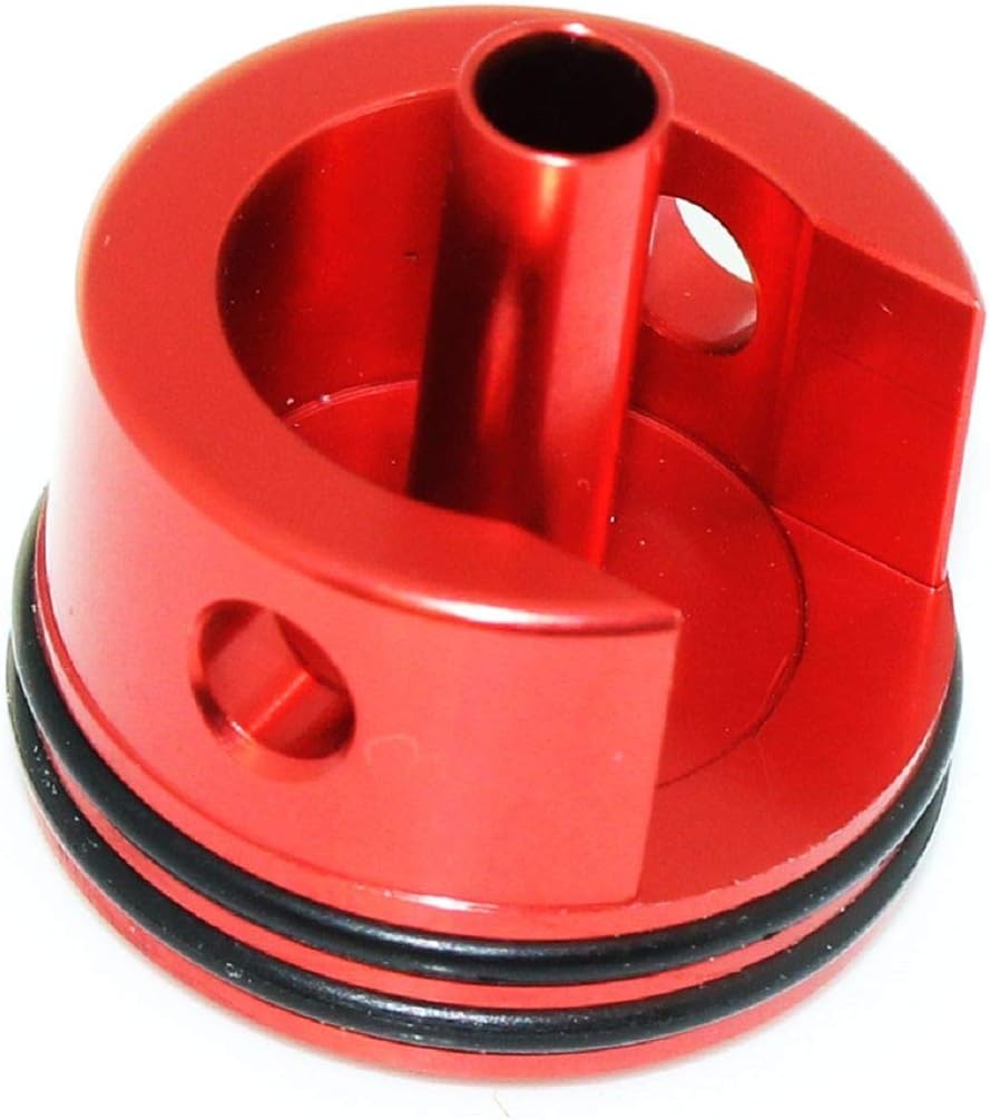

Feed problems - bet it is nozzle retraction
or part of the issue
Add delayer - but the CORRECT TYPE
there is a smidge of extra material that just fits over the sector's tappet cam
thus pulling the tappet back a whisker extra more
other delay clips are just shit by comparison...
if you only have a 5.5mm gap in front of the nozzle it will struggle to fee a 5.95mm BB
(no matter how long the tappet/nozzle is held back for
Some mags have a stronger spring and will attempt to force it through with enough force
but won't last 7 maybe why it only feeds 10 BB's if you are lucky
I've covered this before...
But the tappet/nozzle window on V2's is 1mm smaller than on V3's
so you really have to ensure the nozzle length is correct
21.38mm or a SHS Red should do @ 21.40mm if you use a delayer
(or make your own with a sleeve over cam)
SHS v2 tappets also retract a whisker more than most others
But check for bottoming out on cylinder head in top half of box
blah blah blah - said it loads of times
you can even go nutz on a red cylinder head...
Airsoft Shooting Gear SHS Cylinder Head (S Pad) for V2 Gearbox M4 M16 G3  MP5 AEG Gearbox: Amazon.co.uk: Sports & Outdoors
see that ridge at the bottom, file it away (carefully after removing o-rings)
then mark cylinder and file a whisker of the cylinder itself - say 5 o'clock to 7 o'clock
clean up & reassemble...
Now you have an extra 0.5mm to 0.75mm extra retraction space on tappet plate
Again - check tappet plate bottoming out on cylinder head at full retraction
you can gain nearly 1mm more nozzle retraction
BUT pay attention as the sector rotates in top half of box as it goes to draw back the tappet fin
just before it engages the fin you may feel some resistance...
this is a large delayer or sleeve hitting the underside of tappet plate - JUST BEFORE it engages the fin
It is a really tiny area of contact, so on the area just in front of the fin, you may need to lightly file away
some material - not a lot a real fine shave
an area right in front of fin to say 5mm in front, only needing to file off say 0.25m to 0.5mm in most cases
All the checking should be done in the TOP HALF of the box
the lower half just wobbles way too much
so this checking of tappet retraction MUST be done in top half
(which is handy coz all the wiring & shims & crap stays in lower half)
so it is a pretty easy thing to check the sector delay tappet cylinder etc.. - all retracting as much as possible
without it bottoming out on cylinder head or bumping underneath the tappet plate itself
V2's are a wank, not all V2's need the tappet plate filed underneath, but if going nutz for max retraction
then it is quite common if taking the piss on tappet retraction
V3's seem to be more forgiving and retract more by default than v2's
**** SLIGHT WARNING ****
If you have a v2 and are REALLY taking the piss, filing cylinder head & cylinder
massive sleeve to REALLY retract tappet, requiring the underside of tappet shaved
ON A CONVENTIONAL TRIGGER/TROLLEY SWITCH - one thing to watch out for if taking the piss
At FULL TRIGGER PULL, ramming the trolley home, the extra tappet retraction
could damage the tiny nipple/lug on top of trolley where the trolley spring sits
it is supposed to just miss by that groove in the tappet plate underside
Sooooooo - if you are REALLY taking the piss on tappet retraction
you need to extend that trolley channel or groove on the underside
to avoid the trolley spring lug hitting the end of the groove and breaking that nipple clean off
(painful), but I had it happen once & so the channel gets modded/extended to prevent this
It is something that will only happen on CONVENTIONAL TRIGGER if TAKING THE PISS
now on the ARP9 think that is ETU so no trolley to tear off
so no need to worry about extending the trolley channel on the underside of tappet plate
ANYWAY - TL-DR crap as per usual...
you need to ensure the nozzle length is correct, maybe sand the front to help seal a smidge
(doesn't help feeding at all)
then try to go for max possible tappet retraction - the delay DURATION matters little if retraction is small/worn
add delayer/sleeve, check for contact/wear/rubbing blah blah blah to the power of 10 etc...
Hopefully you end up with an extra 0.5mm to 1mm extra retraction
that will assist feeding even on the shittiest of mags at a moderate snappy rate
if you still got feeding issues then the nozzle is too long, hop rubber bucking lips too tight
or the mags are really fucked (no spring tension at all)
But you would have the ability to deduce or work out the main cause by power of elimination
But tappet retraction or nozzle space to feed a bb won't be an issue any more
you look into some of this crap and I assure you, your gun will feed better on almost mag
it is them poxy v2's, the tolerance on tappet window is quite fine, bit of wear on fin
not a great amount of retraction to begin with and you get feed issues on some mags
Some mags might just shift the hop unit slightly forward say 0.4mm and feed like a dream
of course you could shove a thin o-ring or something in front of hop between box/hop
pushing the hop forward and it should feed better - but gain a slight blowing at lips
so fps drops a bit - but should feed better, shifting hop forward nearly half a mil
mega TL-DR - just check tappet retraction in top half of box & look to improve with clip/sleeve etc...
