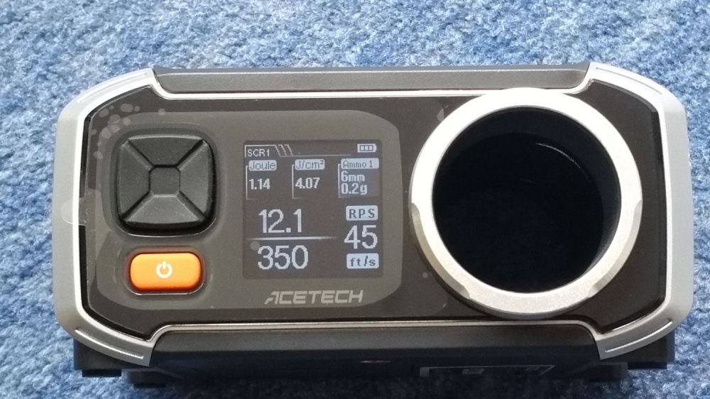

Also my FPS and joules are sitting perfectly after the rebuild, I'm a tad chuffed tbh ?

In the grand scheme of things, saving £5 or so on a motor while spending hundreds of pounds on plastic-and-pot-metal toys which will generally sit in your bag unused isn't such a big deal.
Great job on getting it bang on, although I aim for 340-345fps because of Chinesium definitions of "feet" and "second".
