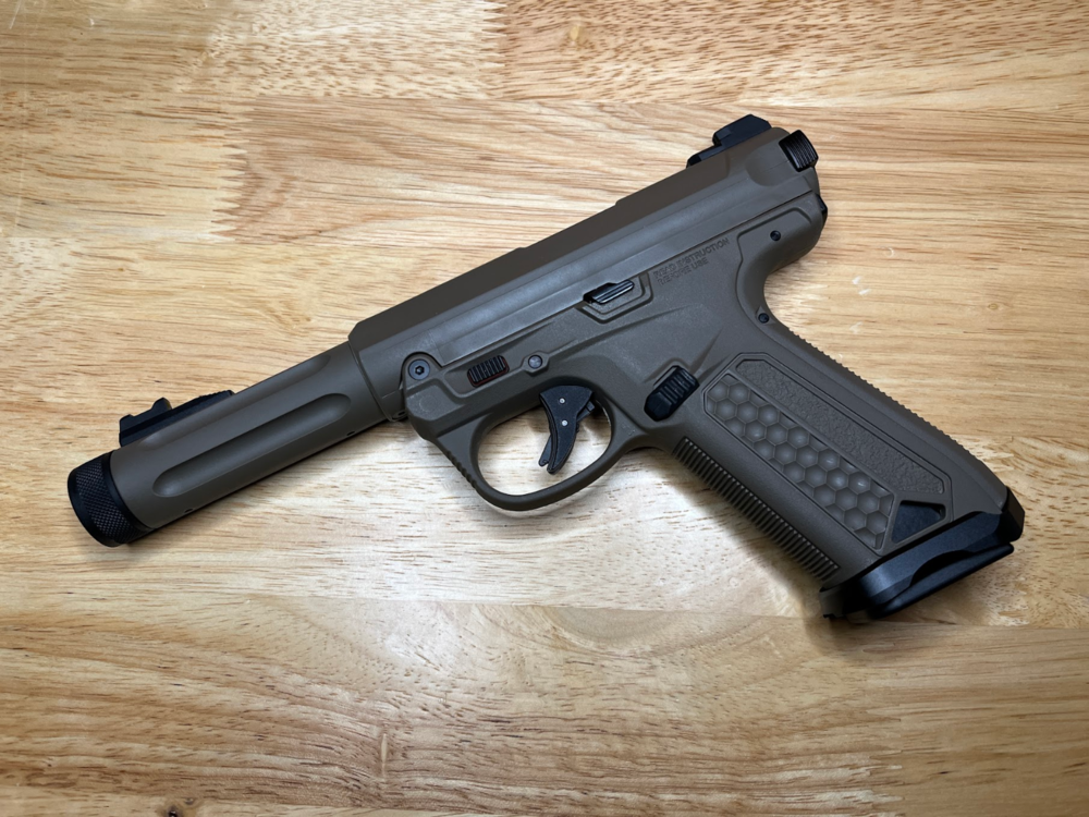

I've had this new one since Friday and so far have installed a CTM trigger and lower (in Ranger Green).
I can see myself getting a new upper and the hop unit at some point...jeez, this is going to be an expensive one isn't it...
