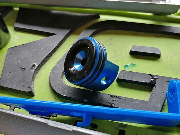

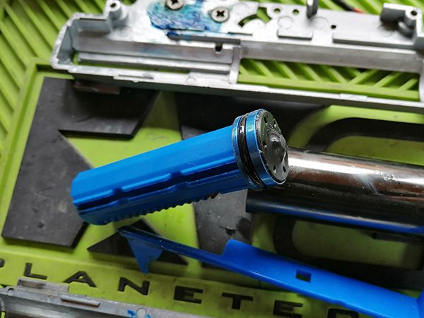

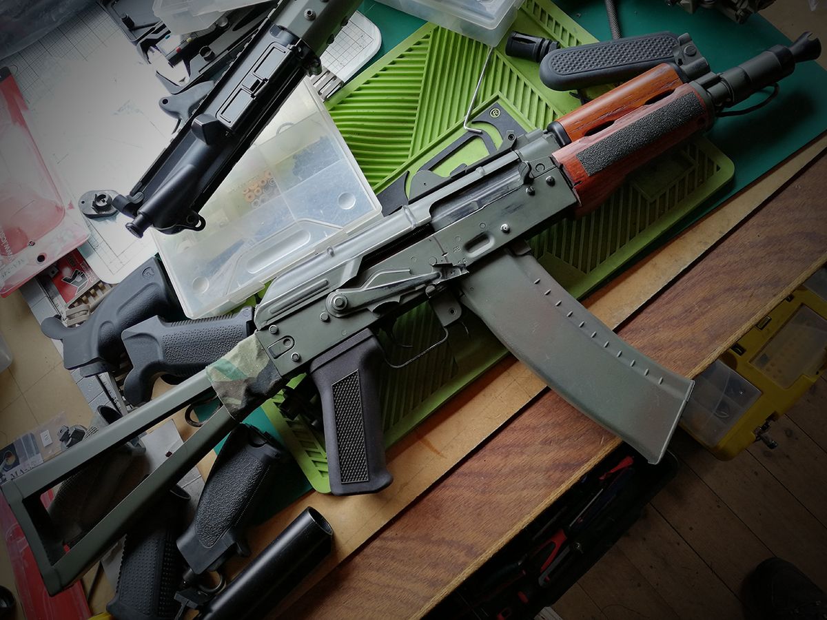

I have one. Not played with it yet, will be used on Sunday for my first post-lockdown skirmish.
The new internals are pretty good - I've no plans to replace anything inside the GB until it breaks. Stock motor is torquey but a little slow (11-12 RPS on 7.4v LiPo).
I have:
- Replaced the hop rubber and nub (had a TM spare)
- Removed the fuse and added deans connector
- Changed the fire selector for this one
- Re-shimmed and re-greased (to be fair it was decent enough on both counts out of the box)
- Rocket 16TPA Hi-Torque
I'm very happy with it so far. Can't comment on longevity yet though.
Pics of the internals.
IMG_20200510_113713.jpg.c49b2ab21581cd93bca8e2bea628205e.jpgIMG_20200510_113731.jpg.13e935f4efd5240a75f3b2dd773c2be9.jpgIMG_20200510_113720.jpg.5328f85566342e7b5053672011187ff9.jpgIMG_20200510_113822.jpg.0dd786d4565cb5b2369a49957994d618.jpgIMG_20200510_115218.jpg.9a003afadd7dfacb33456d596ab79a66.jpgIMG_20200510_113850.jpg.6af02cd72de68bef05bf42d2668d283d.jpg

Do they still have the terrible clear air nozzle or a decent one?
I believe it’s a blue plastic one with no o-ring mate.

Bearing in mind £130 will barely get you a Combat Machine in the UK, the gun is stonking value for money. Is it as nicely made as an LCT? - No, It's less than half the price, but on the other hand it's more than good enough for BB LARPwarz and a great canvas to build something very cool. I Krylon'd mine (shock! Horror!!) because...umm...it seemed like a good idea at the time. I mean, who needs resale value, right?
My gun had a bit of stock wobble (cured with a bit of card on the back of the receiver in the hinge) . Upper hand guard was missing a small self-tapping screw into the wood. Fire selector kept coming loose until I used green Loctite (which is gonna be fun to remove). Small niggles, but easily fixed and I've had worse on far more expensive guns.
I tested the gun with an SHS Hi-Speed motor, 20-22 RPS on a 7.4v LiPo. But the wiring isn't cut out for the amps and the fuse blew within a few seconds of testing. And it ate batteries. I would recommend no more than a 16TPA (SHS or Rocket Hi-Torque is Ideal).
I will probably re-wire at some point with something like a WARFET - but it's not a priority at all. The gun points extremely well and from an ergonomic point of view fits me perfectly. The balance is a bit front-heavy but that's the nature of most AKs. I find it very satisfying to pick up and fondle - more so than M4's of which I own (and have owned) many.
But on the other hand it could shit itself the very first time I use it - at which point I could be coming back here to describe what a pile of wank it is instead.

I had a CM045A pre-blue internals and it was great. If they've improved it in any way then it will be awesome.
Feels like they copied E&L with that mushroom shaped piston head.

Is that what you went with?  The spring looks like it might have been cut and flattened.  Not at all a problem if so[*], I'm just wondering if they're replacing or trimming.
[*] My CYMA M4 came from PatrolBase with the spring cut so short that it was only just barely under tension with the piston forwards. It still shot a consistent 330 fps and the gearbox was doubtless happier to not be under constant stress.
Yeh - I went with the 340FPS version - but you're right, it was just a cut-down spring - it was well done though and the gun is shooting a consistent 345fps.
I reckon they ear-mark a certain number of them per consignment and downgrade ready for those who order as it's a popular model. Mine shipped really quickly after ordering - so I doubt they took it apart between ordering and sending.
Well, all for the best if it's avoiding delays. They have flattened the ends more than mine got, and I've never been convinced by the point of springs that are always under significant compression.  It feels like giving the gearbox a hard time for the sake of it, although I expect there's some reason why they all do it.
