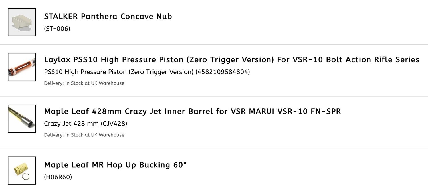

MiK Posted May 26, 2020 Author Posted May 26, 2020 @Hudson @Steveocee am I about right with the list of upgrades ? I’m not buying them now just wanted to to check I’ve got it about right ...
Steveocee Posted May 27, 2020 Posted May 27, 2020 @MiK Looking good, only adjustment I would personally make is swapping the MR hop for an Autobot. The MR has some sealing issues and side by side there is virtually no difference from the Autobot in terms of accuracy (and the auto has been around a while and is a very trusted platform). There is an argument to try a 70 or 75 shore bucking as well. I personally run a 75 in my VSR and it's always been spot on but fully understand why a softer rubber can help. For the price maybe keep a 60 MR and take a punt on the crazy forum guy spouting about 70/75 autobots? ***Do hope we'll get some pics and progress/build pics.
