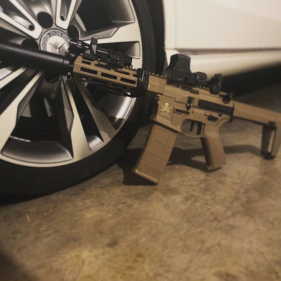

Str8airsoft Posted September 27, 2021 Posted September 27, 2021 (edited) I really do appreciate this forum for open talk and sharing experiences to others as it’s helped me with my build. I have only had this two months and I don’t want to play with anything else. I generally play in CQB environments so low FPS doesn’t really cause an issue however I have had a reduction of FPS and I didn’t know why. When I bought the gun it chrono’d at 350-360 FPS w .20. After a few months and about 40k rounds it started to drop into the 320 range. My local shop tech suggested compression upgrades to stabilize the FPS. I am in the process now. My first upgrade was a 120% spring. It chrono’d at 465/1.77 jz w .20. Let’s just say our field outlawd me and back to the shop I went. I swapped for a 110% spring (quick and easy spring change system) and chrono’d at 392-395 @ 1.4 jz w .20. I plan on mastermod cylinder set and piston. Max HOPUP but can’t find the right bucking to start with. What have you all used and had best results from? Edited September 27, 2021 by Str8airsoft
Moderators Tackle Posted September 27, 2021 Moderators Posted September 27, 2021 5 minutes ago, Str8airsoft said: I really do appreciate this forum for open talk and sharing experiences to others has helped me with my build. I have only had this two months and I don’t want to play with anything else. I generally play in CQB environments so low FPS doesn’t really cause an issue however I have had a reduction of FPS and I didn’t know why. When I bought the gun it chrono’d at 350-360 FPS w .20. After a few months and about 40k rounds it started to drop into the 320 range. My local shop tech suggested compression upgrades to stabilize the FPS. I am in the process now. My first upgrade was a 120% spring. It chrono’d at 465/1.77 jz w .20. Let’s just say our field outlawd me and back to the shop I went. I swapped for a 110% spring (quick and easy spring change system) and chrono’d at 392-395 @ 1.4 jz w .20. I plan on mastermod cylinder set and piston. Max HOPUP but can’t find the right bucking to start with. What have you all used and had best results from? Out of interest were are you located ?, I'm guessing non UK as legally that's too high for UK fields

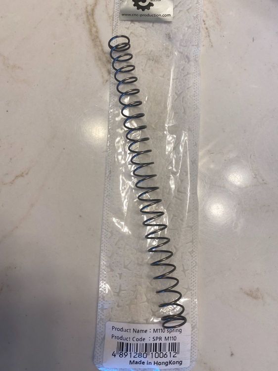

Fatboy40 Posted September 27, 2021 Posted September 27, 2021 39 minutes ago, Tackle said: Out of interest were are you located ?, I'm guessing non UK as legally that's too high for UK fields 100% not UK as you can't get the tan M90X's over here. @Str8airsoft I lost FPS in my M904E as well (same rifle as yours apart from the stock). The problem for me was that the spring in it is a bit cheap and nasty and had compressed over time, losing me around 25 to 30 FPS on 0.20g BBs. A Guarder SP100 spring brought things back to normal (the compressed stock DE spring was 10mm shorter than the Guarder SP100, and the DE spring also did not have tighter coils at one end). Tackle 1
Str8airsoft Posted September 27, 2021 Posted September 27, 2021 (edited) On 27/09/2021 at 12:35, Tackle said: Out of interest were are you located ?, I'm guessing non UK as legally that's too high for UK fields Yes I’m in Tennessee, US. Here they regulate indoor maximum 400fps under 1.5 jz. Semi only no minimum engagement however outdoors can regulate different engagements with caps of 450 depending on the weapon class. Edited September 30, 2021 by Str8airsoft Tackle 1
Str8airsoft Posted September 27, 2021 Posted September 27, 2021 (edited) 9 hours ago, Fatboy40 said: 100% not UK as you can't get the tan M90X's over here. @Str8airsoft I lost FPS in my M904E as well (same rifle as yours apart from the stock). The problem for me was that the spring in it is a bit cheap and nasty and had compressed over time, losing me around 25 to 30 FPS on 0.20g BBs. A Guarder SP100 spring brought things back to normal (the compressed stock DE spring was 10mm shorter than the Guarder SP100, and the DE spring also did not have tighter coils at one end). My spring wasn’t beat but looked cheaper than what I replaced it with. Like your replacement mine was about an inch and a half longer and much darker color as well. I bought mine in June, this is the old spring. Edited September 28, 2021 by Str8airsoft
JVacation Posted September 28, 2021 Posted September 28, 2021 @Fatboy40it's also a cactus jack version of the m904. I believe there are 3 companies currently "making" the same gun. I've noticed a bit of a drop in my fps lately too. Especially with the heavier ammo. Shooting about 0.88j on 28s but 1j on 20s. Let me know how you get on with the spring. Are you still running your oem inner barrel? Str8airsoft 1
Fatboy40 Posted September 28, 2021 Posted September 28, 2021 3 hours ago, JVacation said: @Fatboy40it's also a cactus jack version of the m904. I believe there are 3 companies currently "making" the same gun. I've noticed a bit of a drop in my fps lately too. Especially with the heavier ammo. Shooting about 0.88j on 28s but 1j on 20s. Let me know how you get on with the spring. Are you still running your oem inner barrel? DE also manufacture under the "QAP" brand (which appears to me more prevalent in Japan?), Cactus Jack is a new one on me, thanks for the heads up. The Guarder SP100 has sorted things nicely, and AK2M4 has said that he's noticed hardly any compression of the spring in his own testing (which I think has gone into the tens of thousands of shots). I'm still running the OEM inner barrel, however an ML bucking and nub, and I doubt I'll change it as I'm right at the UK AEG limit FPS wise and with the ML bits my grouping is more than good enough. (I'm hoping to spend my Xmas bonus on an M904F though, build a DMR with it, and that will more than likely get a different inner barrel). Str8airsoft 1

ak2m4 Posted October 7, 2021 Posted October 7, 2021 On 28/09/2021 at 12:25, Fatboy40 said: The Guarder SP100 has sorted things nicely, and AK2M4 has said that he's noticed hardly any compression of the spring in his own testing (which I think has gone into the tens of thousands of shots). Think you've got your springs mixed up buddy, never said that about the Guarder springs. Gearparts springs is where I've done the 200,000 cycle test. Guarder don't even bother to oil their springs from the factory the cheap-skates ? Rogerborg 1
