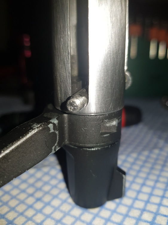

Hazmat Posted May 10, 2020 Posted May 10, 2020 32 minutes ago, Samurai said: Never charge any airsoft spring boltie like in that video. As for the problem. You should find out what exactly stops it from going fully forward. The hop unit, the bucking, something in the receiver or the trigger unit. Take it apart and examine combination without the others. I've had a good look ever it as you said and it seems as though the spring is pushing the actual cylinder out those last 2mm, as there is spring retention on those last 2mm. I might be wrong but it looks like there is a small amount of play between where the body pin and the spring guide sit, if I were to mill out the bottom of the inside of the cylinder, just enough to close the gap so the body pin and spring guide are touching, theoretically it should get ride of the stiff bolt return?
Supporters Samurai Posted May 10, 2020 Supporters Posted May 10, 2020 That doesn't sound right. Don't mill out anything until absolutely sure that's what's needed. If it's like a spring then can't it be pinching the hopup rubber? I meant to take it apart and get the cylinder out, get the hop unit out with the barrel and try to push them together. Or just the bolt with the receiver, but without the barrel and hop. Etc.
Hazmat Posted May 11, 2020 Posted May 11, 2020 On 10/05/2020 at 17:14, Samurai said: That doesn't sound right. Don't mill out anything until absolutely sure that's what's needed. If it's like a spring then can't it be pinching the hopup rubber? I meant to take it apart and get the cylinder out, get the hop unit out with the barrel and try to push them together. Or just the bolt with the receiver, but without the barrel and hop. Etc. I did as you said and took it apart and compared and everything else works together as it should. It's definitely the this gap between where the spring guide sits and the body pin, the pictures probably aren't doing any justice but hopefully you can see what I mean.
Solly4568 Posted May 12, 2020 Author Posted May 12, 2020 Na man it can't be that, think about it you bolt still goes in to the hop unit even if it takes some doing. You not bending metal like that every time. I had a similar problem for a while, put the whole thing back together without the new sear and see if the works, if it does, take a file and drag it across the sides of the sear which is what helped with mine. Don't mill out you bolt they all have a gap like that
