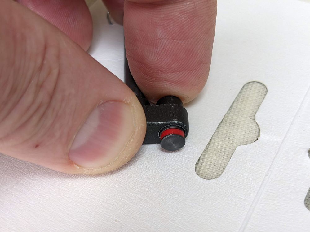

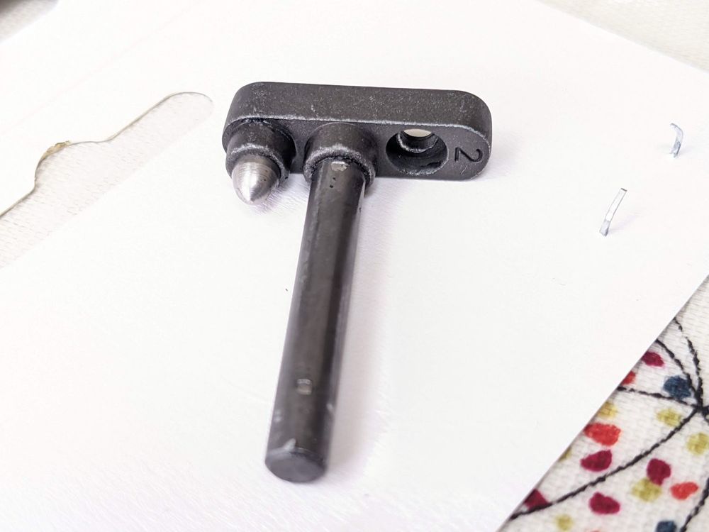

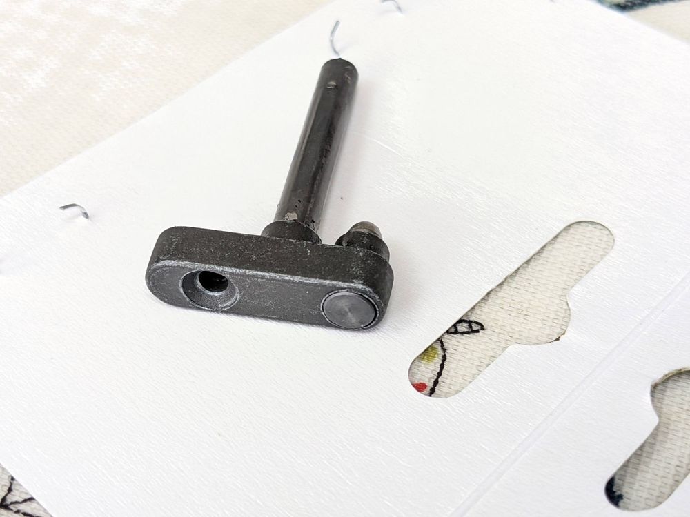

On a related note. I pulled the body pin earlier while familiarising my self with basic field stripping procedure. I notice that on mine the cocking indicator looks nothing like the one I've seen in videos warning against problems caused with using custom cylinders. Have Ares redesigned that part recently? Mine looks nothing like the blade/spring arrangement I see in the videos. It's more like a little silver bullet-point and I can't see how I would begin to attempt to remove it without replacing the entire part (pictures attached for anyone who is interested).
I'm interested in hearing what people who have been there before me would recommend to a first time AS-02 owner.
All tips and info gratefully received
So, yours is the new version with the one piece cylinder, which will save you a fair bit of money!
It still requires a TDC wheel (Action Army makes the best one) because the grub screw has a tendency to unscrew itself with use, then I'd look at a new o-ring for the piston head (it's AEG spec so any AEG o-ring will do), new hop rubber because the stock one is pisspoor quality and, if you can find it, a Gunsmithy hop up arm. You can keep the stock hop chamber because it's decent and seals well.
If you're looking at reducing the sound, I'm afraid there's not much you can do, airbrakes don't really work on this gun and the cylinder volume is barely enough for 0.32s, let alone heavier BBs.
Thanks for the speedy reply mate
I found a site with the AA hop wheels in stock, so I've got one of those on the way. Glad to hear I've got the latest version of the gun. What does a one-piece cylinder do for me? Does that mean that I don't need to worry about replacing it at all, or would an after-market one still be better, but no longer a 'requirement'? Do you have any recommendations for a new hop rubber (assuming I'm only going to replace the rubber and add a TDC wheel)?
I'm not so bothered about the noise as long as the BBs are going where I point them. So what BBs would you recommend? Is it worth going to .3s or .25s or should I just stick with .2s?
Does my new-style body pin mean it would continue to work fine with a custom cylinder, or would I still have to get rid of the cocking indicator for continued smooth operation?
Do you have any recommendations for cleaning the inner barrel? I have heard the best way is to take the inner barrel out of the hop unit and clean it with alcohol rather than any sort of gun oil.
Thanks again
One of the problems the AS01 and 02 had was that the cylinder was made of brass and the butt plate (where the charging handle screws onto) was simply held in place by four small, presumably steel, pins.
The pins being much harder than brass would then carve their way out of the cylinder body, causing catastrophic failures.
A one piece cylinder, as the name suggests, has the cylinder body and butt plate made of a single solid block of metal, which makes it much, much stronger.
Regarding the hop rubber, it's up to you really, when I had mine a simple Maple Leaf Decepticon worked exceptionally well (if you go with concave rubbers you need a concave tensioner, which on the striker implies replacing the hop up arm because it has a very thin integrated one) but there are so many available it's not even fun.
The new design of the cocking indicator should be much better although being Ares I don't really trust them on actually improving something.
