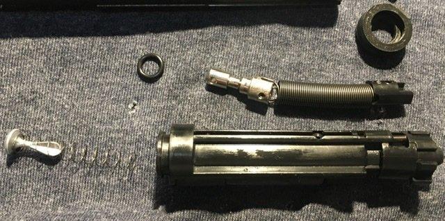

I thought I’ll let you know that after installing a 370mm 6.03 inner and a KWA rocket valve + spring I had laying around from my other projects, the rifle shoots now [email protected] on power up green gas. Seems like a budget power up upgrade. Good thing about it is that the blow back is not much stronger than in stock, so no additional wear and tear.
BTW I’ve bought the rifle for Xmas, got a nice almost unused MWS with 9 mags for £700. I call it a steal.
My upgrades for now are:
- 370mm unbridged vfc psalm 144:1 barrel
- pink autobot bucking
- maple leaf omega nub
- green gas mod on all mags
- DP green sealing buffer
- DP nozzle spring set
I don’t plan on changing it much visually, I like the stock US Army issue form.
