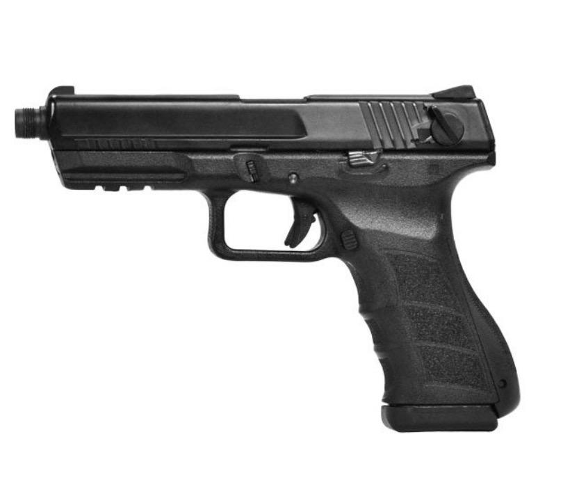

Blakesterb16 Posted July 22 Share Posted July 22 I won a kwa atp series pistol in a raffle along with some kwa brand BBs and green gas. It was working fine for a few minutes but now it won’t fire. When I cock back the gun it loads a bb but when I pull the trigger nothing happens. The bb is also able to fall out the end once I cock it. I need some help. Link to comment Share on other sites More sharing options...
Shamal Posted July 22 Share Posted July 22 Has the mag got any gas in it? Link to comment Share on other sites More sharing options...
JinxDuh Posted July 22 Share Posted July 22 4 minutes ago, Blakesterb16 said: kwa brand I think I found your issue But, if the BB is rolling out the end I would firstly check your hop up and see if you can notice any issues. Link to comment Share on other sites More sharing options...
The_Lord_Poncho Posted July 22 Share Posted July 22 As above, first issue to check is that the mag is fully gassed. Remember to fill the mag with the mag and gas bottle upside down. Link to comment Share on other sites More sharing options...
sonofsammo Posted July 22 Share Posted July 22 Too much hop applied? Link to comment Share on other sites More sharing options...
Blakesterb16 Posted July 22 Author Share Posted July 22 Just to update, I’ve followed all the instructions on the Manuel including loading the BBs and gas properly. Link to comment Share on other sites More sharing options...
novioman Posted July 22 Share Posted July 22 (edited) If the mags gassed o.k, have a look at the nozzle, would advise taking the slide off, is their anything in the nozzle, part of a bb or something. Edited July 22 by novioman Link to comment Share on other sites More sharing options...
theSwede Posted July 24 Share Posted July 24 When you say nothing happens, do you also mean that the slide doesnt cycle? Link to comment Share on other sites More sharing options...
Galvatron Posted July 24 Share Posted July 24 In addition to the points about checking that there are no obvious signs of damage or obstruction, do you feel resistance against the release fill valve when you gently press your thumb against it, just to confirm you are filling the magazine? What kind of gas are you using? Link to comment Share on other sites More sharing options...
Cannonfodder Posted July 24 Share Posted July 24 On 22/07/2024 at 17:25, Blakesterb16 said: The bb is also able to fall out the end once I cock it. If you're cocking it, pulling the trigger and then cocking it again and a bb comes out then you're loading a second bb into the chamber, pushing the first bb past the hop up where it's free to roll out the muzzle Rogerborg 1 Link to comment Share on other sites More sharing options...
Supporters Rogerborg Posted July 26 Supporters Share Posted July 26 On 24/07/2024 at 14:23, Galvatron said: do you feel resistance against the release [...] valve For the avoidance of doubt, that's the valve on the rear of the magazine near the top. And since nothing is working anyway, I'd go ahead and press that firmly in - the mag should vent all of its gas in a way that would normally make you swear like a wounded pirate. But you'll need to check that it's working. SSPKali 1 Link to comment Share on other sites More sharing options...
