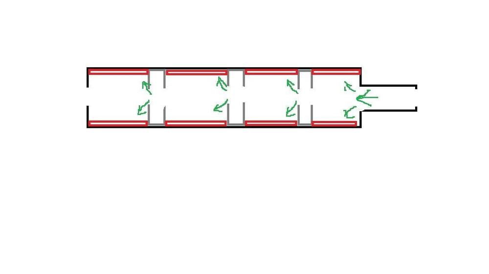

Just theorycrafting here... just a sketch to note down what we have to deal with...
1. Vibration damping: We know the case will resonate and vibrate from any sound from inside (air expansion) and from the barrel (piston impulse) so the case need to be treated to become a composite material so any vibration is deadened rather than resonate, can be achieved with a lining of vibration damping tape or with similar principle
2. Air gap: To limit energy transfer from inside to the case, maybe we can leave an air gap so all the air expansion is contained and processed inside, rather than transferred outside to the case
3. Absorbent material: We need to convert as much sound into kinetic energy as possible at this layer, maybe a heavy and absorbent material, maybe some sort of rubber or silicone or something along those lines
4. Air expansion chamber to match the cylinder volume ~1:1 so the space can be filled with as much absorbent material as possible (for the highest conversion ratio possible), geometry to match the air expansion pattern, and/or optimised for absorption (depending on how the absorbent layer is made). This area probably needs to be towards the back.
5. The "exit tunnel" of the BB should be towards the front so any leftover sound from the air expansion zone can be limited, we just want the BB going out but with minimal air pressure i.e. sound.
TLDR we need to convert the vibrations into heat as much as possible, and we try to do this inside while limiting any transfer to the outside
My thoughts and musings.
Red is Butyl, grey is hard foam or washer, green is sound. I haven't drawn in the barrel, but there should be a taper ( in butyl maybe) from it to the butyl in the first stage.
