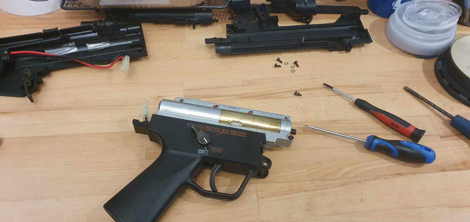

so i strip it all apart... again... getting half ok at this now.
still cant see any reason for it not to move, i reassembled it without the piston and spring (i'd appreciate it if someone could tell me how to release the metal tab that appears to hold the spring in) and clack clack whirring of gears... so... i dunno.

whilst i have no idea how to judge if it needs shimming it's barely done a thousand bbs i reckon but the lube could be getting a bit sticky, so i cleaned it all up and read you need two different types of lube so i used butter and old engine oil.
i've just reassembled it, pulled the trigger....
fuck me dead and bury me pregnant .. it works! :D
i guess it was just the old sticky lube.
it's probably only firing 3fps but its a start.

i'm onto feeding issues now. they seem to get jammed the loading side of the hop up.
after another round of this (as you can see, i dont have any feeding problems) and a little rubber retainer fucking off into another dimension...
i found the problem.
if you had n00b assembly error, you were correct.
i had failed to correctly seat the slidey thing into the skirt of the slidey nozzle which backups the confusion i had that i couldnt depress the nozzle which i was sure i'd seen that positive airsoft fellow do on the youtube.
thank you all again for your help
