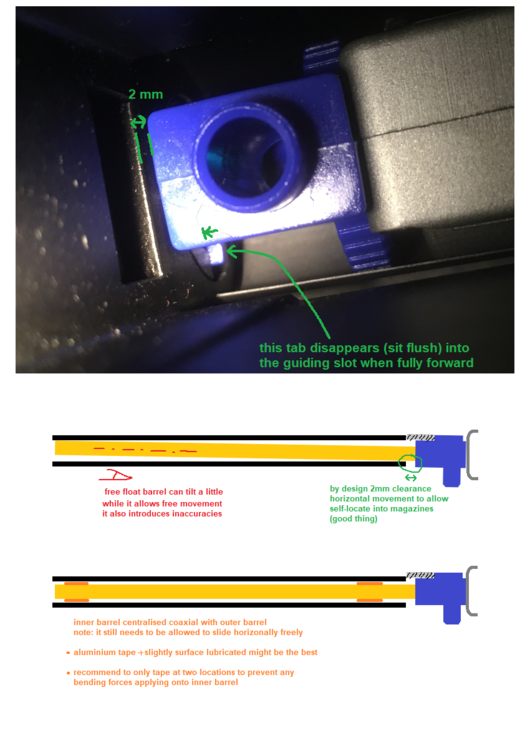

@Rogerborg I got a Specna Edge as well and after tinkering a bit I discovered a few things:
  • The inner barrel assembly is free floating inside the outer barrel and can move freely horizontally in the axial direction.
  • The hop unit is spring loaded on the outer barrel, which pushes it against the gearbox. But when everything is assembled, there is a whole 2 mm of clearance for forward movement, obviously by design for self-locating into magazines. The hop unit feeding tube is chamfered for this purpose (or made more chamfered to improve magazine locating, as you have done).
  • The inner barrel has surprising amount of wobble inside the outer barrel because it is just free floating inside. All these wobble up and down and side to side, and tilting in any direction, is detrimental for self-location into magazines because when the magazine comes in, there is too much room for error and the hop unit can be outside the correct zone for self-location.
  • The inner barrel can be shimmed or "stablised" for better accuracy, but this needs to be allowed to move horizontally without friction for the self-location to work.
  • Similarly the outer barrel can be shimmed on the inside diameter of the upper receiver hole (as opposed to using barrel nut shims to try to hold the barrel in place by sheer friction), to centralise the axis. Besides accuracy, this has added benefit to tightening the guiding slots for the hop unit so there is less chance for the hop unit to rotate axially which again throws off the location of the feeding tube into the magazine.
  • You can test the forward movement of the hop unit by pushing it forward with fingers through the magwell.
Edited by Pseudotectonic
PS I think the air seal issues you are talking about are mainly coming from the misalignments of the axis and all the wobbles and misalignments axially between inner barrel vs outer barrel vs upper receiver vs gearbox nozzle.
I think the horizontal movement is by design and not a major cause of air seal issues. I don't know exactly how much extra mm the nozzle goes beyond the hop rubber sealing lip, but I suspect it should have enough mm to cater for this 2 mm movement by design.
It would be all the tilting that makes the nozzle not coaxial and perpendicular with the hop rubber lip causing air seal issues. If it is aligned and coaxial, it shouldn't matter whether the nozzle is inserted by 3 mm or 1 mm, but I am just theorising here.

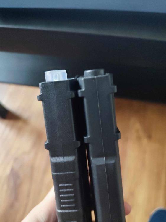

I have tried  holding the mag at different positions and see which works best. It seems that I get less jams (after 10-15 BBs instead of 2-3) when the mag is fully pushed forward. I've wrapped the mag with electrical tape so that it sits more snug inside the magwell.
Also when the RIF stops firing shaking it a little seems to unjam it every time (with or without tape on the mag).
Comparing the battleaxe mid-cap (which is not feeding properly) and my specna arms high cap it seems that the feed tube on the battleaxe mag sits about 1 mm proud. Does it make sense to file it down and get them to match?
Also just to mention that I have tried some of the mags that misfeed in my RIF on my friend's RIF (same model, we actually ordered them together) and they seem to work fine (at least for much longer that mine) but could be due to different tolerances between the two .
I will have to check all the mags that I have problems with on his RIF to make sure.
I've also attached a picture of the magwell maybe you can spot something wrong with it and the two mags in question (on left is the battleaxe one and on the right is specna arms).
Thanks again!
