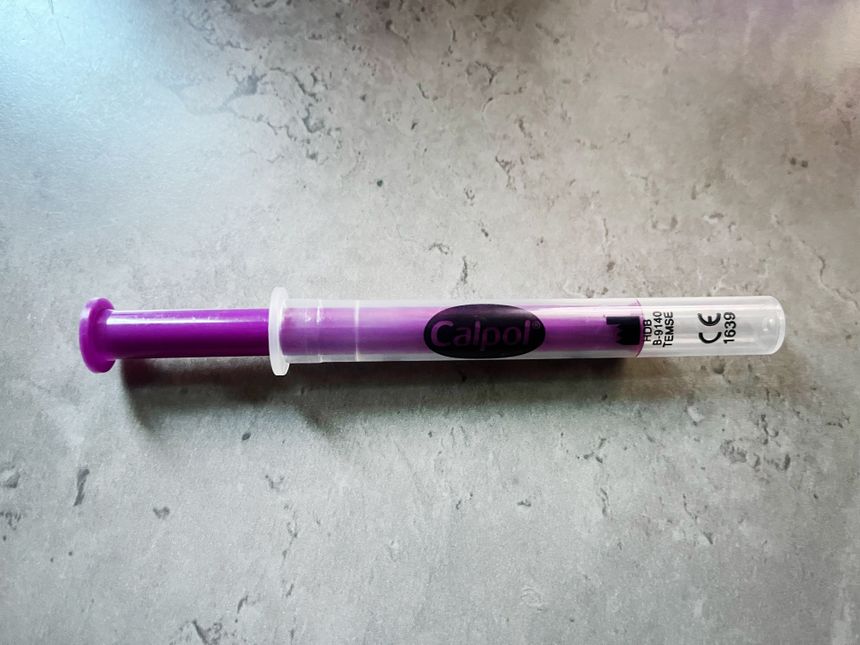

You just need a tube that's approximate the same inner and outer diameter as a hop unit feed tube, i.e. when you push it into the top of the mag, it moves the latch and BBs can feed up it.  A piece of inner barrel works, or any 6mm ID tube with about a 7mm OD.  As a random discovery, I noticed that the purple inner plunger from a small Calpol syringe is hollow inside and has the right dimensions. So I cut the front off one of those and use that now - you can hold your thumb over the end and press it in to release a few BBs at a time, or direct it into a bag or bottle if you're emptying the magazine.
