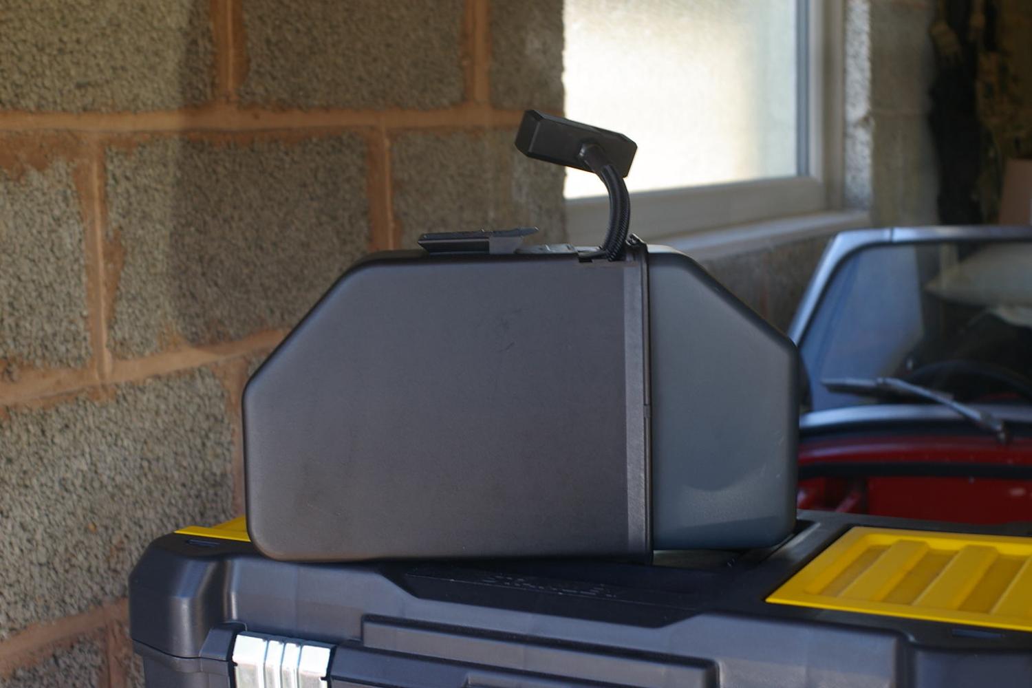

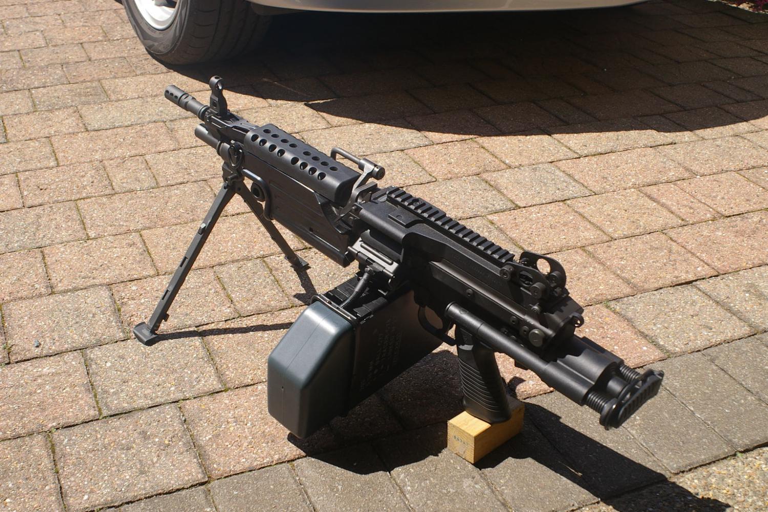

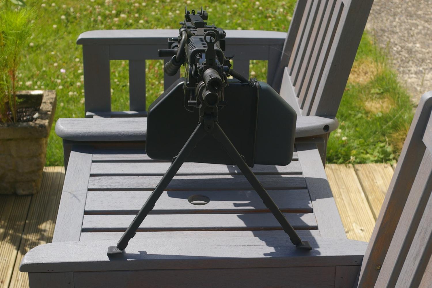

Nick G Posted July 7, 2024 Author Posted July 7, 2024 My solution. End of a spare aeg box mag shell cut off and fitted to the VFC . Uses 3 self tappers to hold it on. CO2 unit fits fine, will need to check if it'll take 2 x 88g ones or not. Basic, functional and not too messy. gavinkempsell, GeorgePlaysAirsoft, rj1986 and 1 other 4
