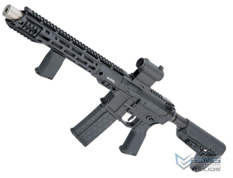

Brand new out the box M4, my first RIF so wanted to keep it basic.  I will be the generic M4 player for a while.
This was 1 of three RIF's bought via Evike. An M4 for me, and a AK and an AUG for my sons, the AK and M4 took just over 5 weeks to get to me from the US via France to the UK...   These where absolutely the RIFS's we wanted, and I mean the way they look.  We did over pay but buy once and cry once was my thought here, at least if they look right then anything else can be fixed or repaired....  or upgraded.

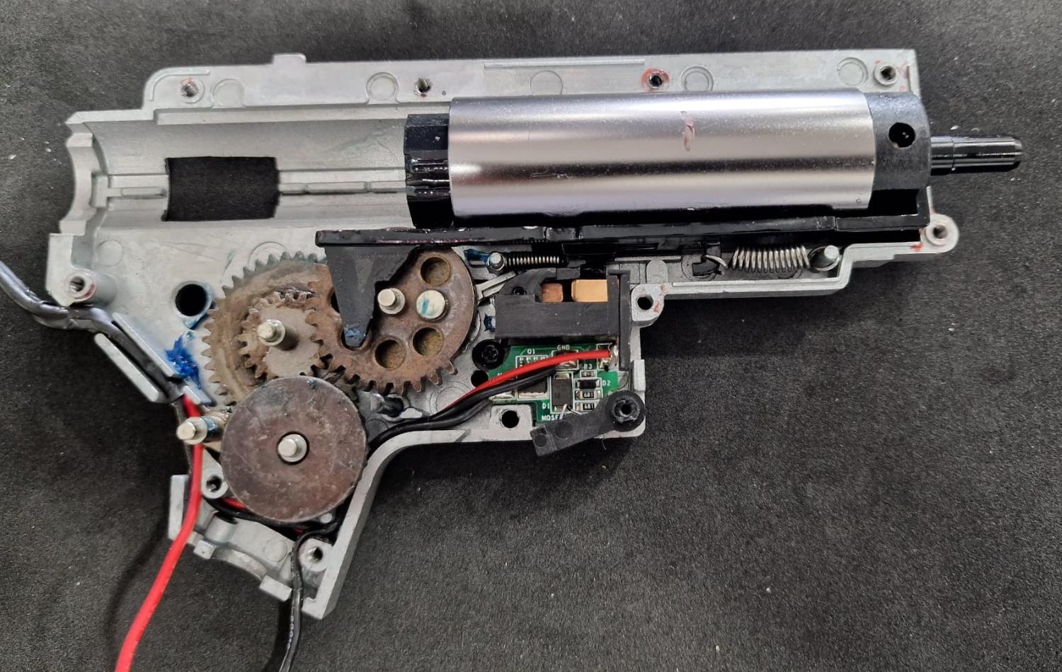

What I found inside was disappointing, the piston O ring swimming in sticky oil/grease so it couldn't expand and seal.   After that was cleaned it sealed inconstantly, air would leak past the cylinder head and was even worse when the nozzle was on.  The gears are also rusty and had no discernible lube on them...  I guess they stuck all they had on the piston head.  All the O rings seem dry/shrunk/flat and I suspect this RIF has been sitting about for a while, but this is only a suspission.

Use steel wool to clean the gears of rust.  (Be careful to remove and keep any shim washers) [Would be best to re-shim anyway]
Use Isopropyl alcohol to clean the grease off and get some new light silicone grease.
Might need a new O-ring for the piston if its old and hard.

The M4 is EMG F4 Defence Licensed F4-15, I don't believe EMG make them but I don't know who does, does anybody?
Gear box is a Dytac Ver.2 QD 8mm w/ Acetech MOSFET.  The GB shell seems pretty good, but it's the first I have seen in the flesh so not sure my opinion counts for much.

Not sure I'm ready for a shimming job yet.    Will fix the air parts first so I can at least use it, then move onto the inner barrel and hop unit.  Then finally look at GB and motor with an ETU, not going DSG but 16:1 or even 13:1 seems doable for me.

EMG stands for Evike Manufacturing Group. A very misleading name as they don't actually manufacture anything, just rebrand ACM guns which means QC can vary wildly

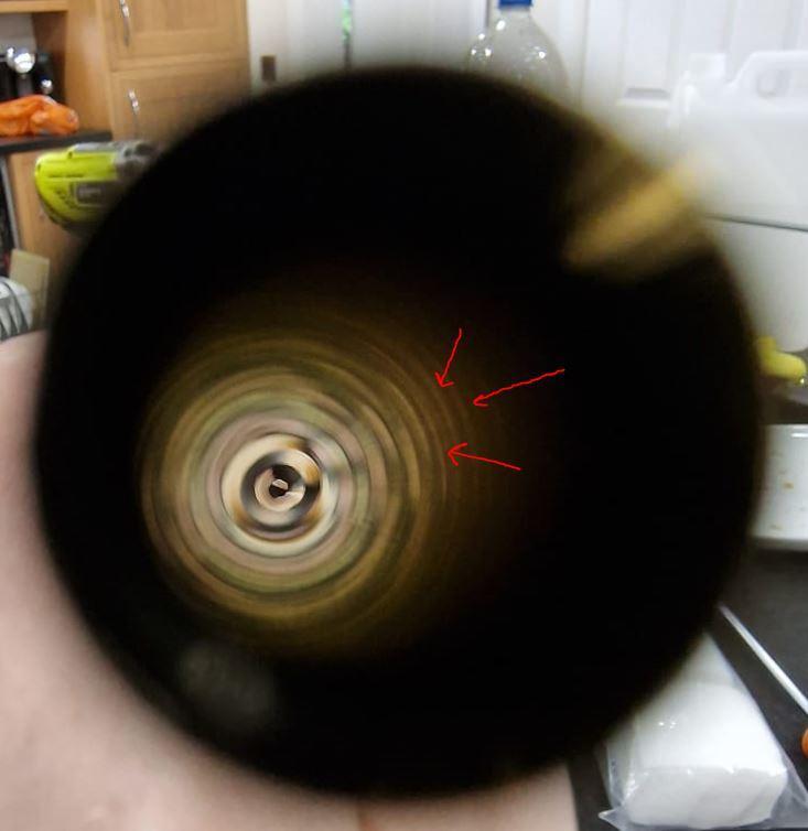

Because I can't leave anything along for very long I cleaned the barrel, I have been waiting on some polish and IPA.
Polish was used to remove oxidation this time only and not to "polish" the barrel, it was then cleaned with the IPA.
Easy to see by eye but next to impossible to picture but there are ridges all the way down the barrel.  I'm pretty much set on buying a new barrel at this point but I don't mind finding justifications to make me feel better about it.
Are these normal? is it further evidence of poor quality?

Other than the funky end of the handguard I'm seeing a Double Eagle M916 ? (but with substantially worse build quality, sorry)
The barrel is difficult to tell. I would work out the other issues and make sure everything is clean and stable before judging the barrel quality. A quick polish can do wonders. DIY stabilization of the unit, hop arm, barrel, etc, will do even more. And a new hop rubber is cheaper and more cost effective than a new barrel (In general. A bad barrel will still ruin your accuracy even if everything else is great.)

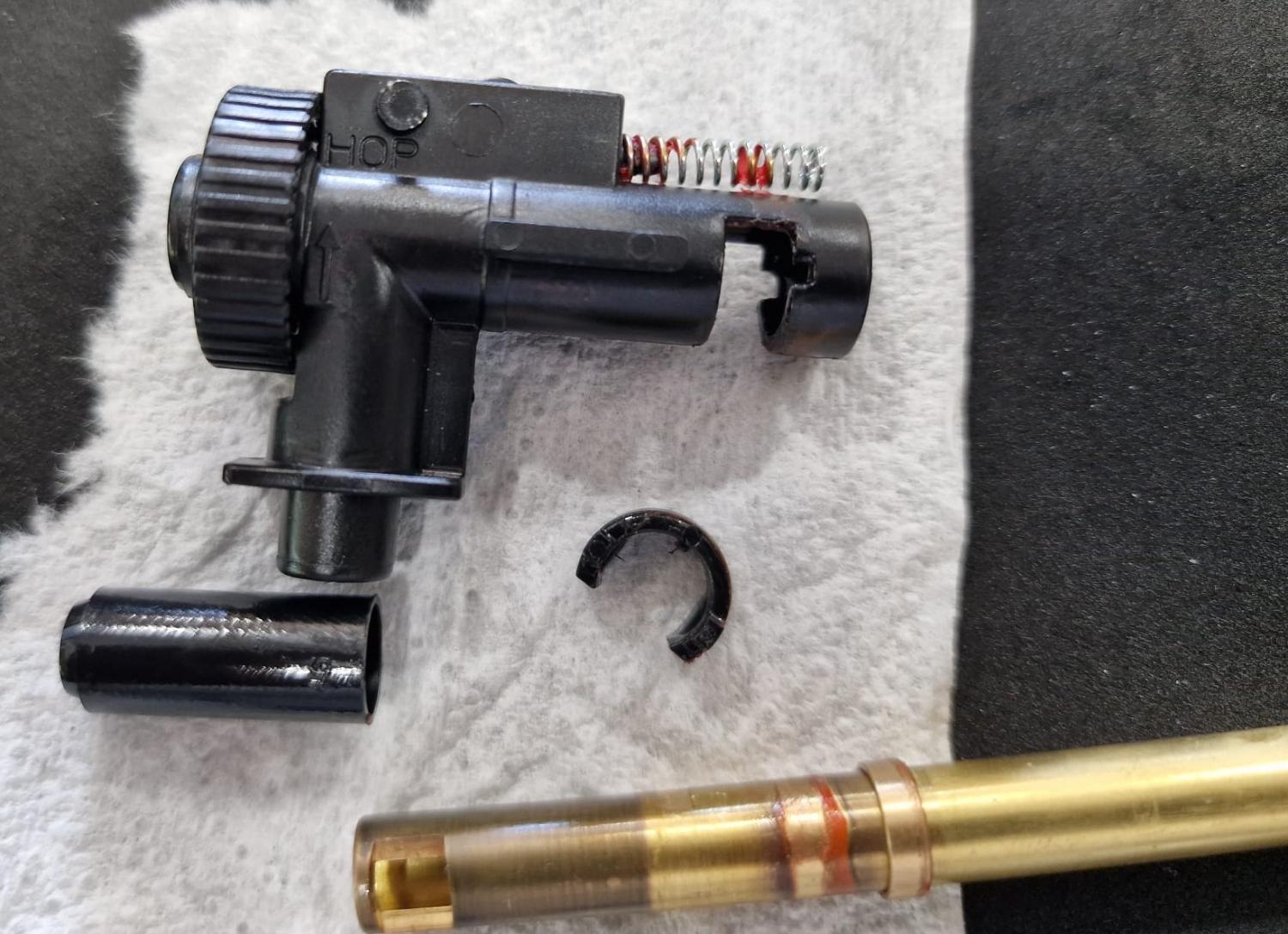

The barrel and hop unit out the box was a bit ruff looking, the olive(brass O ring bit) was held in with what I now know is a kind of thread lock they used as a general purpose filler/glue.  Now I have cleaned it the brass ring just falls out and slides down the barrel...   Anybody know how to hold it in place, or where to buy the glue stuff?

I knew being Evike meant rebranded..  and there was an inherent risk.   But I really liked this design, It was hard to find another I liked the look of that would have had potentially had better QC ....  As much as we all know every M4 looks the same more or less, thanks to Fatboy40's insightful and helpful comments so please don't apologise.
It was exactly the "funky end" that I liked with the M-Loc hand guard... and the more vertical hand grip and the more milled out receiver design and the 45 degree fire selector...  But he is right, all M4's look like the M916 and shame on me for not buying better build quality.
