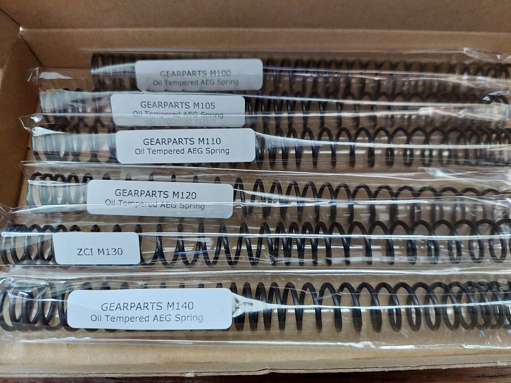

Firstly, thanks to @ak2m4 and his wonderful shop, I am ready to test at all power levels that I might require. I also bought a set of ZCI 18:1 SR-25 gears as I realised that the helical gears I was going to install may not interface properly with the helical bevel/pinion (which is more important) as the teeth on the bevel gear that interacts with the other gear (not the pinion, they're all swirly) are straight, to interact with a normal gear set. Also SR-25 gears are weird because of the longer piston with more teeth, so while you can use regular 18:1 gears, they won't make use of the longer gearbox and therefore have less air to push through the barrel, which affects the cylinder to barrel ratio and defeats the point of using a v2.5 gearbox over a standard v2, and I definitely want to be using the strength of the v2.5 gearbox for this semi-auto sniper build (whether 1.14J, 1.64J or 1.88J). The stock gears are 13:1, which I gather are better for speedyboi full auto builds, so I wanted to swap them out for 18:1 gears for a bit more of a torque-y setup, so I picked them up alongside some extra springs.

To test power (aiming for 1.1J, 1.64J and 1.88J) between GPA m100, m105, m110, m120, m140 and ZCI m130 springs

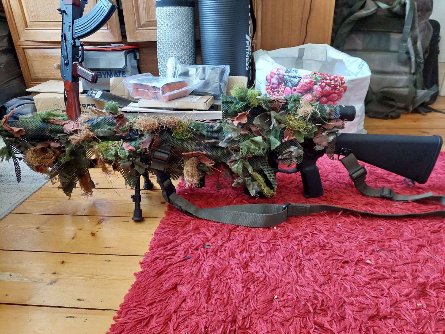

  • Strike Systems 3-9x50mm scope (relatively high scope mounts to accommodate rifle wrap and ability to still mount back-up iron sights)
  • Run on an 11.1v lipo battery with deans connectors
  • Wrapped in a Sprinter Custom Ghillie multi-season rifle wrap
(not getting a picture of it unwrapped because I already wrapped it yesterday and I can't be bothered to remove it!)

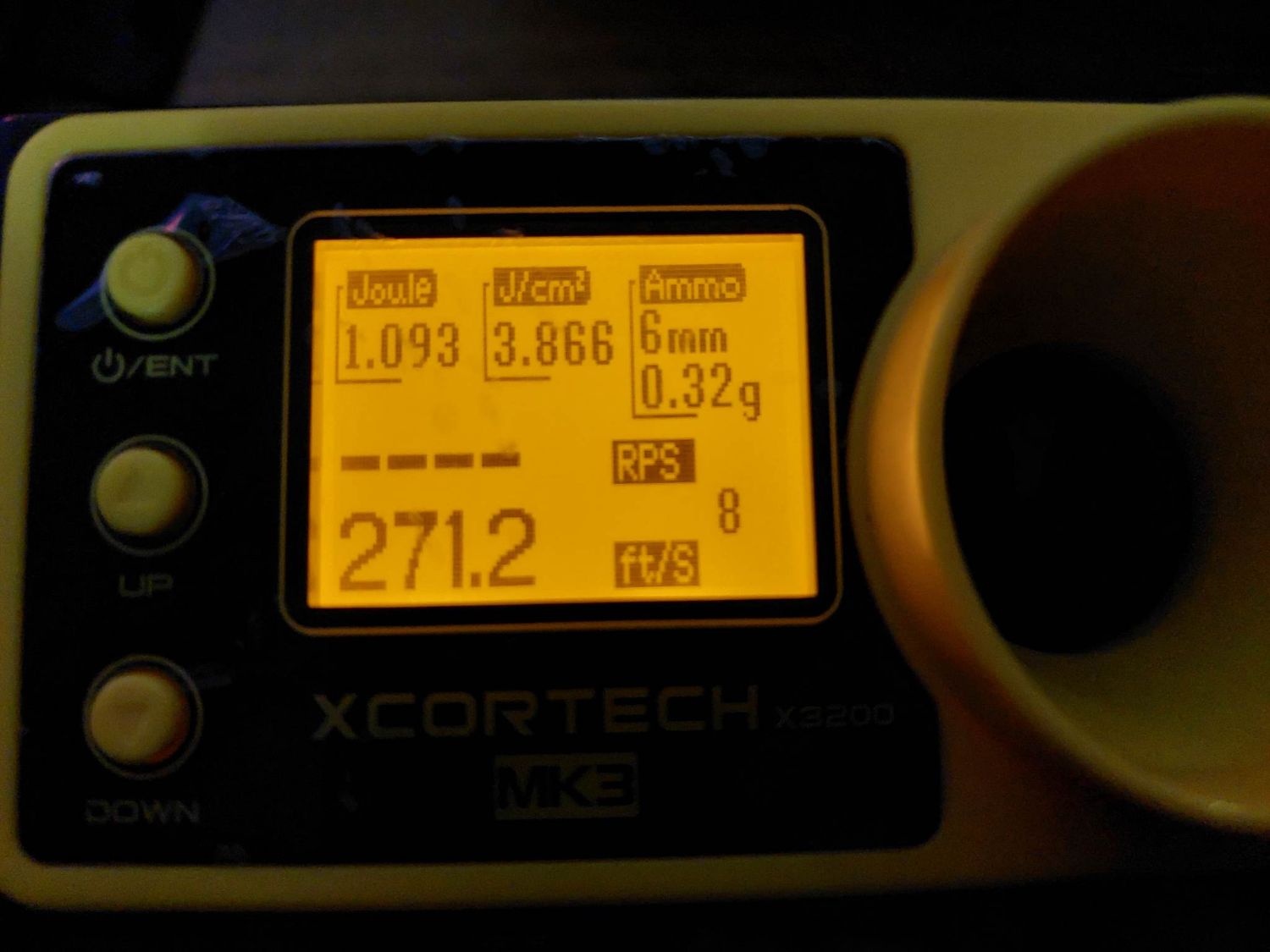

This has it outputting a VERY consistent 1.05J, with the occasional shot dropping as low as 1.02J, on a .32; 1.05J means no MED, so I don't have to worry about people getting too close! The range and accuracy is phenomenal, easily hitting a man-sized target at 60m 7/10 times even with the hop rubber not bedded in yet as I haven't put enough rounds through it yet. I'm hoping once the hop rubber is bedded in I'll be able to up that to 9/10 shots, but time will tell on that. However, the big thing is that it is quiet for an AEG. While testing it on the range, I got my friend to fire it as I made my way down the range to see how it sounded. By 30m I could barely hear it, by 40m I couldn't hear it at all. I then asked him to do the same, but on full-auto: by 40m I could barely hear it, and by 50m I couldn't hear it at all. Is it as quiet as a HPA gun? No, but it's amusingly close, so I think I'll be keeping it as an AEG as not having the line and tank is pretty liberating. Honestly, I'm pretty damn pleased with it.
