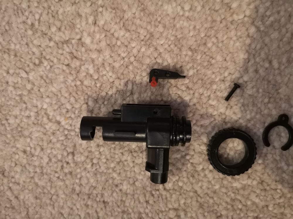

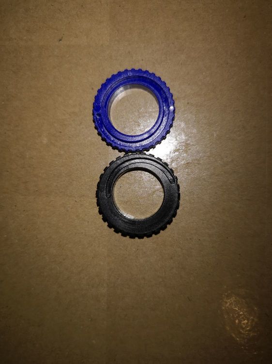

Stevobeavo Posted September 10, 2022 Author Posted September 10, 2022 My little order from AK2M4 came through the post today (great service as always). New 240mm ZCI barrel paired with a gear parts omega nub and a old ML bucking. To finish off they are inside a new ZCI hop up unit. Reason I've upgraded the hop up unit in all my DE guys is for 2 reasons; The first is the arm has a different moulded end and the omega style nub doesn't fit in there properly. Secondly the standard DE hop adjust wheel only has half the adjustment range as the ZCI or similar design (I used a specna arms one for reference). Hopefully now it will lift and fire .30g as well and as far as my other DE guns. BigBell1987, ak2m4 and RostokMcSpoons 3

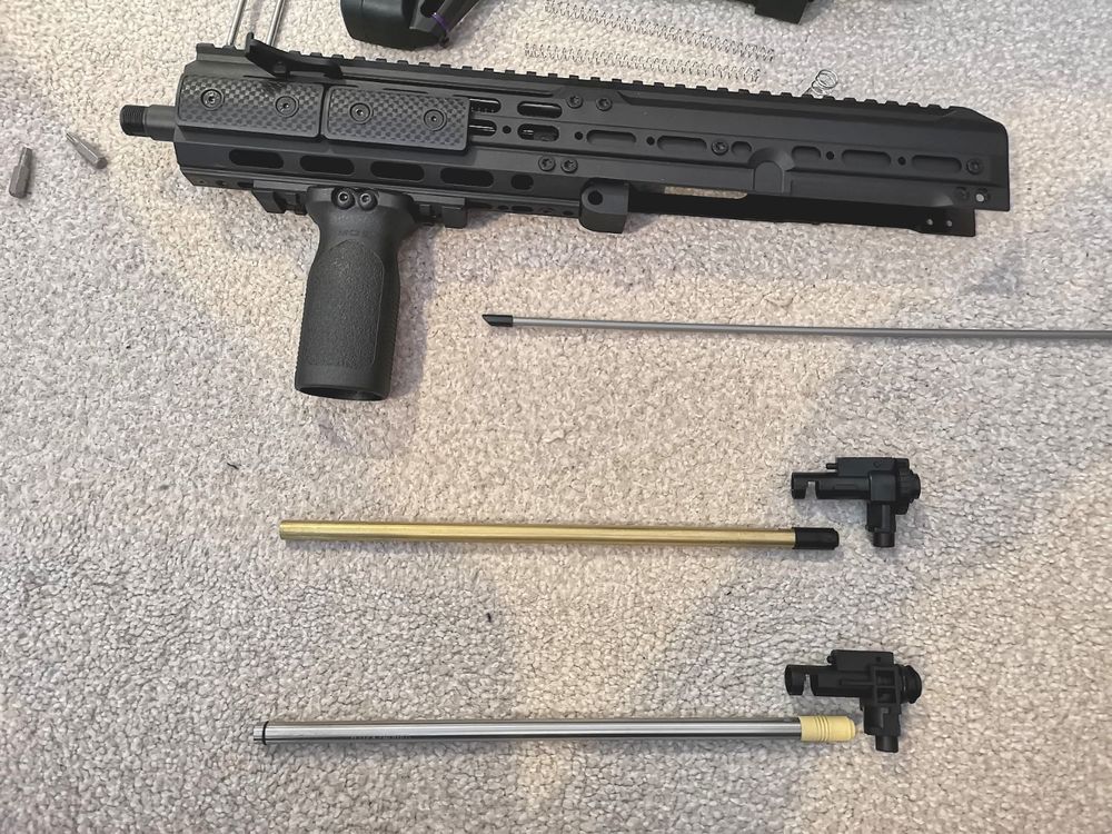

pyromancer6 Posted March 19, 2024 Posted March 19, 2024 On 10/09/2022 at 19:07, Stevobeavo said: My little order from AK2M4 came through the post today (great service as always). New 240mm ZCI barrel paired with a gear parts omega nub and a old ML bucking. To finish off they are inside a new ZCI hop up unit. Reason I've upgraded the hop up unit in all my DE guys is for 2 reasons; The first is the arm has a different moulded end and the omega style nub doesn't fit in there properly. Secondly the standard DE hop adjust wheel only has half the adjustment range as the ZCI or similar design (I used a specna arms one for reference). Hopefully now it will lift and fire .30g as well and as far as my other DE guns. Hate to revive such an old thread, but how did you get your ZCI plastic hop to play nice? I just got your average macaron/zci plastic today (also from AK2M4 lol) and while I've managed to test perfectly fine and get good results, I can't get anything in when it comes to full assembly. Even with just the two metal rods that guide the UTR branded bolt (with no springs, nor the bolt) it prevents me from getting it in as it's getting stuck on something, even after pushing the hop into place like you mentioned. Did you do some fitment?
