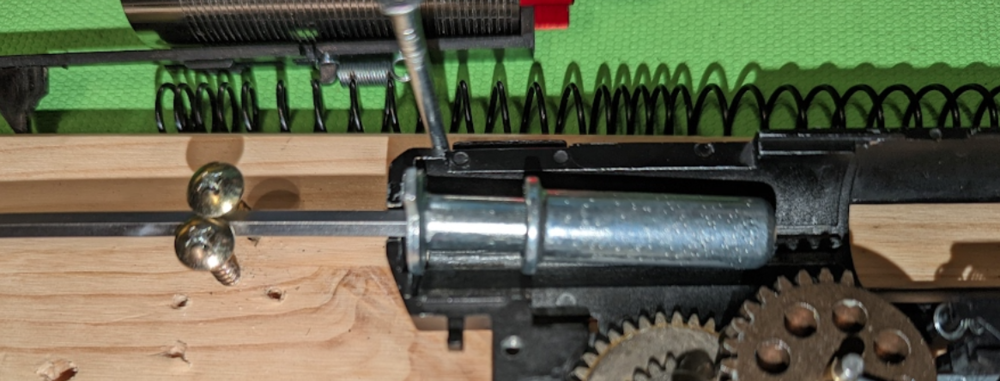

RostokMcSpoons Posted January 1, 2022 Author Posted January 1, 2022 (edited) I might just run the old piston in the new cylinder, see how that pans out. For the interest of any tech-noobs who might read this thread in the future, I amended my jig. A couple of wood screws and an allen key go into the spring guide as I'm assembling the gearbox. I then wedge a screwdriver in under the allen key, to the left of the screws to create a levering force to keep the guide down in the shell, so a single finger of pressure on the cylinder is all that's required to keep things in place while I manipulate the top half and snap it down. (Also used the internal screw to extend the the spring guide to its longest length, to tame the spring from jumping out sideways) Edited January 1, 2022 by RostokMcSpoons Paul72 1
