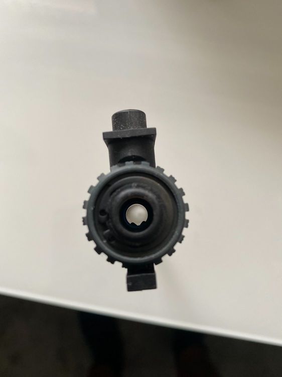

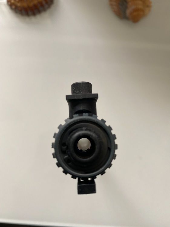

scar1 Posted October 11, 2021 Author Posted October 11, 2021 11 hours ago, Fatboy40 said: That would be the first thing I'd be checking out, I've 100% seen this in the flesh, hop totally "off" but the arm not returning completely so the bucking's patch is still slightly protruding. Sounds like maybe a disassembly and the tiniest drop of silicon oil, maybe apply with a cotton bud / toothpick, either side of the arm and on the pin holding it in place? I’ve taken apart and had a quick look As you can see in the pictures mine pictures one has full hop on and the other full hop off 7 hours ago, Groot said: Take it apart, spend £20 on mapleleaf bucking and omega and put it back together. You wont be unhappy Think that’s what I’ll do when I fully take apart thanks
Supporters Adolf Hamster Posted October 11, 2021 Supporters Posted October 11, 2021 that "off" pic defo looks engaged too far. that said, the "on" pic also looks a bit more than my hazy recollection of the last time i worked on one of those units.
scar1 Posted October 11, 2021 Author Posted October 11, 2021 Yes the off picture is engaged so this k that’s the issue so think I’m going to change it out to maple leaf and nub
Tactical Pith Helmet Posted October 11, 2021 Posted October 11, 2021 G&Gs do this. If you take the hop out and lube it it may free up. Otherwise take it apart, clean, lube and reassemble. An ML is pretty much the uber hop, but the standard green G&G one is fine for .28s, so your .20 should be fine. You may find on stripping that a bit of plastic at the edge of a mould is not smooth, just trim it with a knife. Even after careful reassembly mine would whip .20s into the ether. A ZCI plastic rotary hop sorted matters for less than a tenner.
