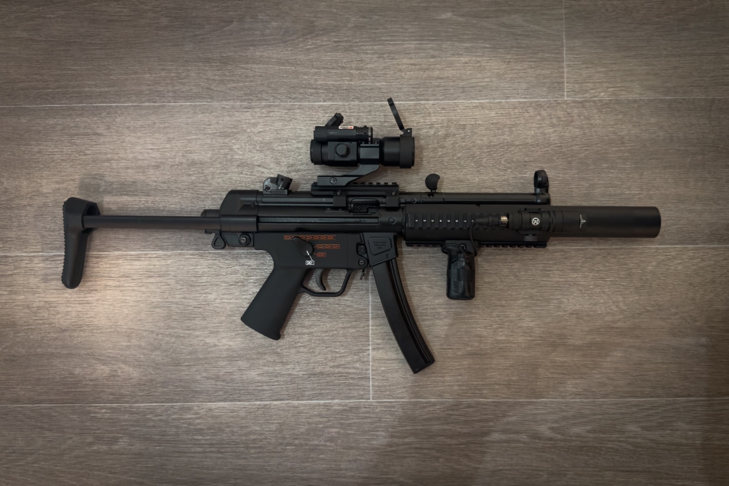

CamboL Posted March 9 Posted March 9 Just picked up my new SD Love it old school and "clean", but an Aimpoint, BT Tri Rail, torch and grip have made me fall in love! TheMeekon, ButcherBill, Mr Dellski and 1 other 4

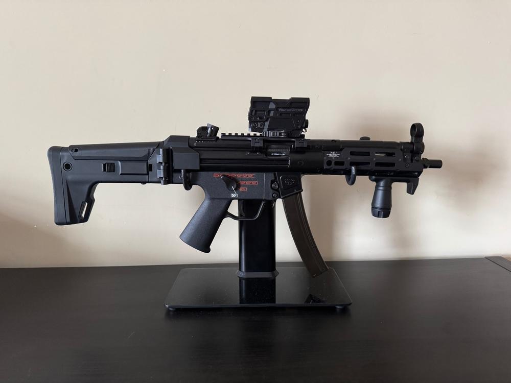

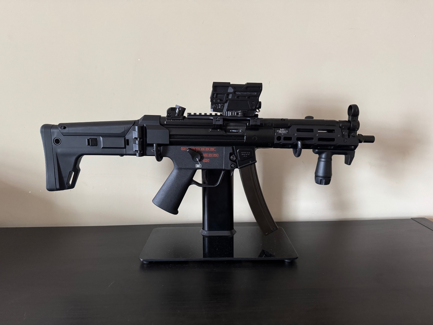

SGSS Posted June 26 Posted June 26 Work in progress. Swapping out this handguard for the Magpul go-to, have the Magpul pistol grip as well to put on. Just need to figure out the least awkward light mounting situation and I think I’m done Cocha, r1flyguy and ButcherBill 1 2
Baser Posted June 26 Posted June 26 3 hours ago, SGSS said: Work in progress. Swapping out this handguard for the Magpul go-to, have the Magpul pistol grip as well to put on. Just need to figure out the least awkward light mounting situation and I think I’m done lovely looking MP5 I have my torch mounted on short piece of ris on the right side of the gun and use my thumb to push the button on the back of the torch rather than trying to find a way to mount the pressure pad. There’s also a longer version of the Cyma foregrip if you find it uncomfortable.
Cocha Posted June 27 Posted June 27 (edited) 13 hours ago, SGSS said: Work in progress. Swapping out this handguard for the Magpul go-to, have the Magpul pistol grip as well to put on. Just need to figure out the least awkward light mounting situation and I think I’m done Amazing build. Did you use the Haga Defence adapter? Edit: typo Edited June 27 by Cocha
