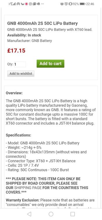

Pewpewpetie Posted August 28, 2021 Author Posted August 28, 2021 40 minutes ago, Adolf Hamster said: Mah and C rating are both ratings where there's no such thing as overkill. pretty much the only downside to having both numbers as high as possible is the cost, and physical size, of the battery pack. So something like this would be more efficient
Supporters Adolf Hamster Posted August 28, 2021 Supporters Posted August 28, 2021 20 minutes ago, Pewpewpetie said: Sorry not great with all the numbers shouldn't the 11.1 1450mah 30c be better then , rather then the 7.4 2000mah 25c? Sorry if that sounds stupid nope, the rated continuous current is the mah divided by 1000, then multiplied by the C rating. 1450/1000=1.45*30=43.5A 2000/1000=2*25=50A now often batteries can sustain more in short bursts, sometimes it's even stated (if you see 2 C ratings on a pack that's what it means) but it's a general guide. 1 minute ago, Pewpewpetie said: So something like this would be more efficient that's a pretty good example, taking the ratings at face value at least. notice how it even specifies a 100C burst current. however also look at the dimensions- its a literal big battery and has the size to match. needless to say this is a problem if, like your gun, battery compartment space is at a premium. wether or not you're happy to run a fake peq box, or change the stock or some other modification to allow you to run a larger battery is up to you. bearing in mind that the overdraw premise is based on the assumption there's nothing wrong with the 2 battery packs you're currently using, you may wish to test in a different gun just to be sure that's not the problem. tbh, given you say you're mostly dealing in 3 round burst rather than auto, it would probably be better to simply change the motor to a ht (slower and less amp draw) then make up for any loss in trigger response (aka lock time) with a mosfet that allows precocking (not sure if the existing one does or not)
