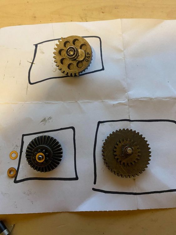

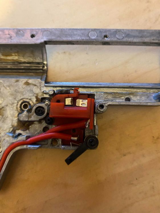

The casing is not damaged, and i will 100% try and rebuild it. Im 99% sure i burnt the trigger out using a powerful battery. so i need to replace that. However i was thinking of upgrading parts. But im not sure what parts would be an upgrade. Ive been told my gearset is pretty good. so was just considering a piston with two seals to give it a bit more compression.

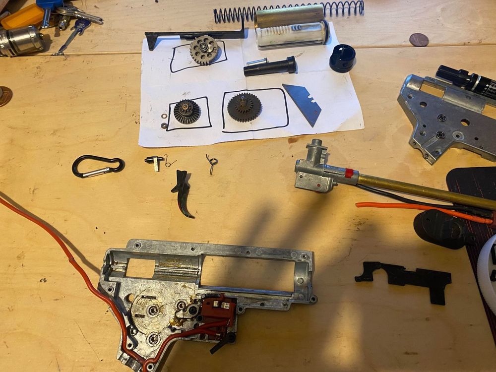

This is what i have...

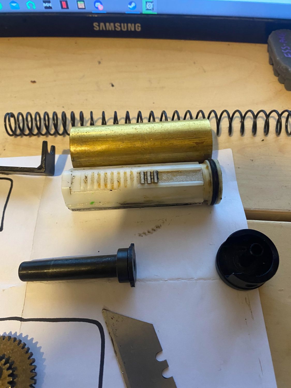

Buying a new complete gearbox doesn't always solve your problems, best to work with the existing shell.  From the pics looks like you just need a new piston, piston head, and selector plate.  You need to test your cylinder head and nozzle.  Grab some metal and silicone lube, some shims.
Never used a Lonex A2 before, my choice would be a SHS high torque motor but there's plenty of others out there.
tbh there doesn't appear to be anything wrong with that gearbox internally that a clean, regrease and the usual air seal/shimming/aoe checks wouldn't solve.
have a look here for a general idea of things to be looking for:
trigger contacts fouling up is very common, a powerful battery will make it happen faster/risk burning them through, but it'll happen to any standard wired gun if used long enough.
the solution to that is a mosfet, either something basic (like the nanoasr) will just protect the contacts or something fancy (eg the warfet) will give you the fancy precocking etc.

it really depends on your priority, wether you just want to get it working or if you want to get her up to a good shooter.
that piston isn't in the worst condition, definately usable but i'd probably look to swap it out anyway, but then i'm obsessed with accuracy so anything less than perfect air seal is a no-go for me.
also perhaps consider treating her to a nice zci 6.02, ml macaron and omega nub.
assuming the gun it came out of is also a g&p then you're looking at a pretty sweet m4 all things considered.

33 minutes ago, kylescave said:
Also could you give me a piston that is compatible. because im struggling to find one with the same amount of teeth. or does that not matter?
the tricky one with piston teeth is often they can have the first tooth removed for engagement.
usually your "standard" is a 15 tooth (https://www.ak2m4.co.uk/internal-parts/pistons/ra-15-tooth-piston), however with the first pickup tooth removed you end up with a 14 tooth (https://www.ak2m4.co.uk/internal-parts/pistons/rocket-14-5-tooth-full-piston)
you can also get the likes of the 14.5 tooth which has only half of the first tooth removed.
that's not to be confused with short-stroking, where teeth from the front of the piston are removed to reduce the distance it travels (teeth are also removed from the sector gear), that's usually done for high speed builds to prevent premature engagement (when the sector spins so fast it goes full circle before the piston has moved all the way forwards).
in general they tend to be pretty standard, although as with all things airsoft sometimes you'll get one that's slightly too wide for a given gearbox which ends up tight. my go-to would be the likes of the shs 14 tooth.
the one that might be tricky is the piston head, i have it rattling around somewhere in my memory that the g&p's are a different bore to standard? it's been a while since i've worked on one so i could be thinking of another brand.
Probably not, unless you stuck a huge battery in it like a 6S.
Your original contacts look decent TBF Just the wires are a little chewed in places.
The reason it probably wasn't shooting is the Selector plate. I linked to that part in the other thread you started without all these little extra nuggets of information. There's a good chance that £5 part would of made the gun shoot again without needing anything else, but you'd already stripped the gearbox. The break on that part would mean the gun couldn't select any fire mode other than the safe position.
You're right that it is most likely the selector plate that is causing the non function, but having stripped it down he can now see that the piston and head have seen better days and that the gears have been rubbing together. Now he can fix the selector plate AND improve the rest of the performance.
