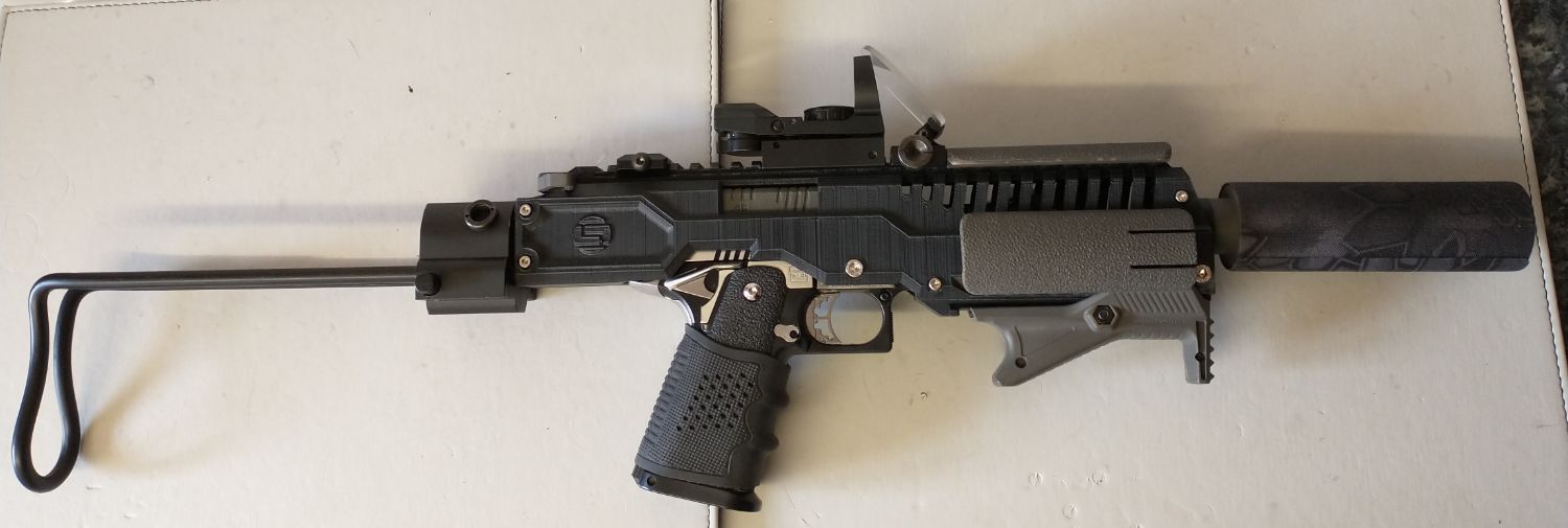

I have the 4.3 but I find it easier to get 5.1 parts such slide and sights when looking.
I placed mine in carbine kit anyways and it works for 4.3 and 5.1 with an adpater for the bottom part if using 5.1.

I mean, if you want an SMG, just get an SMG. Why buy a pistol and negate all its design benefits?
