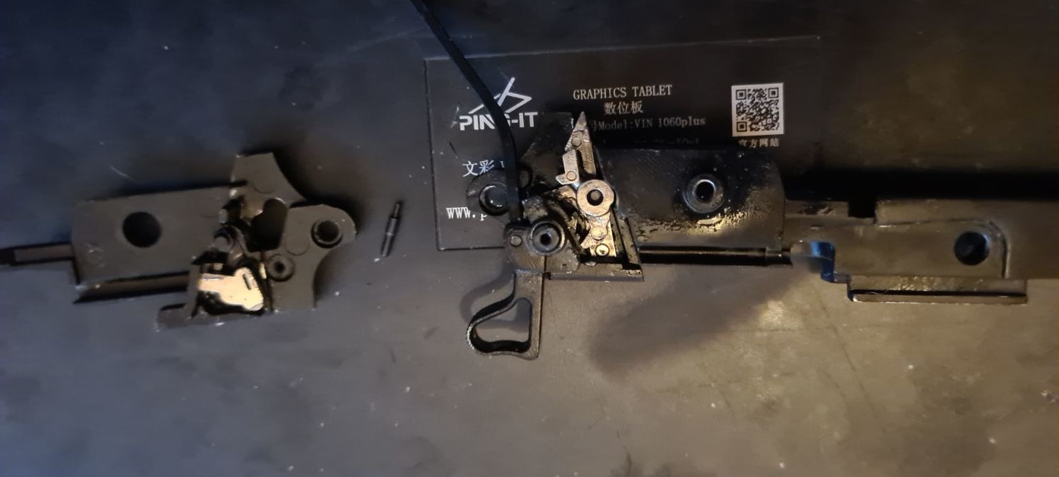

havent cleaned it yet as when taking apart that pin came out but didnt see where from so before i go any furthere where about does that pin go in the hammer set up?
definatly spoil the fun haha lol
The pin in the middle?
Looks like the detent for the safety- theres the bar on the side of the frame with 2 detents and a spring, the front detent puts tension on the slide catch the rear one (which normally escapes) puts tension on the safety.

That pin is out of the tube left side of frame between the safety lever and the slide stop lever. It's the slide catch detent pin. It's shaped like that to stop it coming out of the front of the tube when you remove the catch for strip down.
so theres 2 pins on the safety? as i have the spring loaded one already removed *yeah hunting for the spring was a bitch*
The tube has 2 pins and 1 spring that pushes between them.
The front pin normally doesnt come out on its own but the spring and rear pin jump out the moment you pull the safety out.

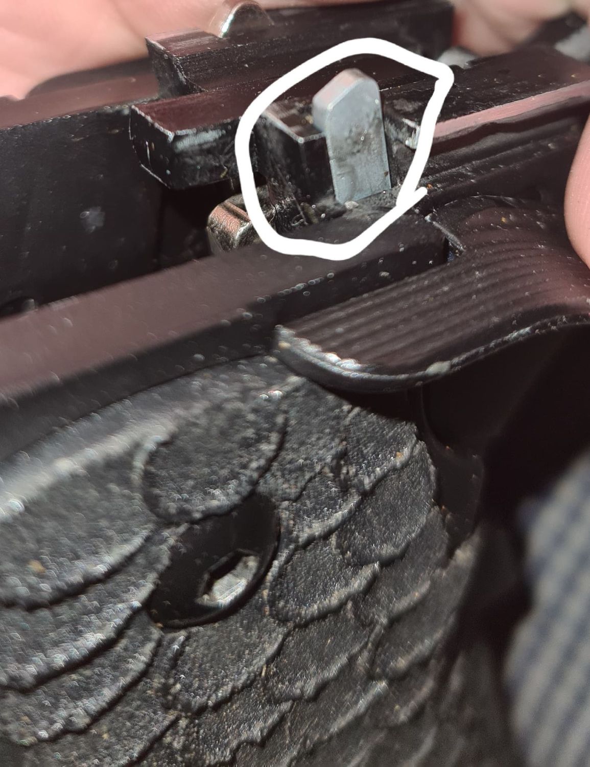

forgot to mention the other day i noticed that part doesnt seem right in my opinion i know the slide pushs it down but dont think it catchs properly which in turn the strikers not going in fully
@Adolf Hamster @Alimcd
should be easy enough to check, drop the hammer than lock the slide back and look to see if the knocker is resetting.
that wouldn't give low fps though, just mag venting.

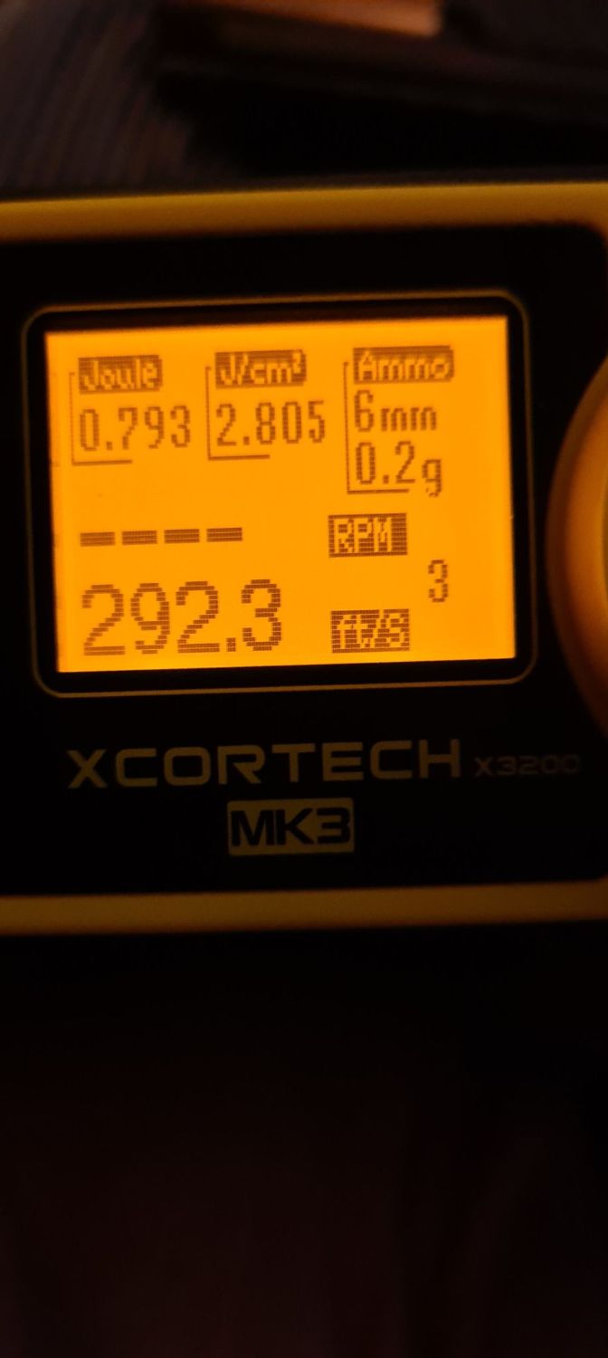

erm ive made a complete and utter feck up...the pistol was never low fps my fecking chrono was set to m/s instead of fps only figured it out cause step son wanted to do his lol and his came up at 80 odd was like hold on cant be right,tried my shotty through it 44 the noticed was on ms lol achwell got spare parts for when she does go
was in a warm housee bud so mags were upto decent temp but was my own fecking fault lol

haha, was not expecting that one, no wonder nothing helped.....
at least the work isn't wasted, a learning experience is always good. guess that means the original nozzle maybe was good after all so now you've got spares.
