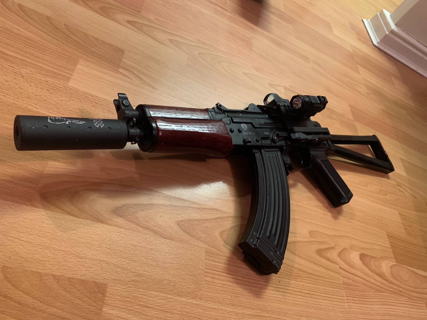

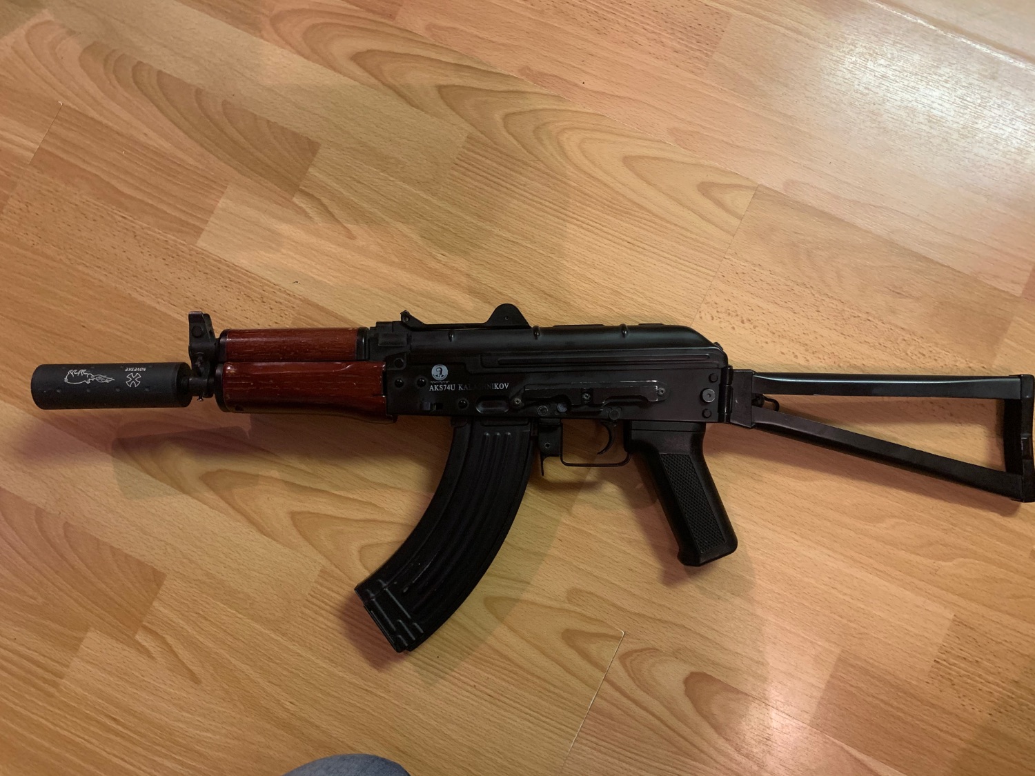

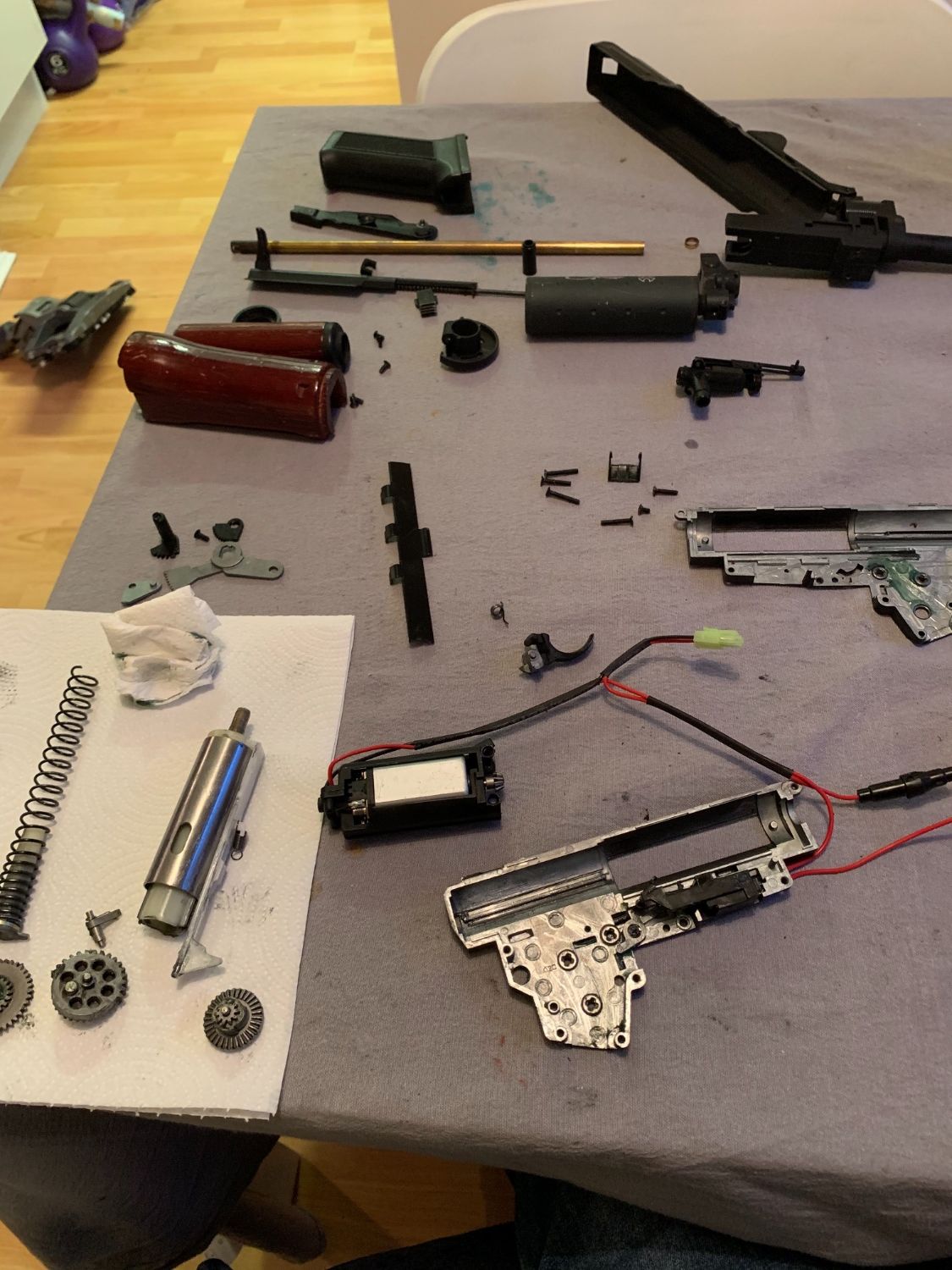

So my first rif (2nd hand) arrived this morning. It’s a Cybergun ak47u.
As it was a few years old and the previous owner hadn’t opened it for a few years I thought I’d give it a bash, well that was a learning curve! (The trigger spring and reverse latch! What little bastards!)
It was definitely worth stripping down, compression was non-existent, cylinder head was ok but piston seal was so loose it had no chance of sealing. Replaced and all good. it had obviously had work in the past, it was shimmed well and needed no adjustment there, but the bushes need to be replaced. Also all the wiring has been soldered at the motor and trigger which made working on it slightly more of a pain (will replace all cables and install mosfet soon).
The spring could also do with being replaced and bearing guide fitted. Exiting spring has a pretty poor cut job on it.
Cleaned lubed and rebuilt. Had a bit of a faff with the trigger but got there eventually. Had an issue then with not being able to select semi, cause found to be bad position of wire when I rebuilt it, adjusted and now all good.
Now waiting on payday to get some replacement parts ordered and then just the wait to get to use it! :)

Will do, I will update this thread as I upgrade it. Hopefully everything goes well! Did think at one point today wtf have I done! But all good in the end.

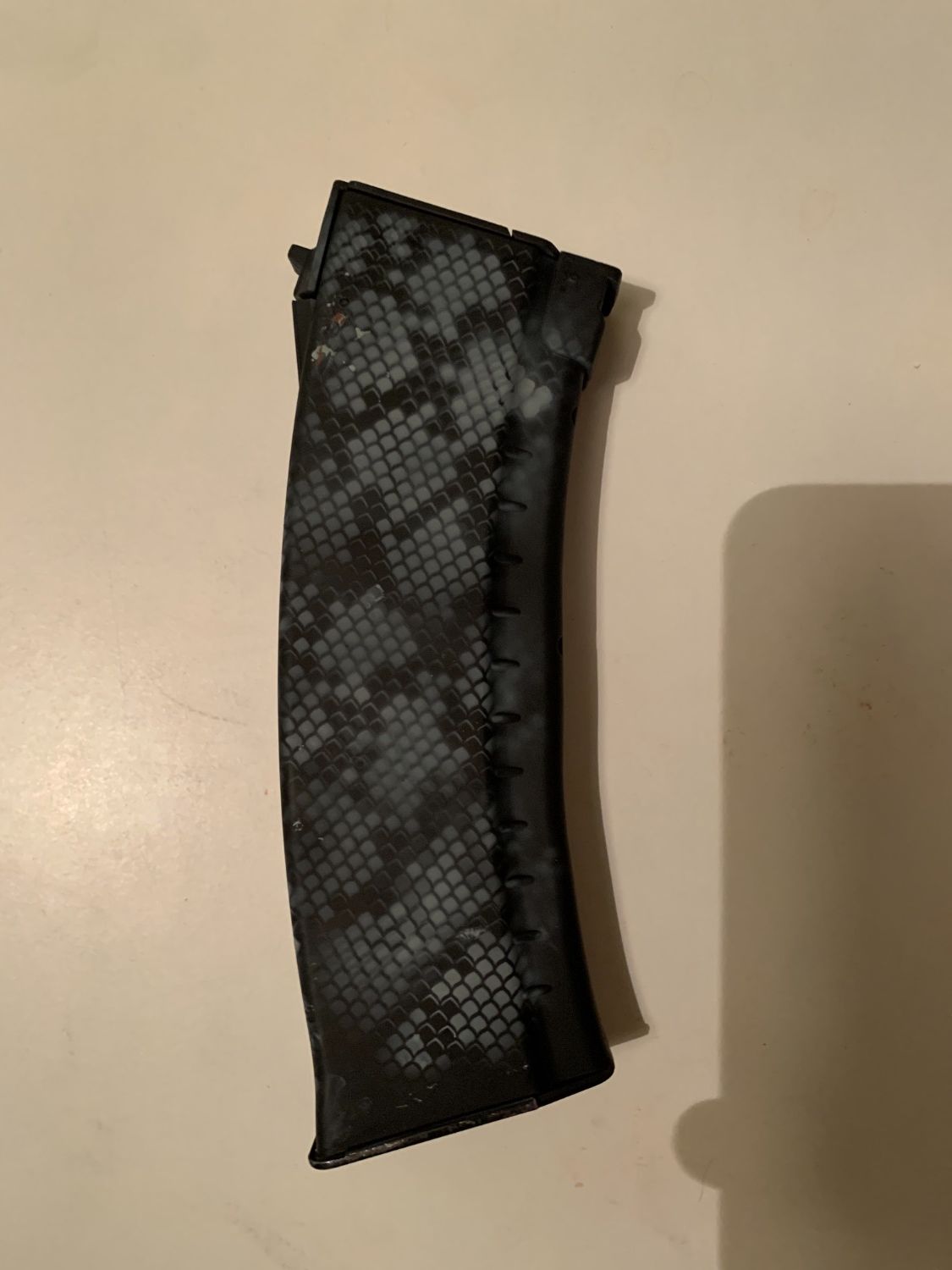

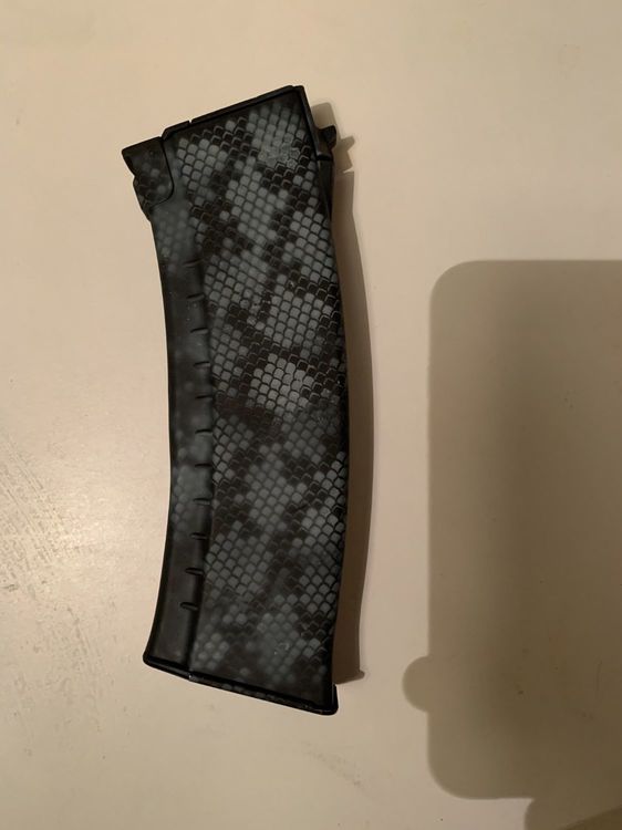

had a quick spray up of the orange mag, not a neat job just a quick one to see if I like the look. What does everyone think? I think it’s better than the orange but the grey needs to be darker/softer in my opinion. Also it doesn’t match the ak at the moment as it clashes with the wood guards. Will look better once they get swapped out.

Yea, if the orange was the same tone as the hand guard I probably would have left it, but it was a horrible tacky orange. This one is far from perfect but I think it’s still an improvement on the orange that was.

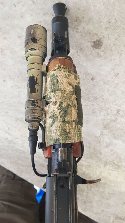

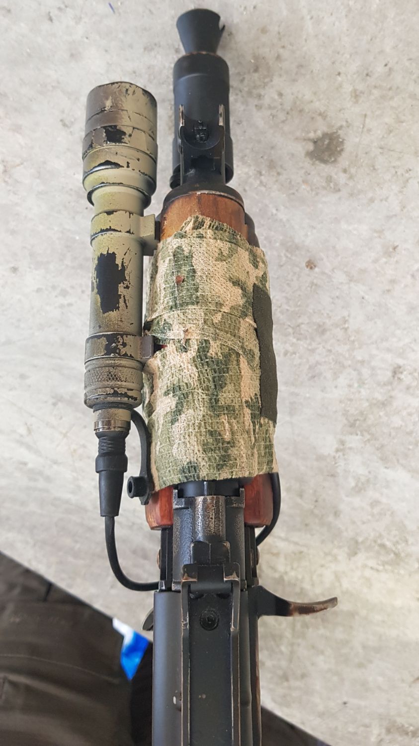

I have built one up last summer with a Gate NanoHARD, improved sealing (air nozzle, o-ring, bucking and nub) and a Madbull barrel. Cracking little gun that with the weathered paint and wood looks pretty unassuming. I have just done a mod I saw in the wild a few years back, basically take a Scout light, remove the RIS mount and bolt directly through some holes you drill in the upper hand guard! Seems that lack of tactical fore end didn't stop the local guys trying to get all tacticool like the US and Brits they were working along side ?
ahh the greatest spirit of the ak, if it don't fit imma make it fit :P

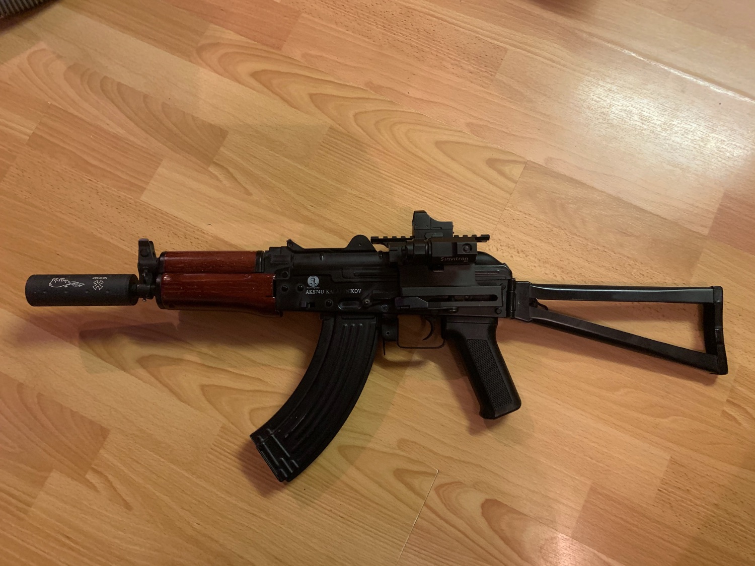

tbh i'm currently hunting for a way to get a wee stub of rail mounted between the gas block and barrel so i can get me 2dp side-mounted there and can go back to the original handguard.
short RIS rail section and two wood screws ?
dont wanna go drilling into the wood.

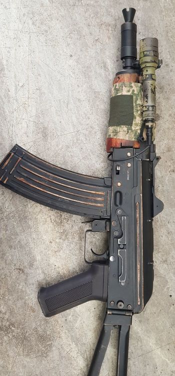

really hard to find a pic of what i'm meaning but something like the laser positioning of these:
